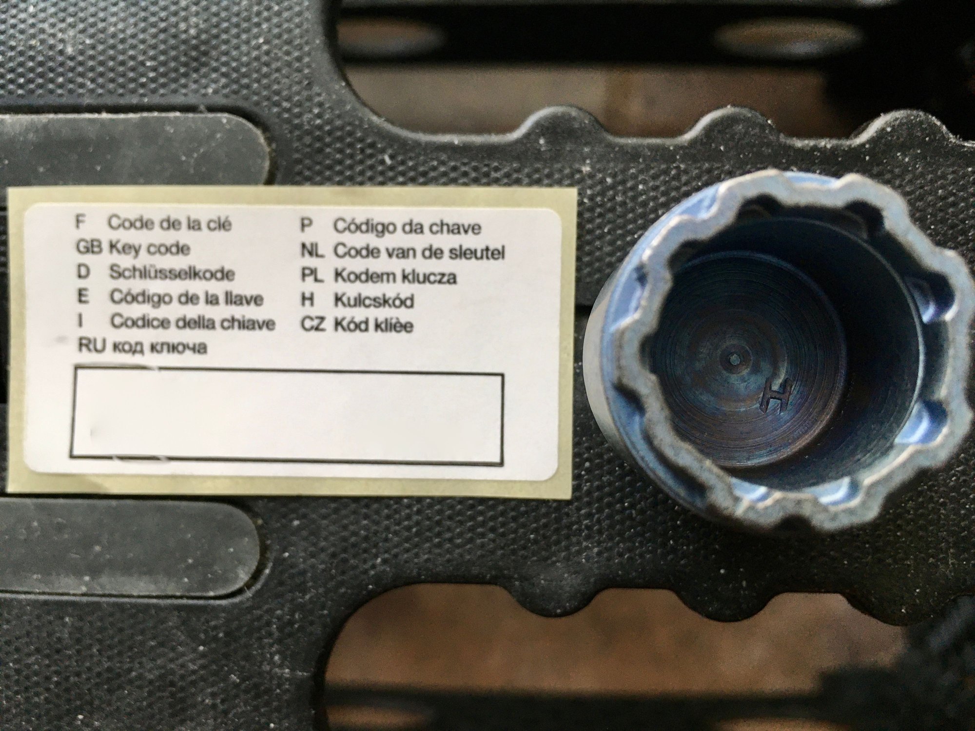

Yes there should be a "key" similar to the picture below. With V167/X167, Mercedes is using Farad's Galaxy wheel locks (instead of Farad's Starlocks it has always used before). Galaxy is significantly more difficult to defeat (that is until duplicate keys will start circling around on the internet the same way as Mercedes' Starlock keys are).
