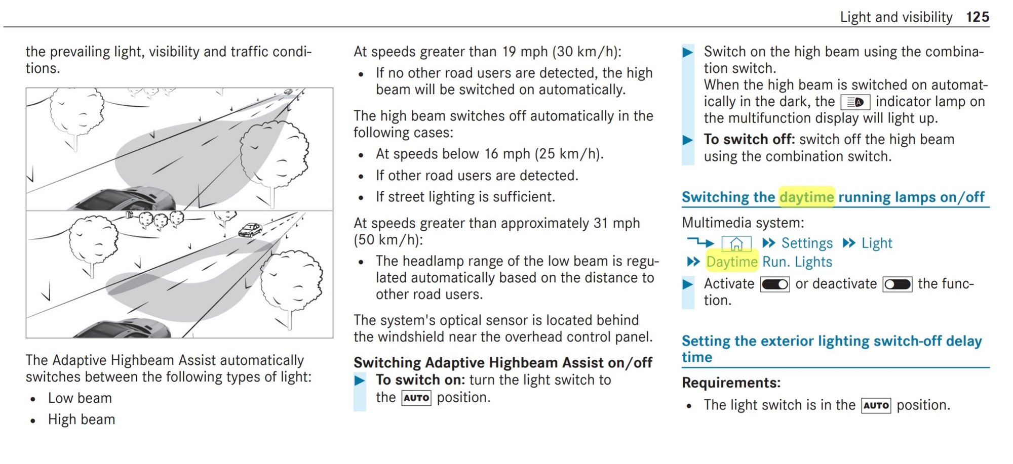

Would I be correct in believing that the daytime running lights should be enabled? I was just playing around with the exterior lighting / surround lighting features in order to enable the logo projector and noticed that my DRLs were not enabled. If there is any other useful information you can pass along regarding all lighting options/features it would be helpful. Thanks

I can't remember exactly where but the option to turn or or off the DRL is in the MBUX, probably under vehicle settings.

Correct.
Here’s the reference:
