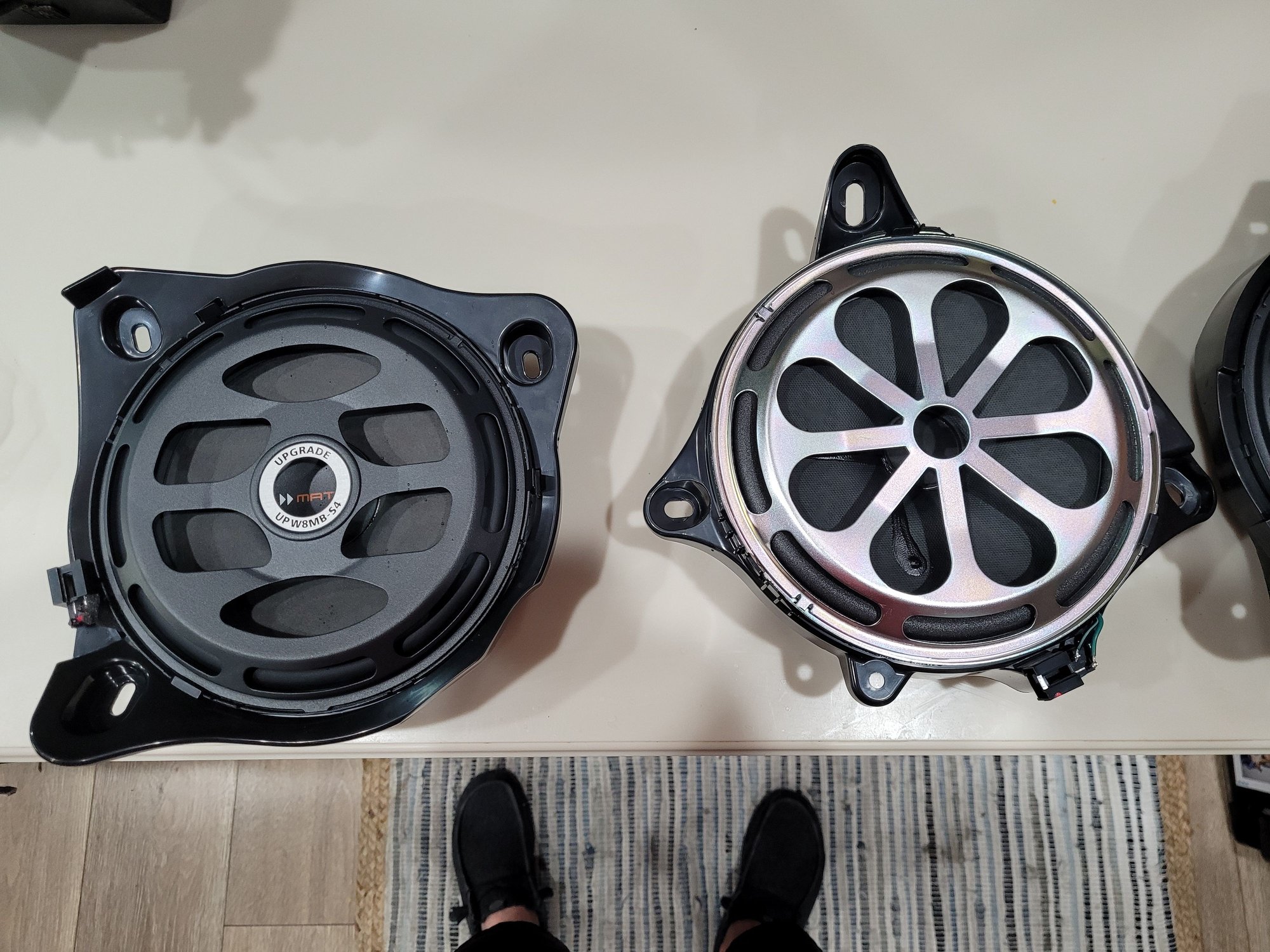

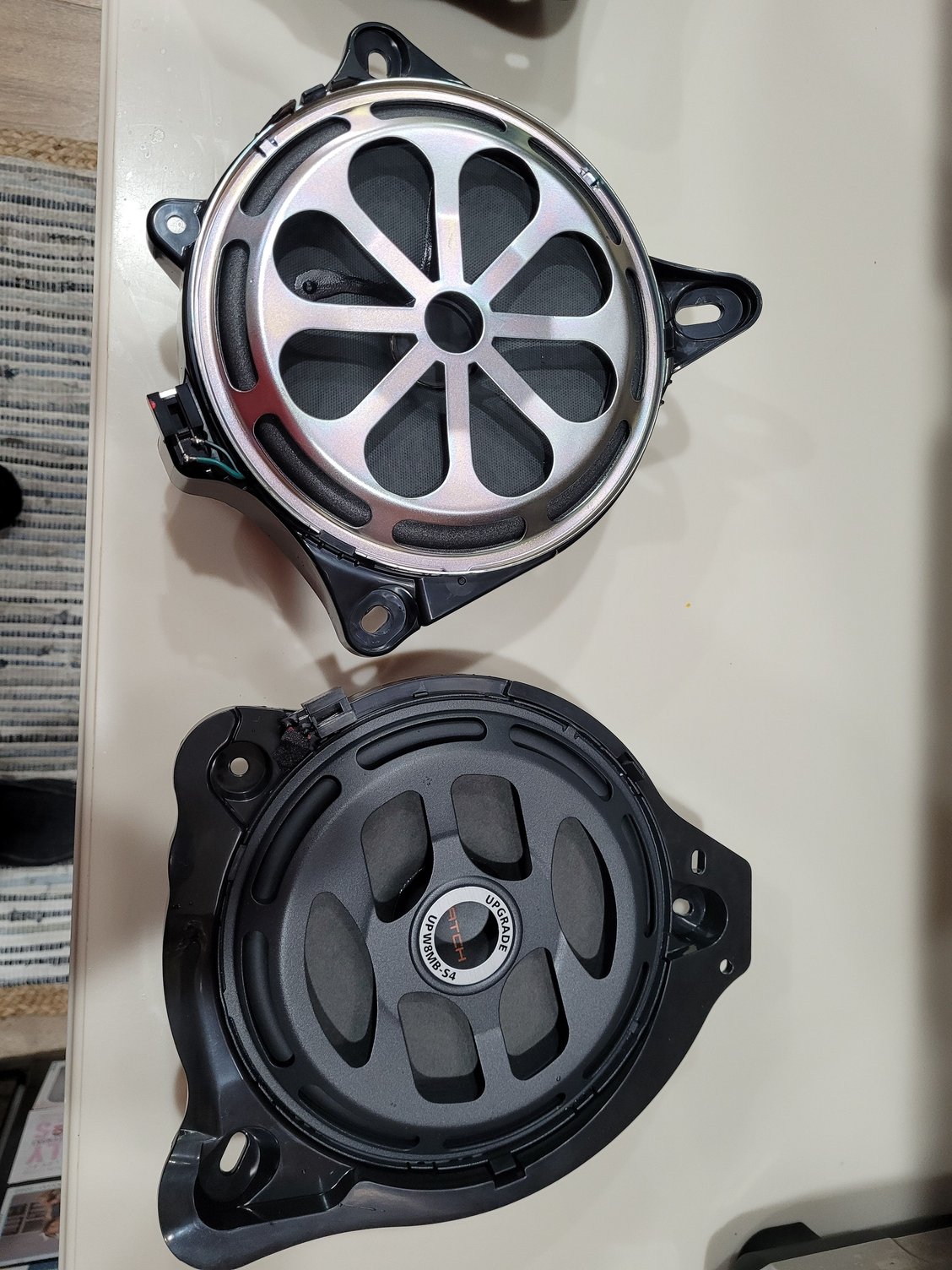

Unfortunately the UP W8MB-S4 that I got from Crutchfield does NOT fit a 2024 GLE 450 with the 13 speaker system. No matter how I tried to line up the three mounting holes on BOTH speakers they just would not fit. One was was closer than the other 2 ways but even if I modified the bracket, I wasn't sure it would sit flush.
The only option I can think of right now was to physically try and swap the speakers into the old brackets. But I don't want to do that, have it not work, then not be able to return them. It's a $800 gamble.

I think you didn't buy the correct subwoofer model for your GLE.
This the W8MB-S4, listed for Mercedes.
https://www.audiotec-fischer.de/en/m...up-w8mb-s4-lhd
This is the one that would fit the GLE V167, W8MB-S4.2.
https://www.audiotec-fischer.de/en/m...rs/up-w8mb-s42
