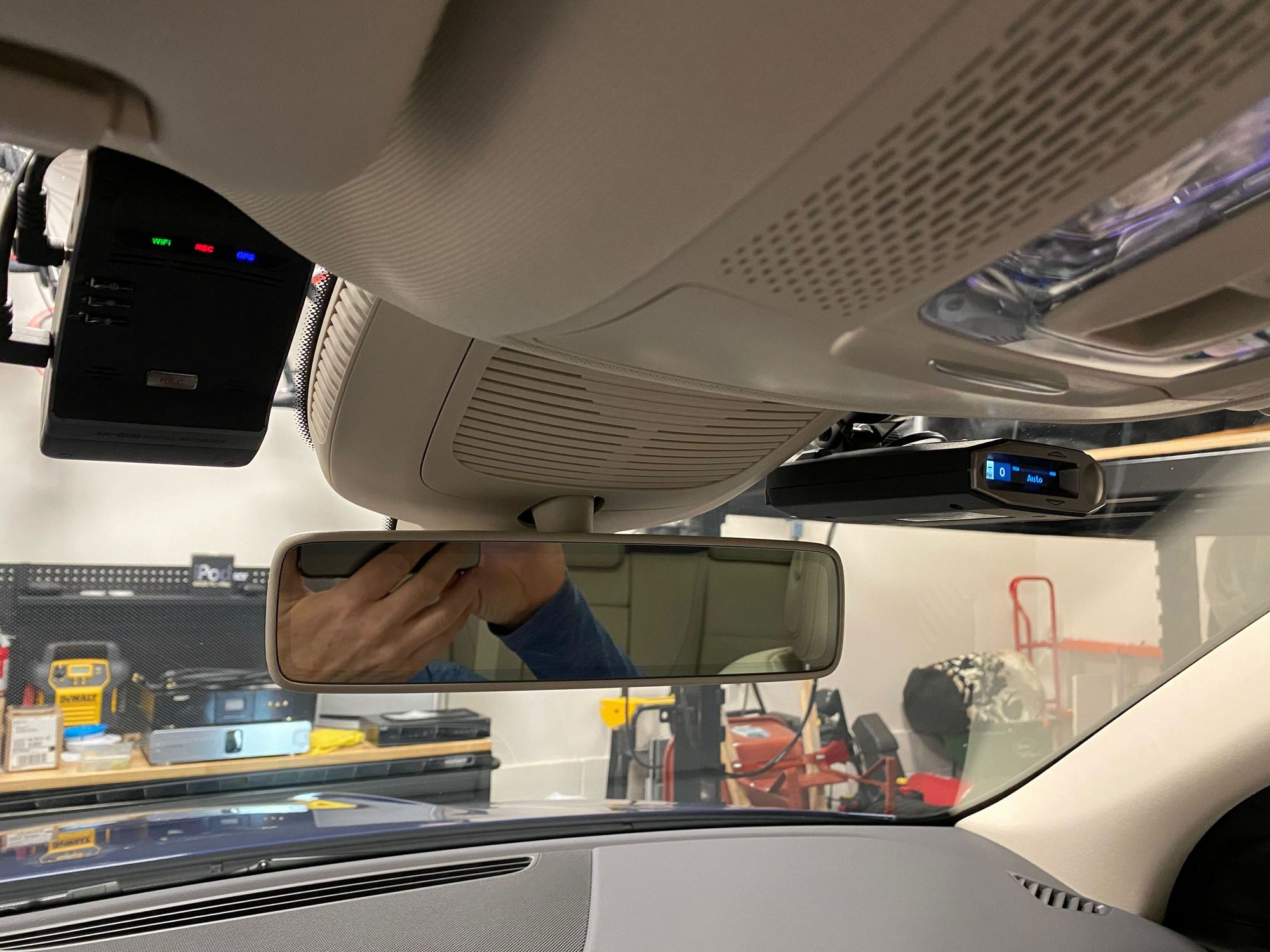

We have dashcam's in all our cars. Good peace of mind for a variety of reasons mentioned. If vandalism while parking is a risk, there is an extended battery that can run the dashcam for days without using the cars battery.
That garage is too neat and clean!
Old Jul 26, 2022 | 05:54 PM
Wolfman's Avatar
Super Moderator
Joined: May 2002
Posts: 10,556
Likes: 3,680
From: Land of 10,000 lakes
Question
It was even cleaner once Nice having a lift...

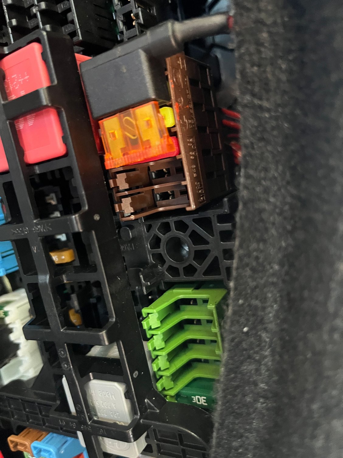

Old Jul 26, 2022 | 07:41 PM
de31p5's Avatar
Joined: Mar 2022
Posts: 65
Likes: 34
GLE53
Unfortunately not what you're asking for as far as the one in the rear view, but I thought this might help others. Just ran outside and snapped these, this is what I did for my dashcam, one is constant 12V the other is switched. I have my dashcam with park mode enabled and has been good for a few months now. (Don't ask me which is which, I don't remember and don't have my meter on me)
Of course, double check your fuse terminals yourself to verify, I'm just some random guy on the internet, so you should trust me as much as a frayed rope bridge supported at one end by a dog who thinks it's a game of tug of war.

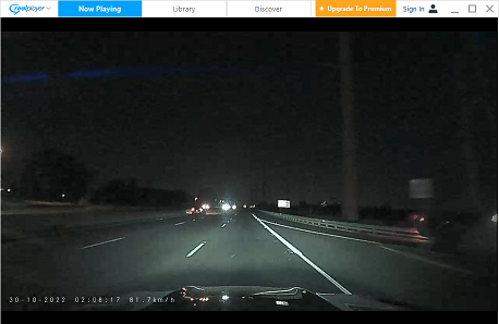

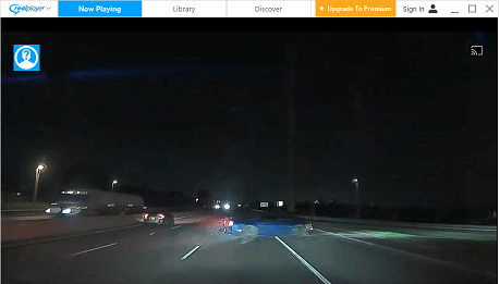

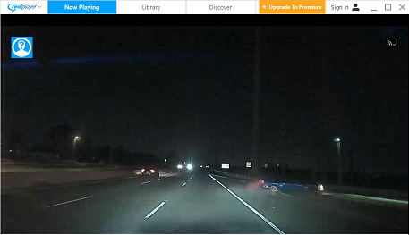

Old Oct 31, 2022 | 08:41 AM
TonyF61's Avatar
Joined: Mar 2022
Posts: 556
Likes: 197
From: NJ
2022 GLE 450
Originally Posted by Frenetic
Dash cams are worth it for one thing in my opinion: red-light runners. It’s really hard to prove these cases without video evidence, and even 1080p is usually enough to prove it one way or another. However, most newer, higher-quality dash cams are either 2k or 4k, which is more than sufficient for what it’s needed for. Unless it’s a hit and run, there usually isn’t an issue not clearly seeing the license plate; seeing a general description and color of the other vehicle is usually enough.
Though narrowly missed, dash cam would have been useful with insurance claim, had it been necessary.
