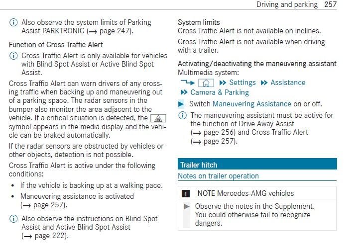

I am shopping for GLE 53 coupe and it is bit confusing to know which package I should choose if I need the rear cross traffic alert.
The standard feature includes PARKTRONIC with Active Parking Assist and the definition says (no mention of rear cross traffic alert):
Active Parking Assist can search for suitable parallel or perpendicular parking spaces to either side as you drive by. Choose a space to pull or back into, and it can expertly shift, steer and brake for you. When it's time to leave, it can also steer you back out. In any low-speed maneuver, PARKTRONIC sensors in the front and rear bumpers help detect nearby objects within their field of view. Audible signals and illuminated displays in the cabin help you navigate tight spaces with confidence.
The Driver Assistance Package PLUS package has Active Brake Assist with Cross-Traffic Function but the definition only mentions front cross traffic:
At certain in-town driving speeds, radar and advanced cameras can scan the area ahead of the vehicle to help detect a potential collision with vehicles approaching or crossing from either side of an intersection ahead, or with a pedestrian in the car's path. When the driver responds to the system's alert by braking, it can precisely apply brake force to help prevent such an accident or help reduce its severity. If it senses that a pedestrian has entered in your path, the system can automatically apply the brakes.
I don't seem to find "DA3 Parking Assistance Package" anymore in the build configurator online. In one of the window stickers of a GLE Coupe in a nearby dealers lot, I saw this DA3 option but it only mentioned about surround view camera system.
Can someone please help?

I am sorry that you haven't heard about rear cross traffic alert system (RCTA in short). This is available in most of the entry level cars as standard for last few years (including Toyota, Kia etc). More about RCTA
I do not plan to drive backward but I do pull backward from parking space and RCTA is always handy in my current Lexus which makes audible sound when there are cars or pedestrians crossing behind my car. It even stops the car if it detects a collision. Very useful in tight parking lots especially in schools, strip malls, underground parking structures.
I can't find this in GLE. Audi and BMW clearly note this feature in their window sticker.
Has anyone used this?

Cross Traffic Alert is part of Blind Spot Assist. If you have Blind Spot Assist, which as far as I know is standard in the USA, then you have Cross Traffic Alert.
Ye, Cross Traffic Alert is standard, or at least it was on the '21's. The car will alert you if backing into cross traffic. Active Cross Traffic Alert was part of the Driver Assistance Package. With this feature the car will brake automatically if you disregard the audible alert.

Thanks everyone. This is very helpful. I was able to download the online manual for GLE and able to confirm that the standard blind spot indeed comes with rear cross traffic alert. Thank you!

Except it uses the radar sensors in the rear bumper that are also used for Blind Spot Assist. The parking sensors are ultrasonic and have a very short range, and the frequency is too low to pick up approaching vehicles.
