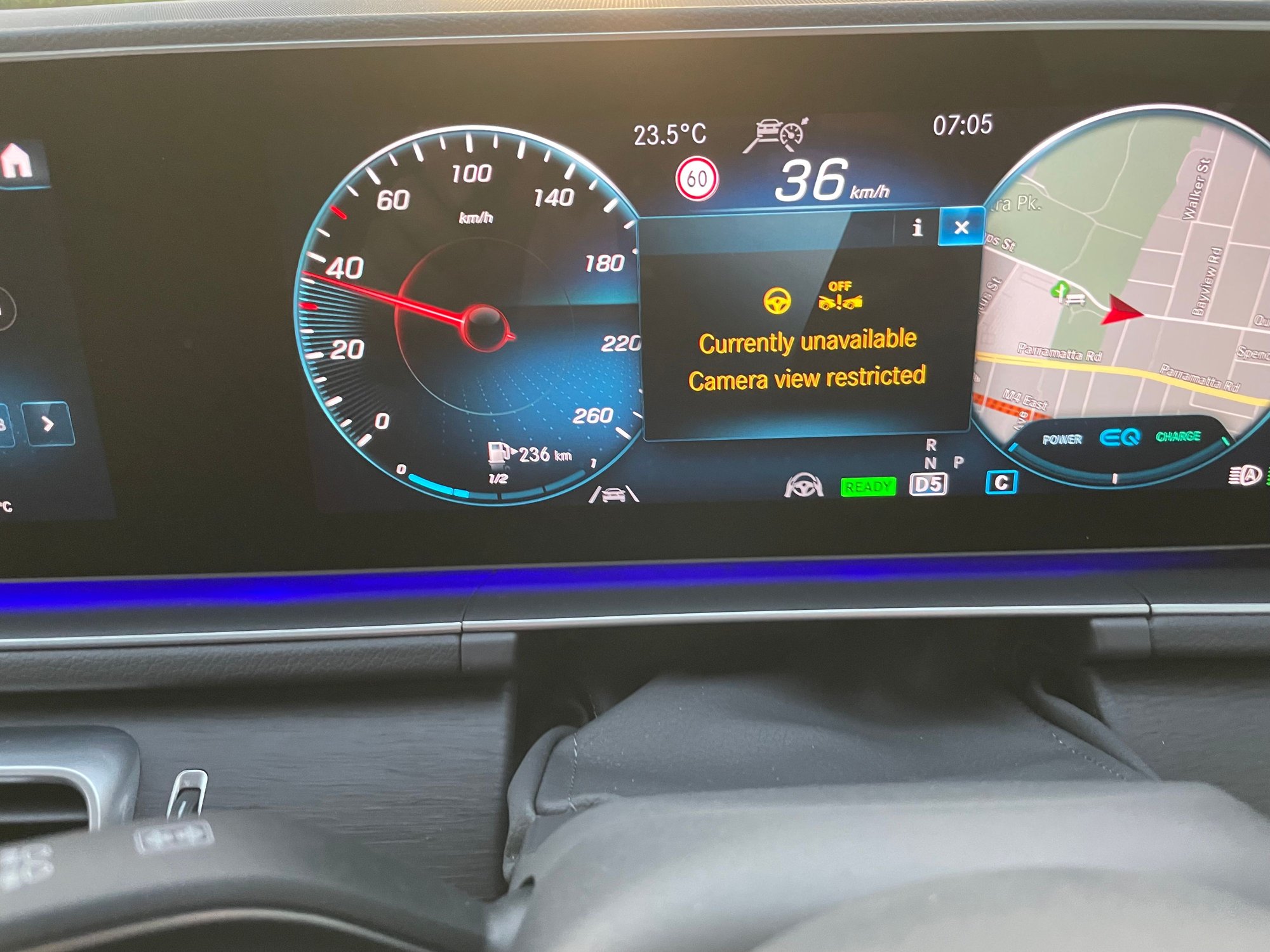

Long story short, I noticed I was getting the dreaded “Camera view restricted” errors. I read on this forum (many thanks guys!) that it could be the cameras are dirty or clouded. I booked it into the dealer to check the issue under warranty. They confirmed there was an issue with the “camera lens hood” and that they replaced it with an updated part number (1678275100). They also cleaned the windscreen area in front of the cameras because they were cloudy.
This did make a difference. I actually experienced the E-Active suspension working for the first time since I bought the vehicle, and it was amazing. The suspension picks itself up to keep the vehicle flat when going over bumps. It never gets old. Very comfortable. I’ve even noticed on uneven road surfaces that it seems to be doing something to minimise bumps/rolls.
Now, although the dealer had fixed this issue, and I was happy to finally be experiencing the E-Active suspension, I did notice that it was only working maybe 40% of the time over speed bumps. I remember some posts on this forum saying that people had also cleaned the camera lens because they can also get cloudy (in addition to the windscreen). I didn’t recall the dealer saying anything about them cleaning the camera lens, only the replacing the “lens hood” and cleaning the windscreen. So I went about dismantling the cover above the rear view mirror to access the camera module. It was a little tricky, but managed to do it without breaking anything and also removed the camera module by releasing 3 metal clips. Guess what I found… the camera lens on both cameras were cloudy. I cleaned them carefully with glass cleaner and a cotton bud. Now the E-Active suspension works 100%. Im a little disappointed the dealer didn’t do this originally, but Im happy its all working perfectly now.
In my gated community where I live, I drive over at least 5 speed bumps everyday morning. It’s still amazing to me that I can drive over them and dont notice them at all. Everyone else has to slow down and take them easy.

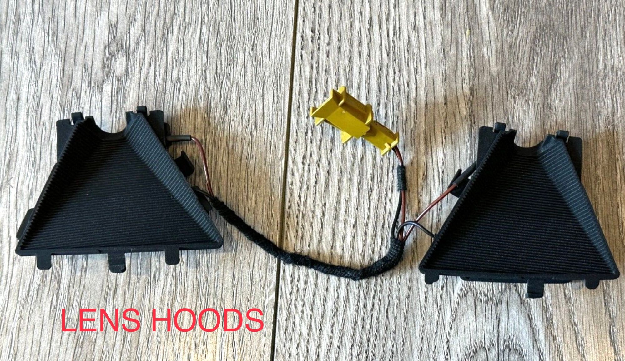

​​​​​​ So I went about dismantling the cover above the rear view mirror to access the camera module. It was a little tricky, but managed to do it without breaking anything and also removed the camera module by releasing 3 metal clips. Guess what I found… the camera lens on both cameras were cloudy. I cleaned them carefully with glass cleaner and a cotton bud. Now the E-Active suspension works 100%. Im a little disappointed the dealer didn’t do this originally, but Im happy its all working perfectly now.
That's good to know. Can you provide some steps and guidance on accessing the camera? It would be nice to be able to service it myself in the future.
Also, is there anything different about the new part # for the hood?
Sure. I followed the instructions in a YouTube video one of the members posted on this forum (see below). I believe the newer lens hood part number improves the heater element that is attached under the hood lens covers (to prevent windscreen/camera fogging up). The old ones could burn out or smoke or something, making the glass and cameras cloudy.

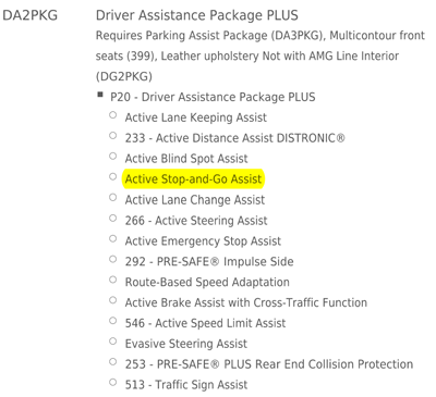

Originally Posted by GregW / Oregon
I followed this vehicle a year or so in advance of launch, because I've had the first of each model since 1998. Typically at launch those of us on the forums know more than the sales guys, so I can't fault the dealer necessarily. I fault the ordering system including the DOG and NetStar. I'm going to see if my service manager will look into whether just the stereo cameras could be retrofitted to make this functional.
Be thankful you have a (mostly) functioning rare vehicle.

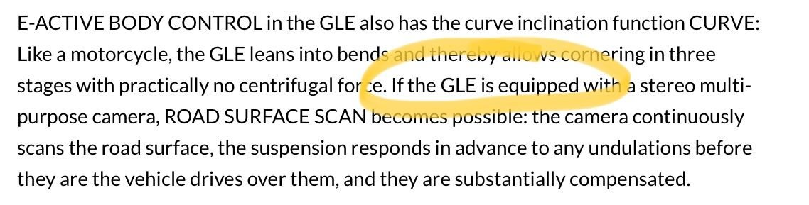

​​​​​​The highlight in the screenshot above is covering a key sentence "comprised of the following functions and components. Greg, you must have those stereo cameras since it's part of the E-ABC. They can't sell you E-ABC without it.
Hi Wildta, sadly you could/can get the E-Active suspension without stereo cameras (driver assistant package). If you have the single camera, you don’t have the road surface scan feature. This is mentioned a few times on other documents.
The below is from one of the early press releases in late 2018. See below, emphasis on “If” the GLE is equipped with stereo multipurpose camera…

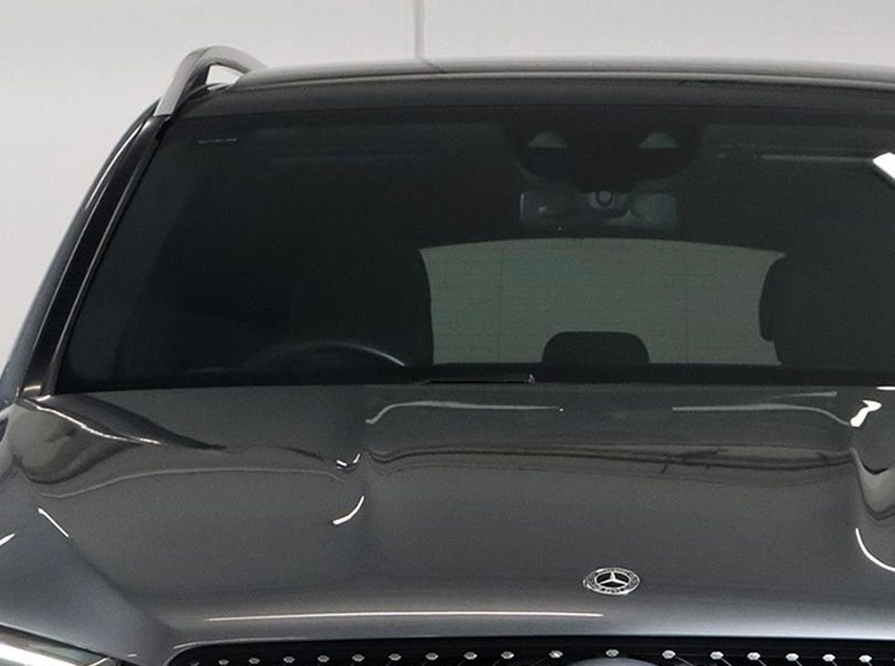

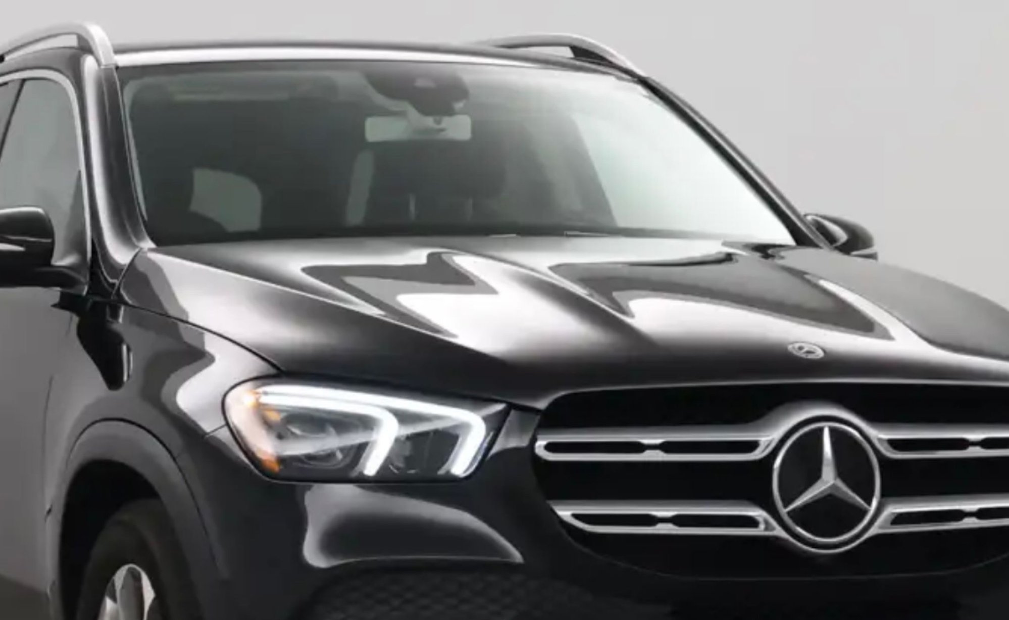

Just looking at Greg's sig pic it looks like he has two cameras. Its pretty small, but it looks like the car in that pic has both of them.

E-ABC stereo cameras
Originally Posted by MB_downunder
Single camera vs Stereo (dual) camera should be very easy to decipher -
No, looking closer the left one is blanked off. Build date on my car is 4/7/19.

OK, I just checked my car and I really am in the same boat as Greg, despite having the DAP package in addition to e-ABC... October 2019 build. Single camera in the dual camera housing, which would explain why I never felt like the Road Surface Scan feature was doing anything. That was the primary reason for getting e-ABC, as the bounce (recovery) mode and individual wheel control are mostly gimmicks unless I want to climb boulders.
Does anyone have evidence/details for why the stereo camera is important and should have been included? Is my DAP not as 'good' as a real DAP with stereo cameras? I'll take any information to my GM and see what he says, though I'm afraid I'll get the same response as Greg. Definitely annoying and also affects resale value since a $8,200 option isn't doing much on top of the regular air suspension.
Old May 6, 2023 | 03:04 PM
GregW / Oregon's Avatar
Posts: 6,772
Likes: 1,265
From: Lake Oswego, OR
2020 GLE 450; 2023 BMW M2 Coupe
Neutered E-ABC system
Since you're still under warranty you may have some recourse. The DAP+ is supposed to include the stereo cameras which the E-ABC system needs for Road Surface Scan. There is no other package that could provide the stereo cameras. Does your system do the following (from the 2018 press release) which is listed in the order guide as part of the DA2 package?
I'm not sure what the recourse would be, but Mercedes owes you the full function of what you paid for. Perhaps you have all the software needed but the single camera got installed by mistake (not unlikely). In my case, I'm SOL because the need for the second package was just not clearly spelled out. Best of luck and keep us apprised!

Originally Posted by BenjaminKohl
No, just curious if it's an early build/pre pro car which a lot of the e-abc cars are or not but no pressure.
My build date is 2020-01-19.
Here are various pics of my cameras if anyone is curious. I took close-up pics to see if my lenses were clouded but they appear clean to me. Just to note, the camera shrouds are black but my flash really distorts the color. Also, any idea what the little circle is below the stereo cameras?
Also, sorry Greg and maalox regarding your E-ABC situations. I would be in a fit with my dealer.
