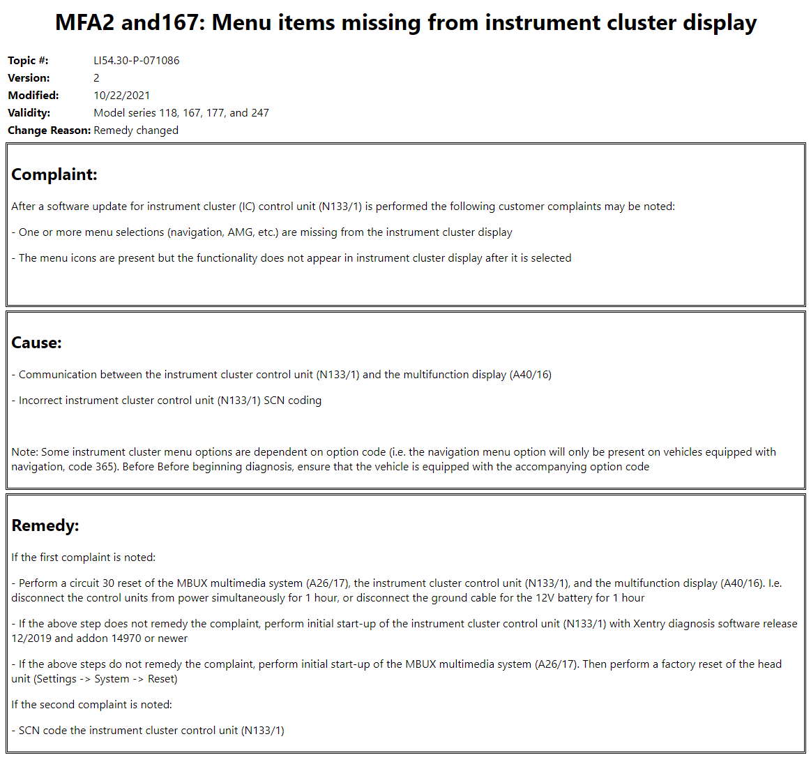

If you had this functionality before and now you don't, this might be why:
