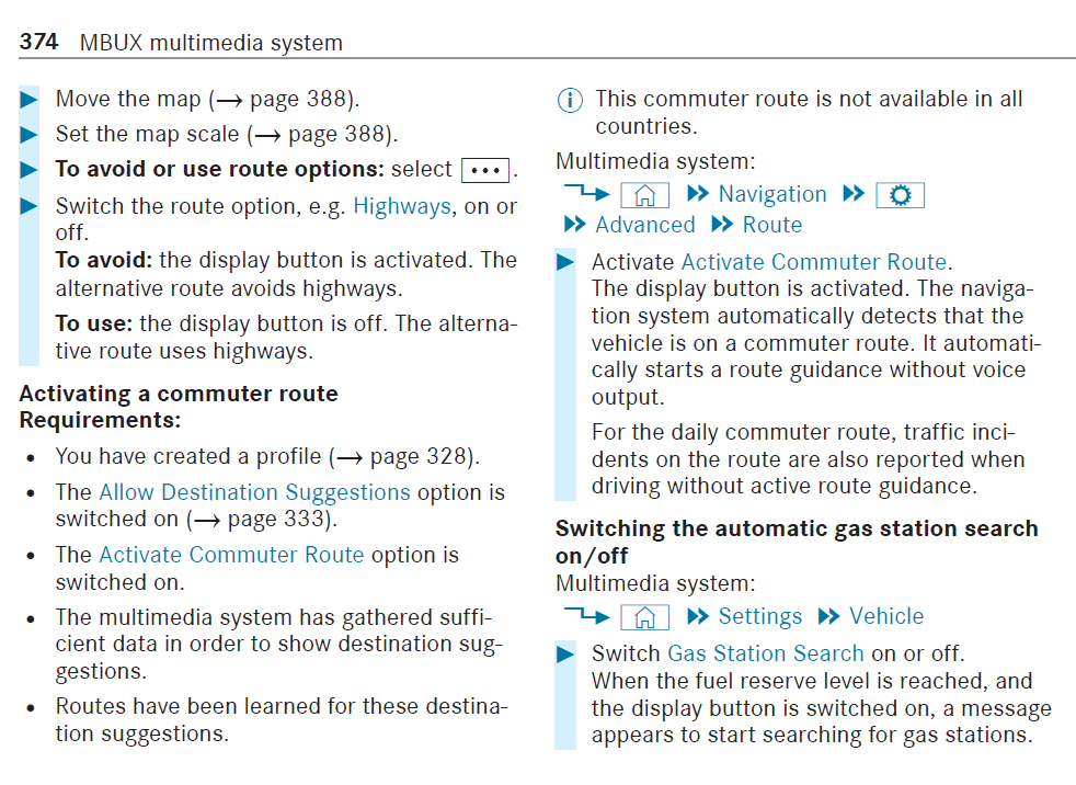

Was wondering why all of a sudden, whenever I start my car away from home the navigation system has my HOME location routed on the map all the time. Never noticed this before. Is this something new? Can I stop it from happening?

This is the commuter route feature, once enabled, it will learn your driving pattern, and automatically set the navigation to that location (but with voice disabled)
