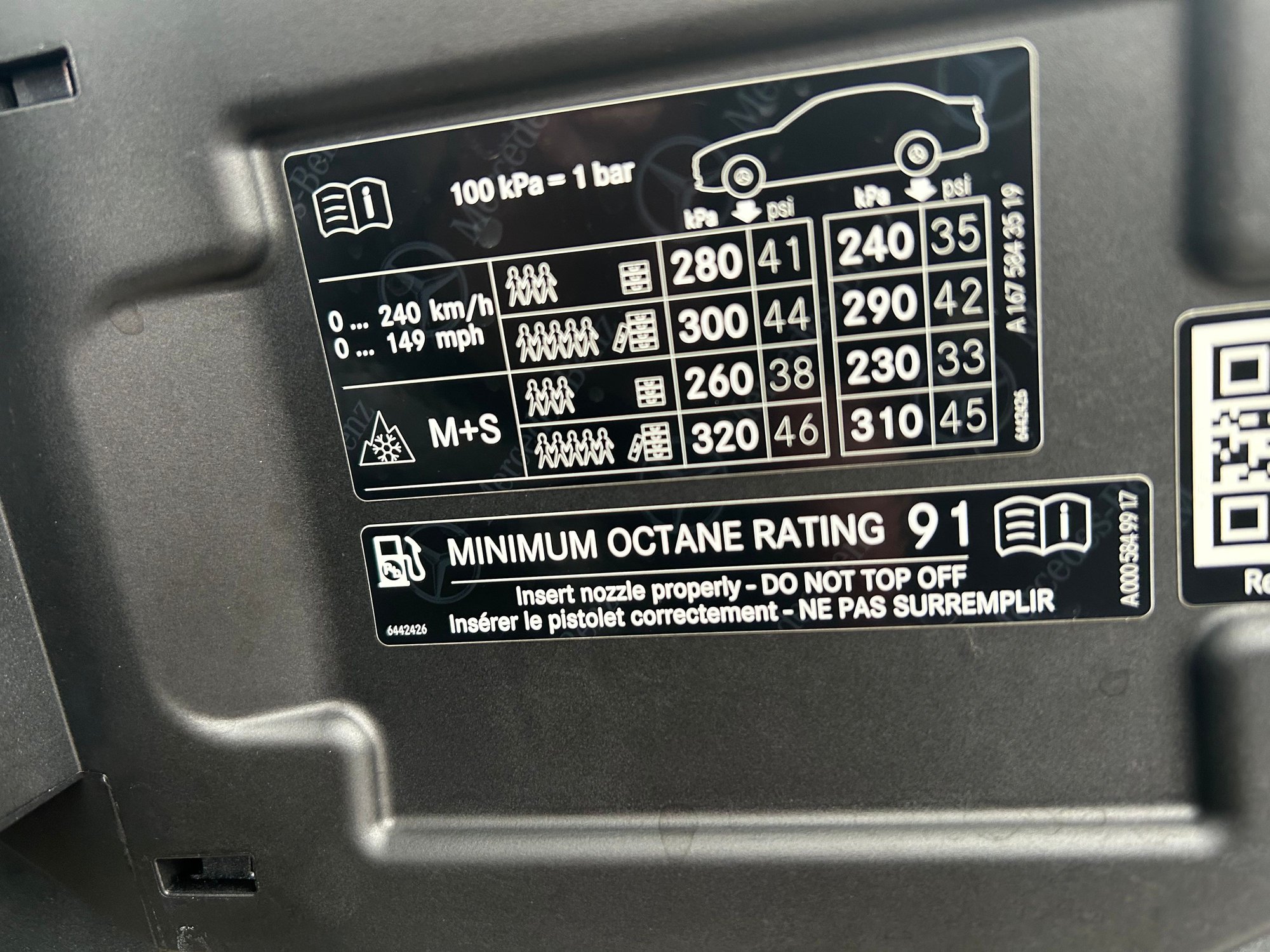

Back to original topic: when I took delivery of my 24 GLE53 last year, tire pressures by dealer were set according to high performance tire standards and the ride was very harsh, so much so that my wife complained that “this thing rides like a truck”! Ugh- $95,000 and she doesn’t like it!
Then I noticed values on gas flapper door for M+S tires (which I have) and I lowered pressure to M+S standards as listed (per above photo). Voila, the ride was much less hash and steering seemed to be better as well. As usual YMMV.

Originally Posted by jonpom
I find it unusual that my 24 GLE53 filler flap door indicates 5 lbs more for fronts than rears per my M+S tires.
I find it unusual that my 24 GLE53 filler flap door indicates 5 lbs more for fronts than rears.
It's not unusual for front engined cars to need more front pressure.
Mercedes seems to have more rear roll resistance with the 167 chassis than the 166.
It sure handles better, and the recommended pressures are appropriate.

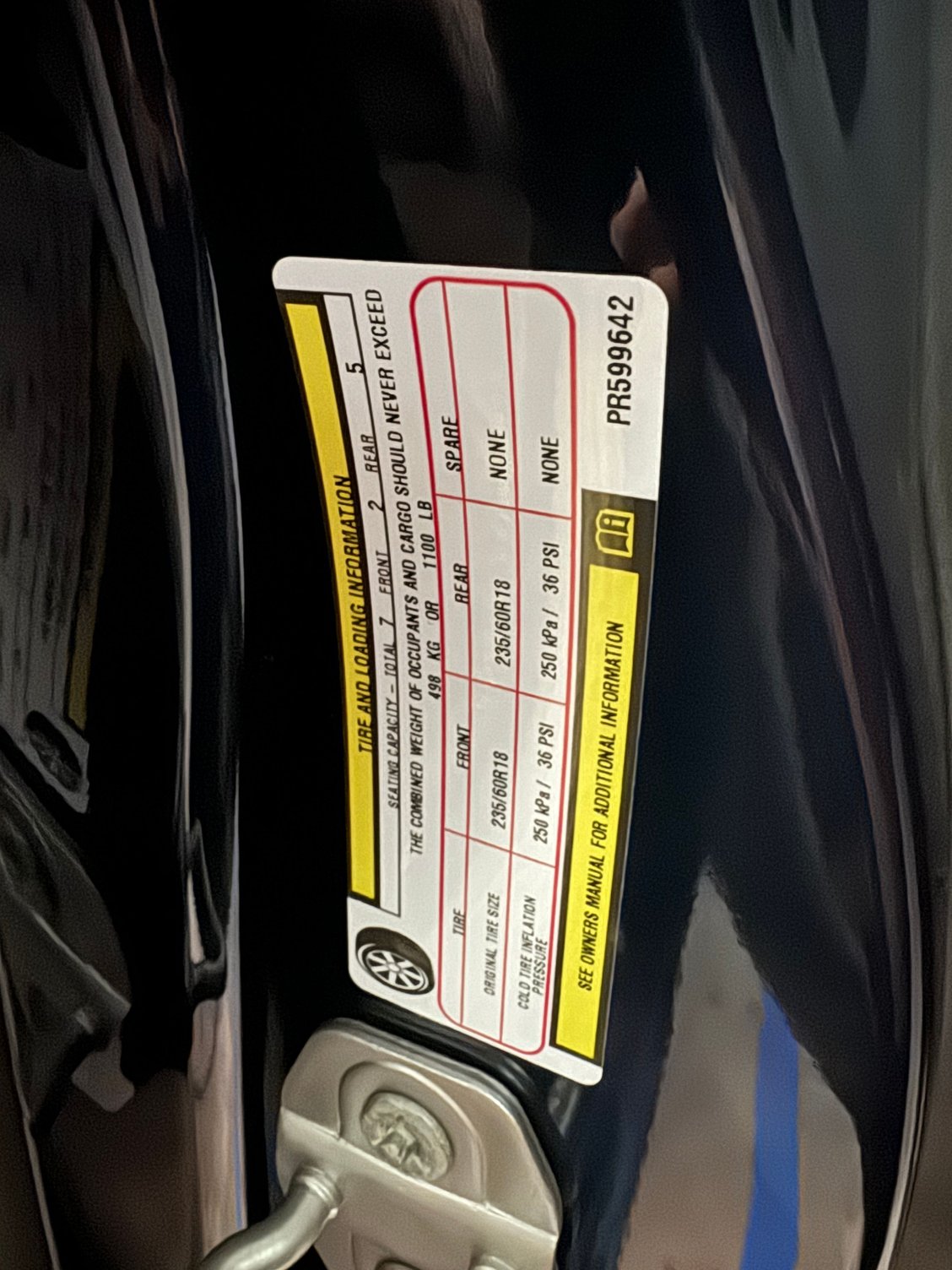

Because information that is presented in the thread is not always accurate. If all auto manufacturers don’t reflect it the same way, then it is obviously not because of federal regulations because those would apply to all manufacturers. That’s logic so that explanation is clearly not the reason. If you don’t know why Mercedes does this, and apparently Porsche, you just have to say that. I don’t know which is why I’m asking if anybody does know.
I’m going to listen to the PMs I’ve gotten and just let you go back to talking to yourself
I think this is interesting so if anybody else has any thoughts or answers as to why MB does I’d love to know. Has anybody else ever had another make of car that displays all these different options for tire pressure?
This is the door placard on my S560:
And on our Pacifica:
Clearly they are the same format sticker, which is obviously federally mandated. But, as you can see the S560's pressures listed there are max pressures, and the pressures listed by Chrysler on the Pacifica are clearly not. Here is the fuel door flap on the S560 showing that they want me to run 35:
So thats my question, why does MB do it this way since its clearly not a federal mandate...it may just be because they want to maximize performance in different load and speed configurations? Meaning they don't want to pigeonhole people into using the max pressures if they aren't fully loaded and driving more than 100 MPH?

The fed regulation is a one size fits all situations tire pressure and is required to be on the door jam. It is a compromise catering to the lowest common denominator. For those who like to extract the maximums (comfort or performance) from their vehicles, tire pressures can be adjusted up or down depending on the load, tire compound, temperature, and intended use. MB Chooses to give their recommendations for this on the gas door. I'm not sure why this seems to be such a complicated concept.
