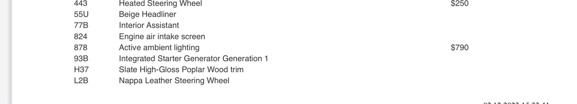

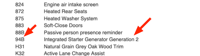

Has someone noticed 2024 GLE 350/450 has 94B "integrated starter generator generation 2", while previous year models have 93B "integrated starter generator"
I didn't see any discussion about them here, and i also didn't find any information about the difference using google search.
Is there any improvement in the 2024 model ?

I checked the build sheets.

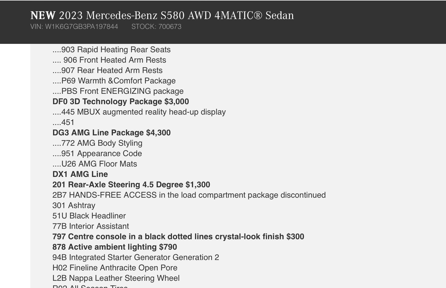

My 2023 S500 has 93B, but the 2023 S580s have the 94B, at least according to this random build sheet.
https://www.mboflehighvalley.com/inv...g7gb3pa197844/

My 2023 450 has 93b, which was built in Mar 2023, the dealer's 2024 450 has 94b which was built in April.
Reliability wise, 93b (gen 1) has been on the market for almost 4 years and is supposed to be stable ?
