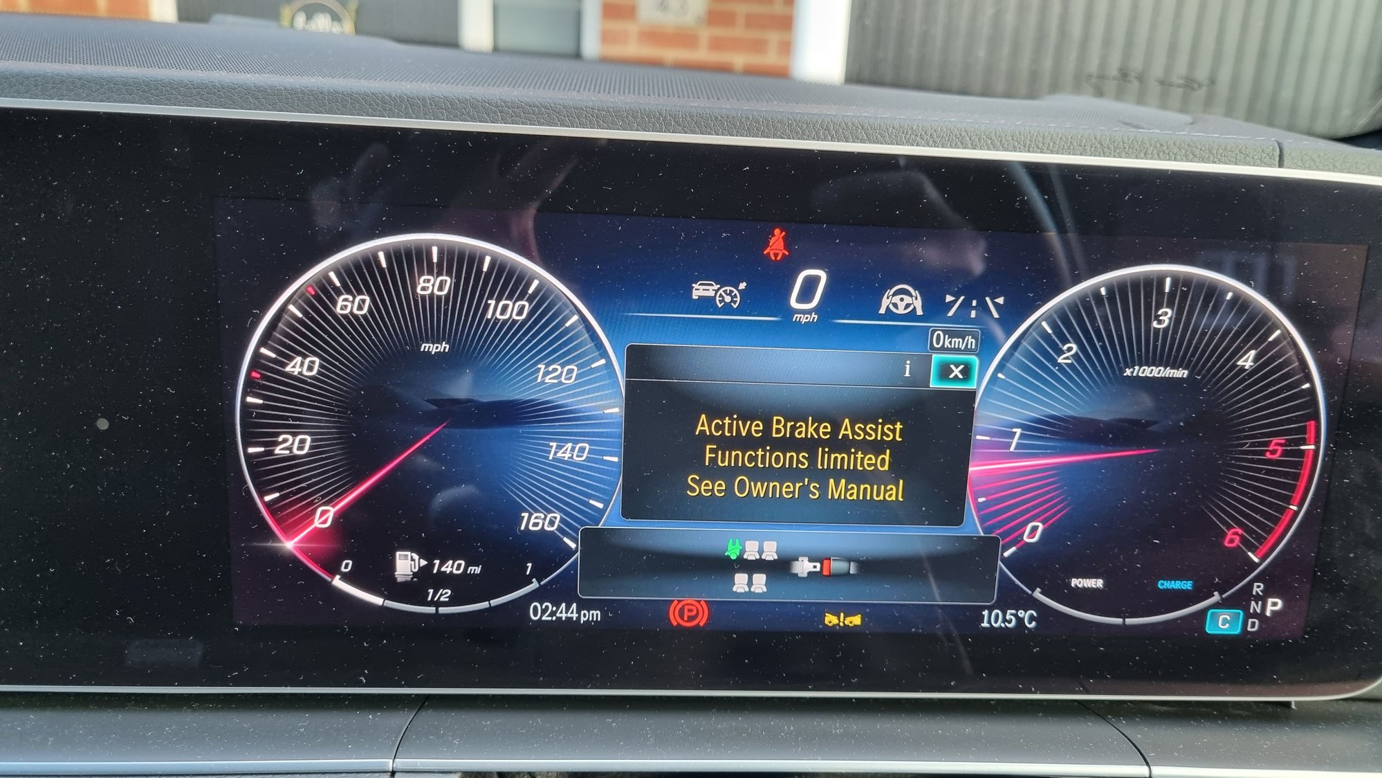

- Left directional touch control on the steering wheel is almost completely unresponsive (only in up and down directions) especially when operated with the thumb. This was verified by the dealer technician and they are currently replacing the steering wheel under warranty.
- Randomly at about every 2 to 3 weeks and sometimes 2 days in a row, a message pops up on the screen when starting the car and disappears when restarting the car. The message is "Active Brake Assist Functions Limited". Sometimes additional pop up windows come up including "Active Blind Spot Assist Inoperative" and "Active Lane keeping assist inoperative". When this happens, I have checked that the sensors and cameras are not covered with dirt, rain...etc.
The dealer has not found a diagnosis for this, but when raised a technical case about the above two issues, they advised to replace the steering wheel and so they suspect the "brake assist" glitch is also caused bybthe faulty steering wheel touch control but I personally doubt this. I should be able to fund out soon.
- The driver side windscreen wiper leaves streaks especially in rain and the streaks are in my line of vision. The wipers were replaced by the dealer in January but the exact problem started again in February despite thoroughly cleaning the wiper and windscreen with the right stuff.
- Middle row left seat (double seater), rattles. They are currently replacing this under warranty.
