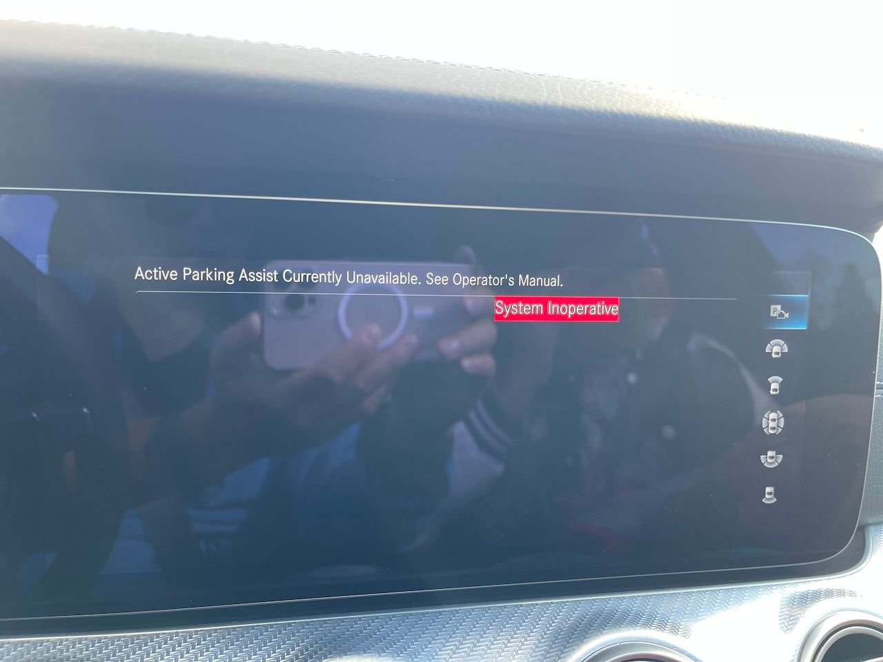

Brand new E450 2023 no camera
Thanks for sharing this.
I got the same error on a new E450 2023, had it for less than one month, total mileage 1,300Km.
R, no camera at all.
+ "Active Parking Assist Currently Unavailable. See Operator's Manual", "System Inoperative".
I tried system reset from the system menu. Camera came back up a bit then gone again. I happens randomly, instant restarting won't help. It happens frequently. Better or worse, engine service light came up soon.
I will contact the dealer. Will update afterwards.

Just reset MBUX. On my GLE, I hold STAR 🌟 and TEL buttons until screen goes blank. It reboots relatively quick, maybe 10-12 seconds. Backup cameras reboot faster than that though (maybe 4-5 seconds). I get this message after carwashes, don't know why but the reboot fixes it every time.

Just to update, Mercedes dealership confirmed software issue, and provided free update.
I am surprised the factory load software fails on the customer's hands. I guess it is related to the reduction of workforce in Germany.
Cameras are back to normal now. But I noticed fan under the hood runs for a couple of minutes after stopped, that I didn't notice before the software change. I will start a separate thread for this.
