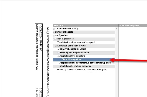

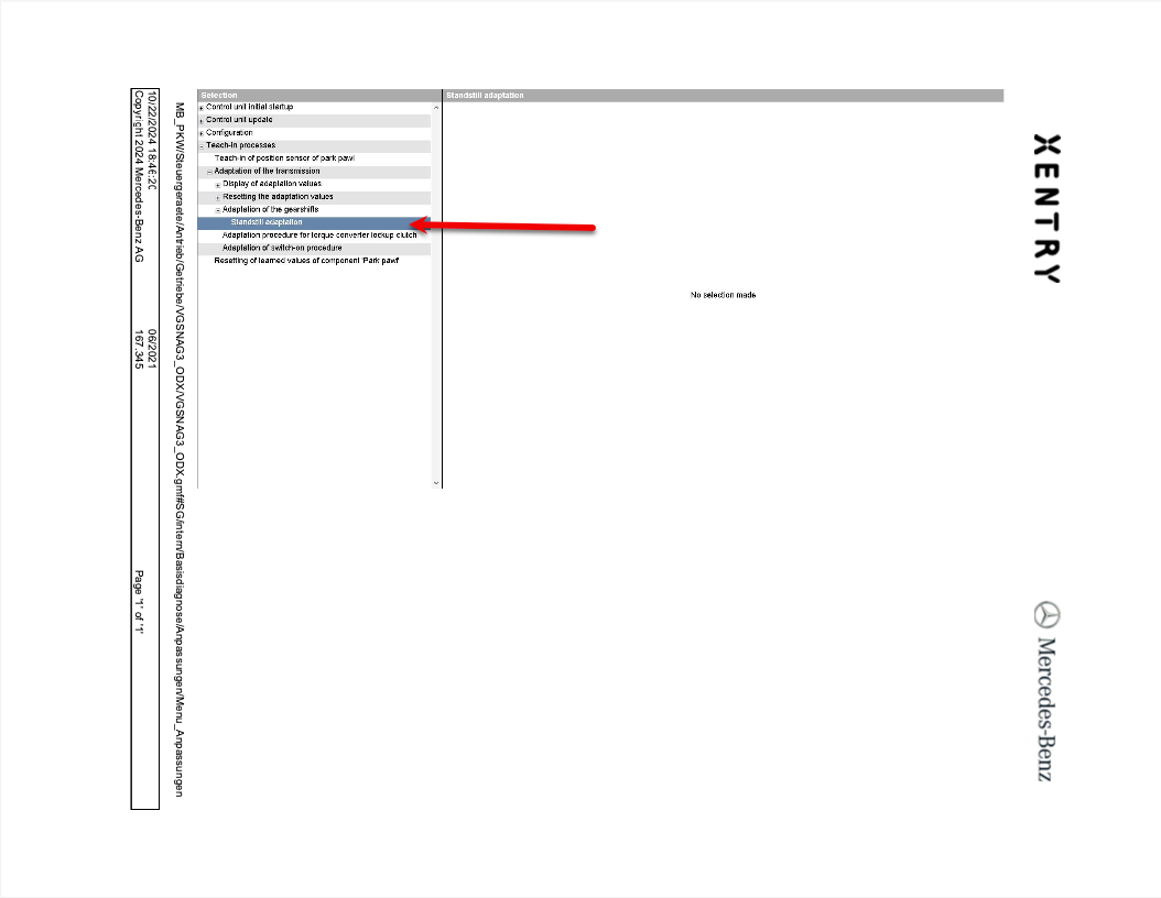

The proper way is to use XENTRY to do a reset and Standstill adaptation.
MB service centers have access to Xentry? (first time I ever heard of that)
One other difference, which I do think makes a difference is that my GLE has the sport pedals and the loaner I drove has the non-sport pedals. There for sure feels like a delay when I press the pedal until the car starts to move in response to that pedal push. I'll push it down and then a second later it starts to accelerate.
MB Service Centers better have XENTRY (they may call it Star Diagnostics). It is the primary diagnostic tool the dealership uses. You too have access to XENTRY. Check with @BenzNinja .
