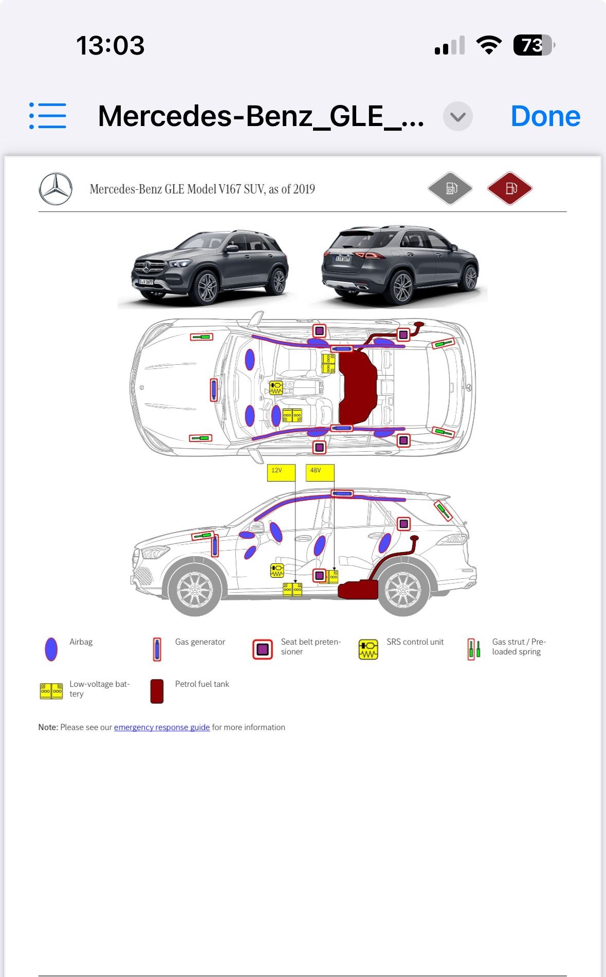

Thanks for your advice. I truly appreciate self help suggestions. This one has me a bit confused. The 2023 GLE350 is not a mild hybrid. Hence no 48V battery. I tried the link and there were so many choices I took the easy way out and scanned the QR code on the fuel door. The picture below is what I got It shows a 12V and 48V battery. I'm gonna poke around under the carpet and see what might be hiding where it says the 48V lives.

That's weird that the rescue card doesn't show the location. Maybe it's so small and the output isn't very high so it's not pertinent to a rescue. Hopefully someone else will chime in with additional info.
You're overthinking. It's more likely the card is simply showing the 48v battery for all models. For the purposes of rescuers, it's better to assume that all models have a 48v lithium battery than to have to know the specific model and potentially not know the 48v battery is there. The card does indeed show multiple 12v batteries even though the aux battery is very small in the older 164 and 166 models.

So I just checked my QR code and I got what looks like the exact same thing as posted above, with additional text/explanation. PDF attached.
It's titled "Mercedes Benz GLE SUV 2019 5D 167.1," so it looks generic to the 167 SUV.

Generic for sure, on page 2 : "Note Vehicles of this type can additionally be equipped with a 48 V On-board electrical system. The 48 V On-board electrical system is deactivated as soon as at least one airbag has been triggered in the event of a crash. Further details can be found in the rescue manual"
