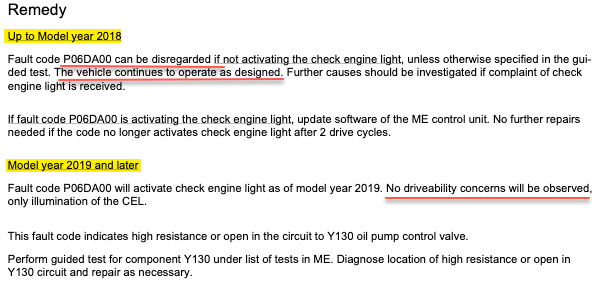

My wife has a 2020 GLE350 with around 55K miles on it.
The check engine light came on a couple of weeks ago. I scanned and the only code showing was the notorious P06DA00 oil pump control valve and wiring harness one.
A couple of days later, check engine light turned off by itself.
A week later, CEL came back on.
Took it to our indy mechanic shop and they said, “it’ll be a $3K fix, we cleared the code, keep driving it and don’t worry about it.”
So we did!
Unfortunately, the check engine light came back on and has remained.
No noticeable drivability issues.
I’ve read that the code shouldn’t cause a CEL, and if it does, it’s a problem.. but not sure what to believe.
I can’t find clarity - can the code be ignored when a check engine light is present, if no drivability issues are present?

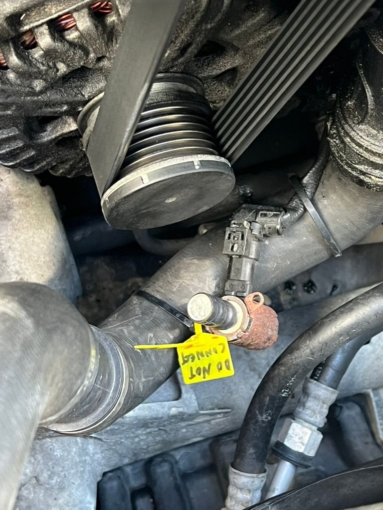

2019 and newer cars will trigger the CEL in addition to throwing the P06DA00 code.
To get rid of the CEL, attach a dummy solenoid as recommended. (The "DO NOT CONNECT" tag is to alert any mechanic to not reconnect the wiring harness to the solenoid connector on the engine block.)
Didn't occur to me that thing can rust
Normally it would be submerged in oil. Or at least not exposed to the elements. Plus, that's my cheapo AliExpress solenoid. I am glad I put heat shrink over the critical part.
I see. So with the oem one it might not rust?
It still might rust. I will check my other car tomorrow to see if it is rusted, as well. It doesn't bother me about the rust because the part is sacrificial anyway. Having the heat shrink on it should protect it from the elements.
I understand the rust is not a big deal (on this) but still interesting to see, thought it was made of aluminum.

W205C43PFL's Avatar
Posts: 32,320
Likes: 6,307
Actually, on a second thought, given as you mentioned this is bathe in hot oil, it can't be aluminum as it will bend.
