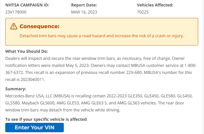

I seem to remember there being a recall for this. Not sure if it applied to your model year. Check for recalls with your Vin #.
Here are a couple of recalls.....

I made an appointment with Mercedes Daytona. They looked at it this morning and determined that the trim piece in question ,to insure no issues was best replaced with a new one. A replacement is on order and should be in next Wednesday. So it appears if you remove the trim for any reason it might be a good idea to replace with a new one. I would agree with that as I saw how it attaches. BTW the recall on the GLE 's up to 2023 window trim was for the trim on the vertical post between the front and rear doors.
