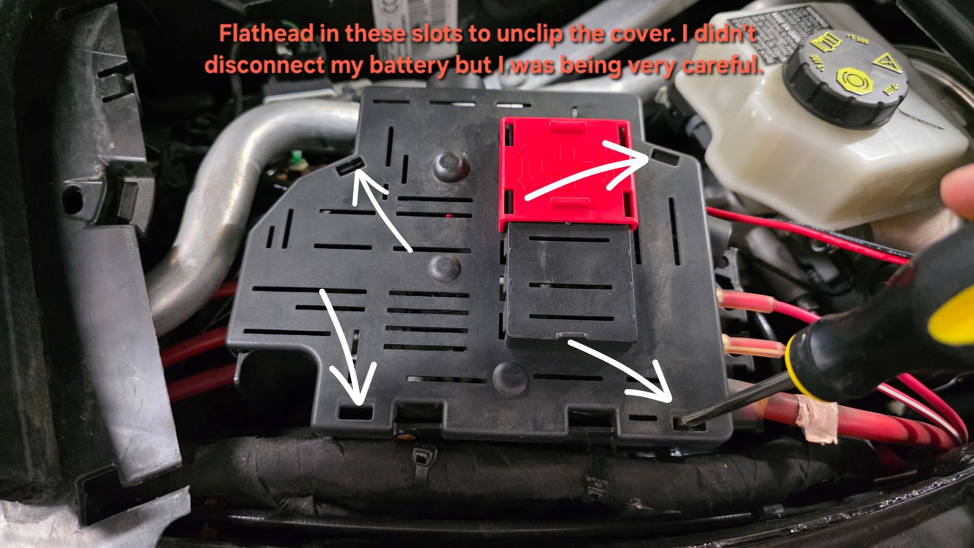

My other quick disconnect leads didn't have a fuse, and I wanted to swap it with one that had an inline fuse. I finally got around to getting one and replaced it. I decided to snap some photos to help others. It takes 10 minutes to complete.
Once you remove the main cover above, there's a second cover that needs to be removed with a flathead as seen in the image below.

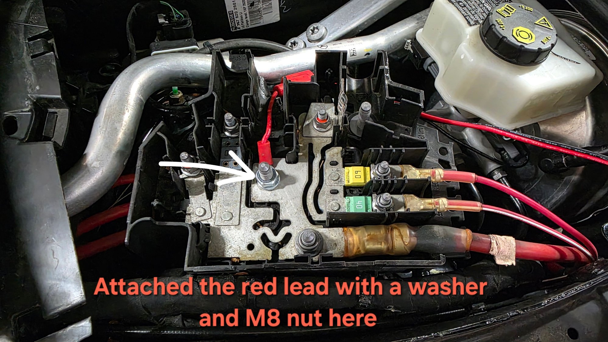

There was this available post that I attached the red lead to using an M8 nut and flat washer. If you don't plan to disconnect the battery, be extra cautious.
Black lead zoomed in.
So now I don't have to open my hood to connect my maintainer. It wasn't difficult before but now it's really easy.
