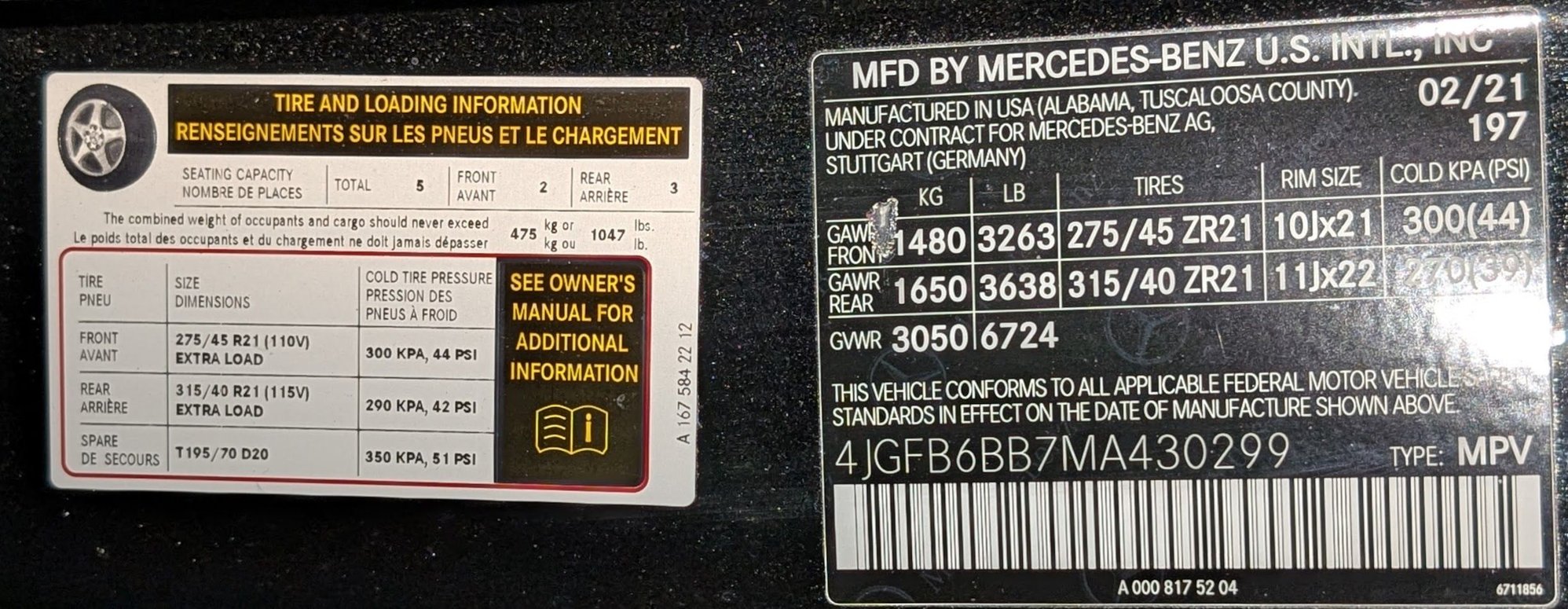

You will want a weight distribution hitch and sway control. The Andersen hitch is popular because it uses friction for sway control and is the lightest of the bunch.
Weight Distribution Hitch w/ Sway Control | Andersen Hitches https://share.google/bWtV8uK07aCDt4yV0
However, my favorite for sway control is a friction sway bar, included in this package, the same as I used. Eaz-Lift Elite 10K Weight Distribution Hitch, 2-5/16" Ball
https://share.google/0Hrqj5sb19FFy8j95
Load your trailer to keep your tongue weight at about 10% of the loaded trailer weight to reduce sway potential. The hitch and the tongue weight both are part of Cargo Capacity. Try to keep the tongue weight under 800 lbs (hitch limit is 600).
The Andersen is what most Towing Folks use on the forums I visit.
If you want to sacrifice some control, some drive with no WDH but still use a cheap friction sway bar, part of the #2 link above.
