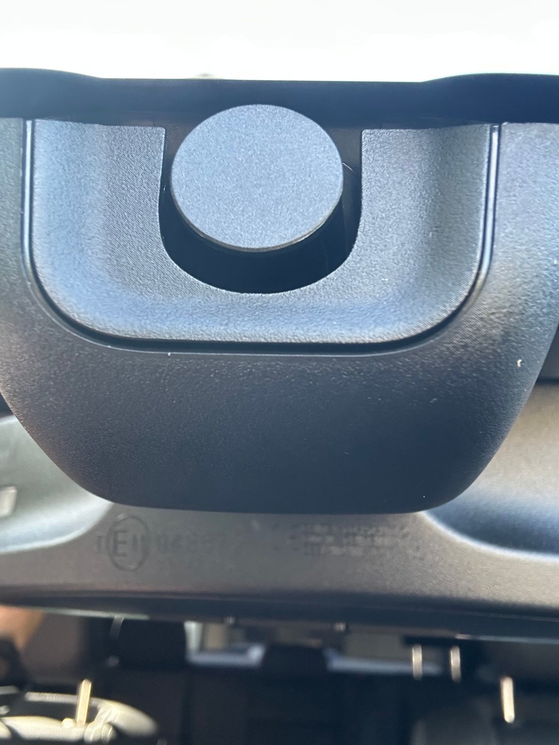

I recently purchased a 2025 GLE 450e. It has the exclusive and drivers assist package. I also see the camera housing under the rear mirror. However, I have not been able to located the option of turning on the Augmented Navigation in the navigation menu.
I don’t know if there is a camera in the housing
since I read somewhere that certain MY25 did not come with this feature due to supply chain issues. So at this point I don’t know think I have this even though the camera housing is there. Has anyone else experienced this issue? Is it possible to add the camera?

The camera(s) are visible if you look closely. On my '20, which is hard to see from this angle, t have the one on left of the photo which provides Augmented Video for Navigation, but I am missing the other one because I did not get the DA package. There is a clear difference between a lens and a blank off. The feature is usually part of a package, e.g. Technology or Pinnacle Trim.

You are correct. Several models did not come with augmented navigation or have available the option for the dash-cam due to supply chain issues. You can tell by looking at your build sheet or looking at the camera housing from outside the vehicle on the windshield below the rear view mirror. There’s a place for the camera lens that just has a plug over it. It’s my understanding it has been added back for MY26.

Thanks..it looks like that’s the case on my end. Is it possible to add it? I have the housing but there is no camera in there..

While it’s possible to retrofit, it’s not as simple as buying the camera. Mercedes put in a lower grade MBUX head unit. Therefore, the MBUX must be replaced with the higher grade one along with the camera and coding. If you are a DIY, you can check out RJAutomotive.net which provides the MBUX unit and camera, and they’ll provide remote coding after you install it. Another place is Benznija.com. If you want to go to Toronto, there’s MB House www.mbhouse.ca that actually installs customizations. All of these places have been used on here successfully.
