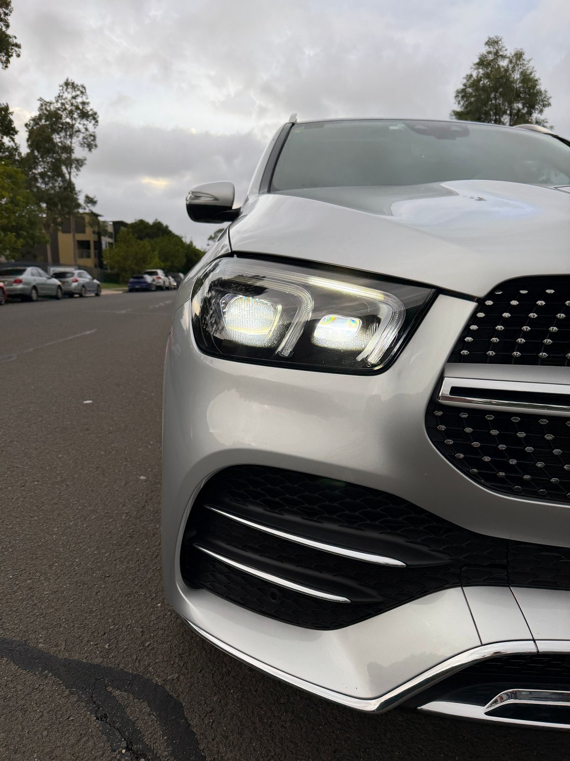

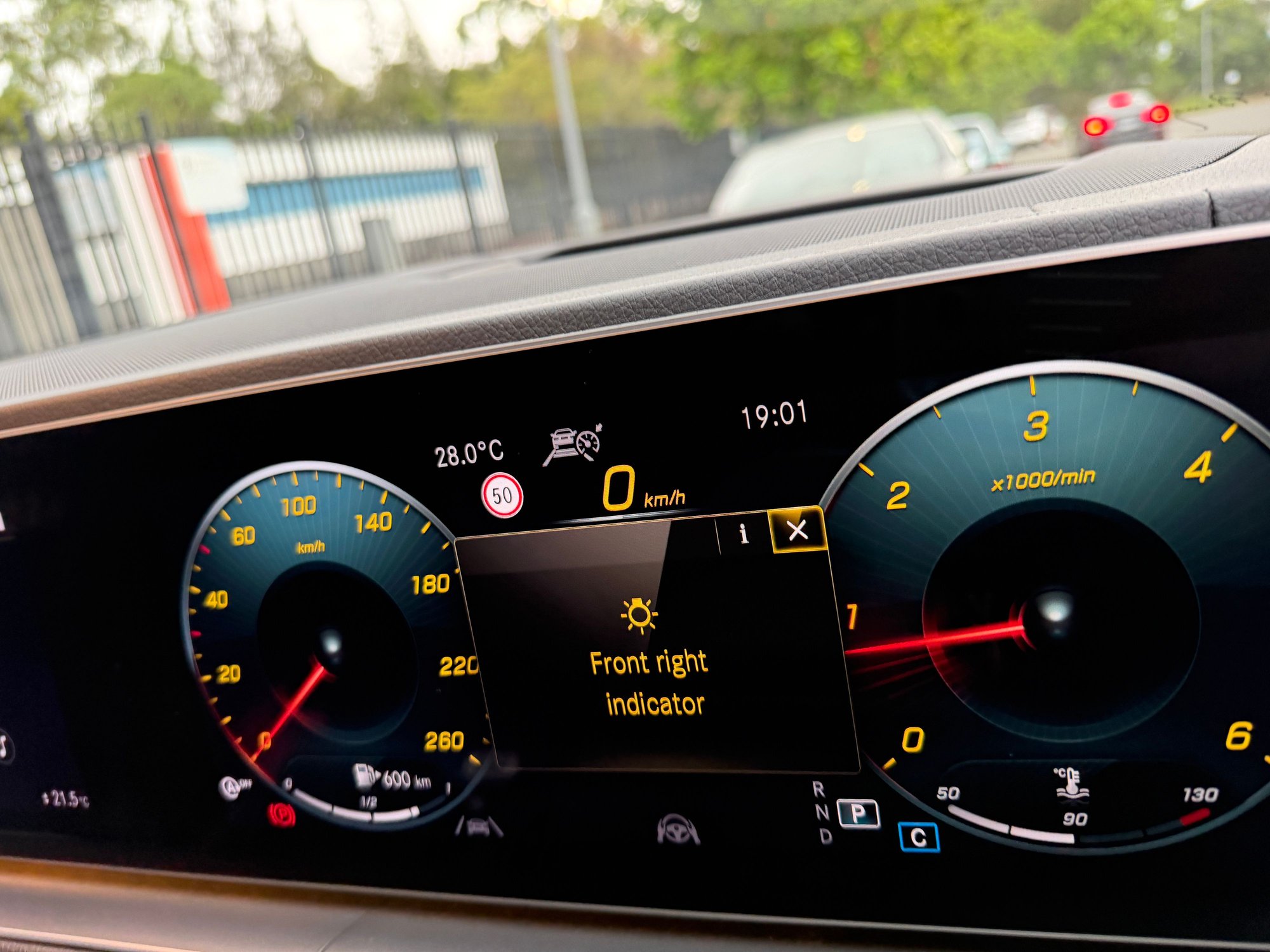

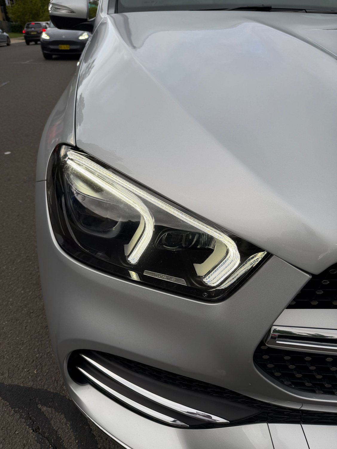

I have had front right indicator fail on and off, before failing completely, followed by front left indicator fail.. in a span of 3-4 weeks
Both front indicators show error and do not turn amber
All other lights work, including multibeam
