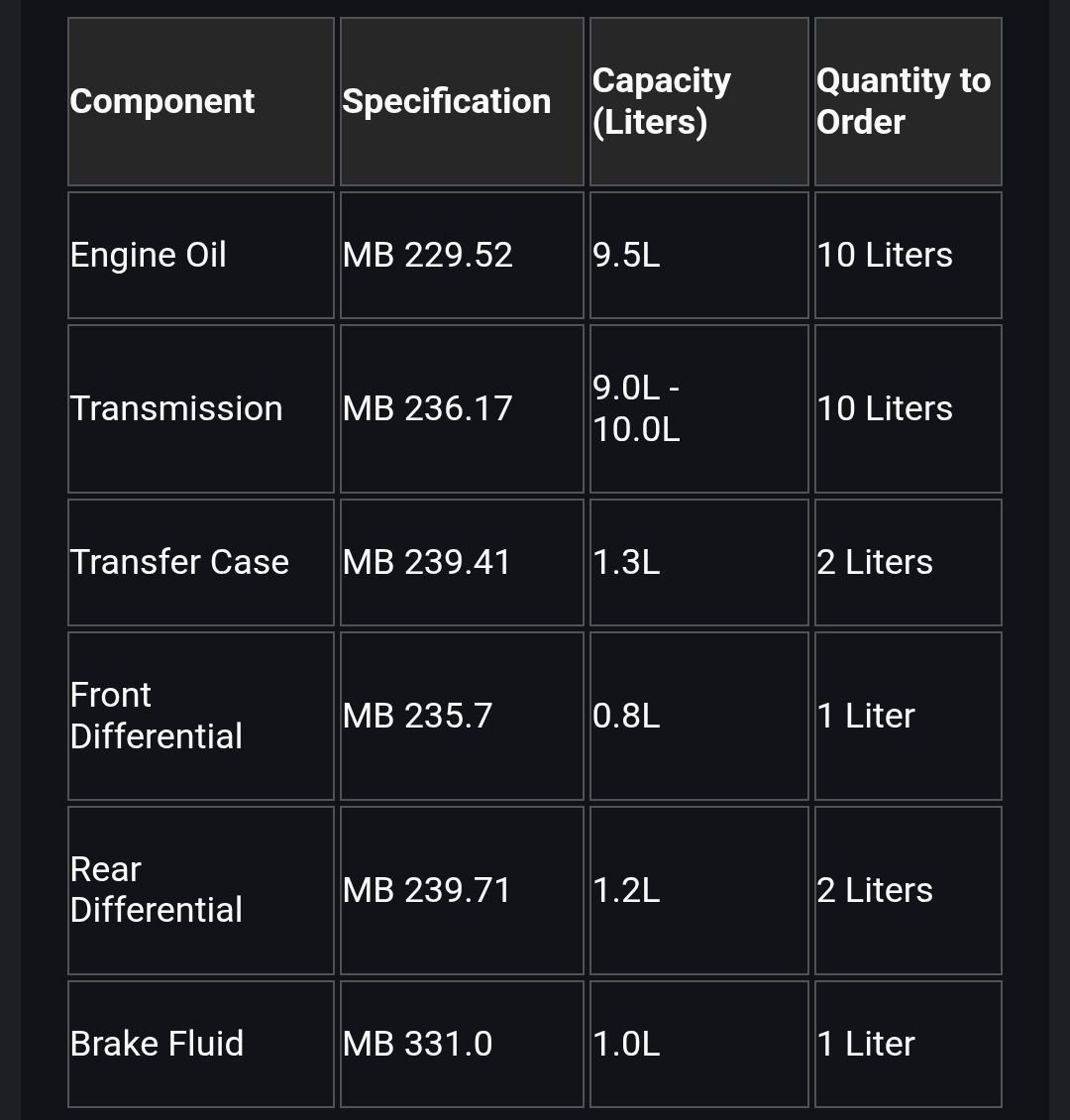

I'm doing this same work on Monday with my indie. I also asked Gemini AI and he wanted to compare his references to my Gemini AI output. I'll keep you posted. I have a 2020 GLE 580.
Gemini AI output
Gemini AI output
