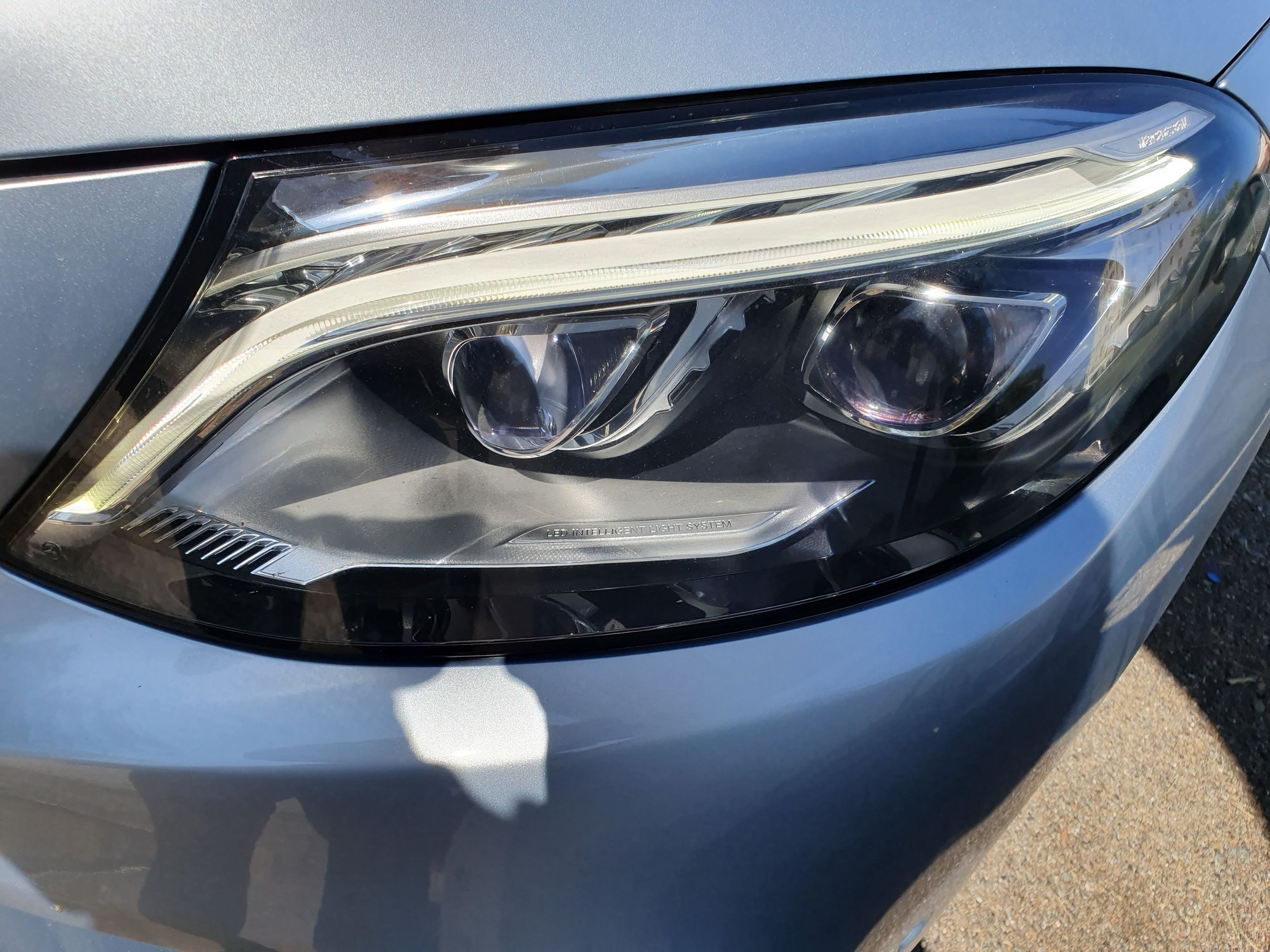

BTW I have headlights with option code 642 DYNAMIC LED HEADLAMPS,, can I convert them to the adaptive highbeam assist?

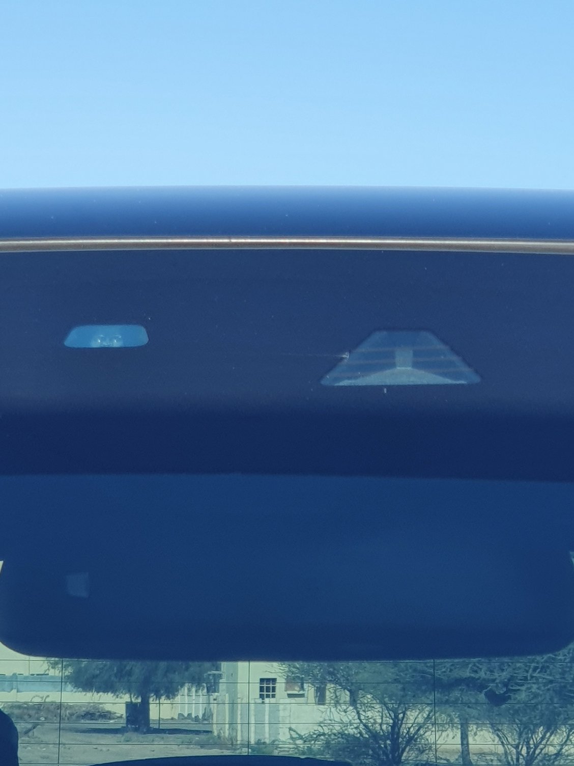

Can you post your VIN and also a photo from the outside of the vehicle showing the rear view mirror? Active headlamps use an optical sensor in the windshield. Coding is not an option if you don’t have the necessary hardware. Checking the other options on your vehicle using the VIN helps answer the question.
VIN# WDCDA5GBXGA643196
As requested, one photo outside of the vechicle and I added a photo of the headlights

Option 608 auto high beam switch is not there.
The windshield appears similar to my vehicle, which has auto beam dip. Have you asked your dealer or an indy shop if what you want is possible?
This suggests that what you want might be possible: https://www.slkworld.com/star-diagno...ctivation.html

Thanks Chassis for the reply. My car has ILS which is a requirement for the heighbeam assist as per the link you have posted. So maybe it is a matter of programing and that's it
