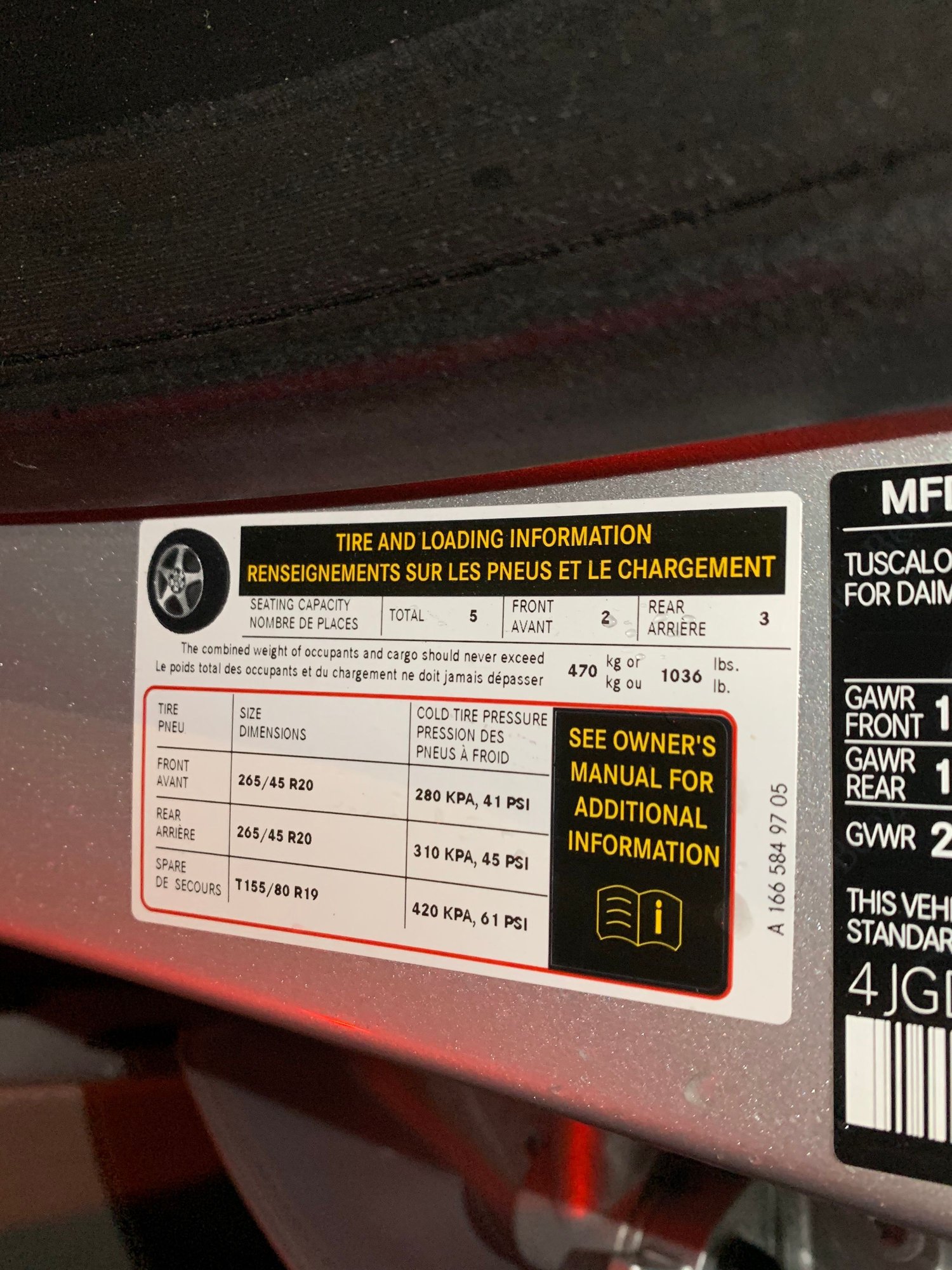

I've the 2017 GLE 43 W166 with 20" wheel and 265/45/r20 factory tires. When I brought the car at 2017, all 4 tires were inflated at 42 psi, I've been drive it for all those years and I never saw a tire pressure warning at the instrument cluster.
Recently I visited a tire shop and the staff inflated my rear tires to 46 psi, and then I realized the tire pressure sticker on my driver door require the rear tires to have 45 psi! I've drive the car for few weeks with this new setup and I find the tire noise from rear wheels increased a lot! Especially with high speed.
It confused me a little bit that if the recommend tire pressure is 45 psi for rear, why the tire pressure monitor didn't complain. I'd appreciate if you can share what tire pressure your car are running at.

On my 2018 GLE 350 the tire pressure data on the drivers door frame states for "max load" which is front:45psi/rear 48psi.
The tire pressures for "normal loads" are stated on the data label inside the fuel filler door which is: front & rear 32psi each.
The above are all "cold" measurements

Inflating the tires to the max pressure listed on the sidewall of the tire is not advisable. It leads to a harsher ride, increased tire noise, decreased traction. It can also cause abnormal tire wear and make the tire more susceptible to road damage. The owners manual clearly states that the recommended normal driving conditions tire pressures are listed inside of the fuel filler door. The pressures that are listed at the driver door area are for when the vehicle is at it's maximum loaded weight (full of passengers, luggage, fuel, towing a trailer). The TPMS will not alert to tires that are over inflated. 1 psi + or - of air pressure is not going to be noticed by the driver (if you are a professional F1 driver this does not apply to you). I do feel that 32 psi in the tires is a bit on the low side and therefore run 36 psi just as Isawelvis does. To the OP, you should try reducing the pressure in your tires to what is listed on the fuel filler door, I think you'll like the results, after all it is what MB recommends.

Never new why our 2017 GLE400 had 3 stickers with different pressures each! So I should consider only the fuel door one, thanks guys!
