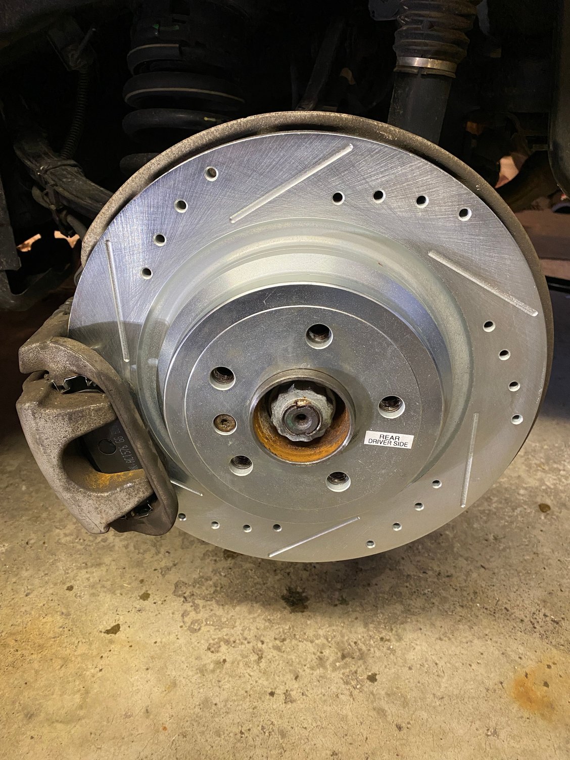

I just did my rear brakes on my 2016 GLE350 with a pad and rotor kit (Powerstop K7440 Kit) from www.rockauto.com for $142. The kit was out of stock on Powerstop pads so I substituted with Akebono pads which included the wear sensor. Tax and delivery was about $165 ( I ordered extra wear sensors I thought I needed that’s not included here).
If you have pad life left on the front brakes you shouldn’t have to replace them at the same time as the rear brakes.
If you’ve done brake jobs before and have the tools to do the work yourself, it’s not too difficult. There are good online videos (the electric parking brake needs to be put in the service position to change pads) along with some references and links on this forum like the ones from Chassis.
Akebono EUR1630A ceramic pads with wear sensor for right rear brake.
Powerstop 7440 (Z23) countersunk drilled and slotted rotors
