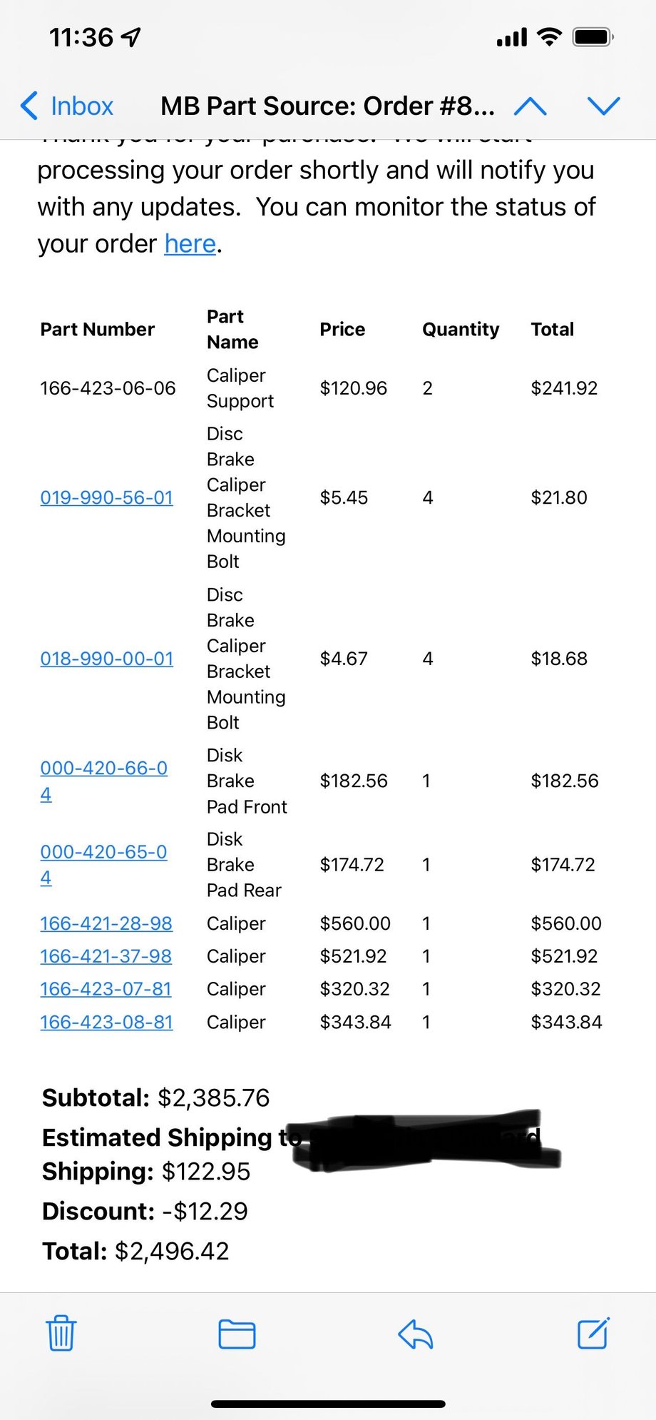

Hi @threeMBs I have finally pull the trigger in ordering the brake kit at MBpartsource as they have the cheapest pricing for the system and order the Brembo rotor at eeuroparts.com, I will keep the updates here thanks once again for providing the guide.. total dollar spend close to 3k for parts including the brake pads ,rotors, caliper, back bracket, bolts etc.. and labor is $500 for install all 4 of them

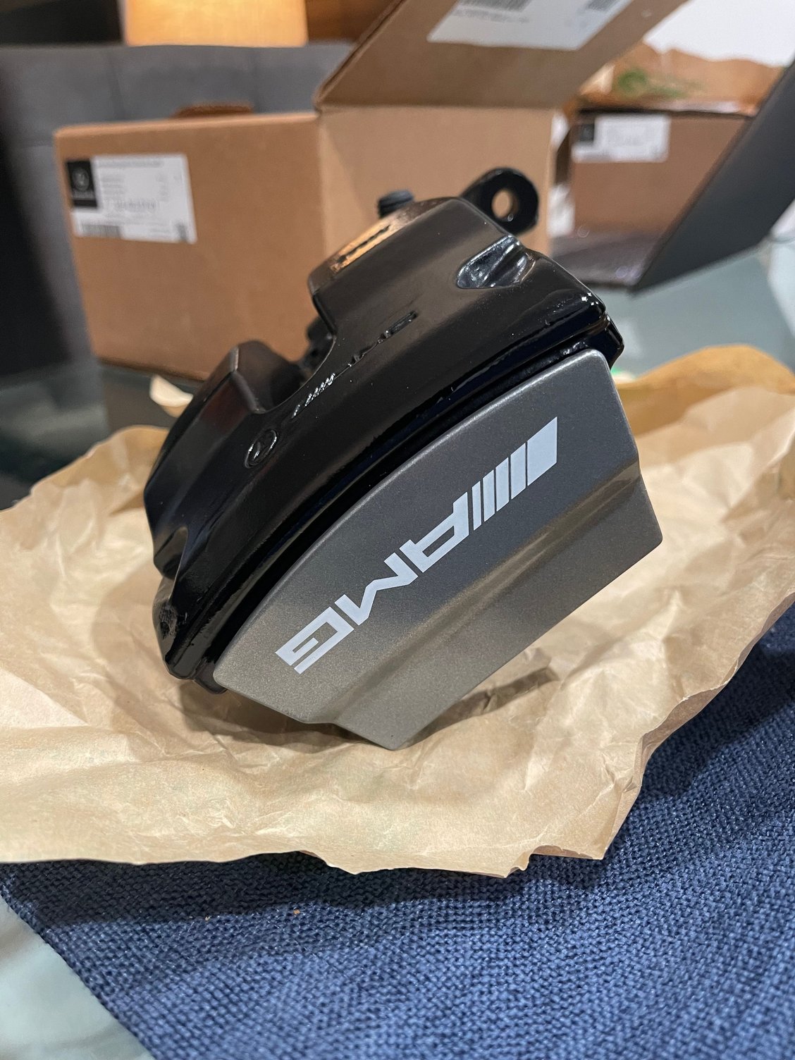

Yes I have, both the rear calipers (except the AMG plate of course) and the brackets.
Since I could not find the silver/gray color to match the fronts (it seems everyone paints calipers red), I used flat grey primer (many coats), then finished with several heavy coats of gloss clear coat:
https://www.homedepot.com/p/Rust-Ole...4017/307244825
https://www.homedepot.com/p/Rust-Ole...4029/307244797

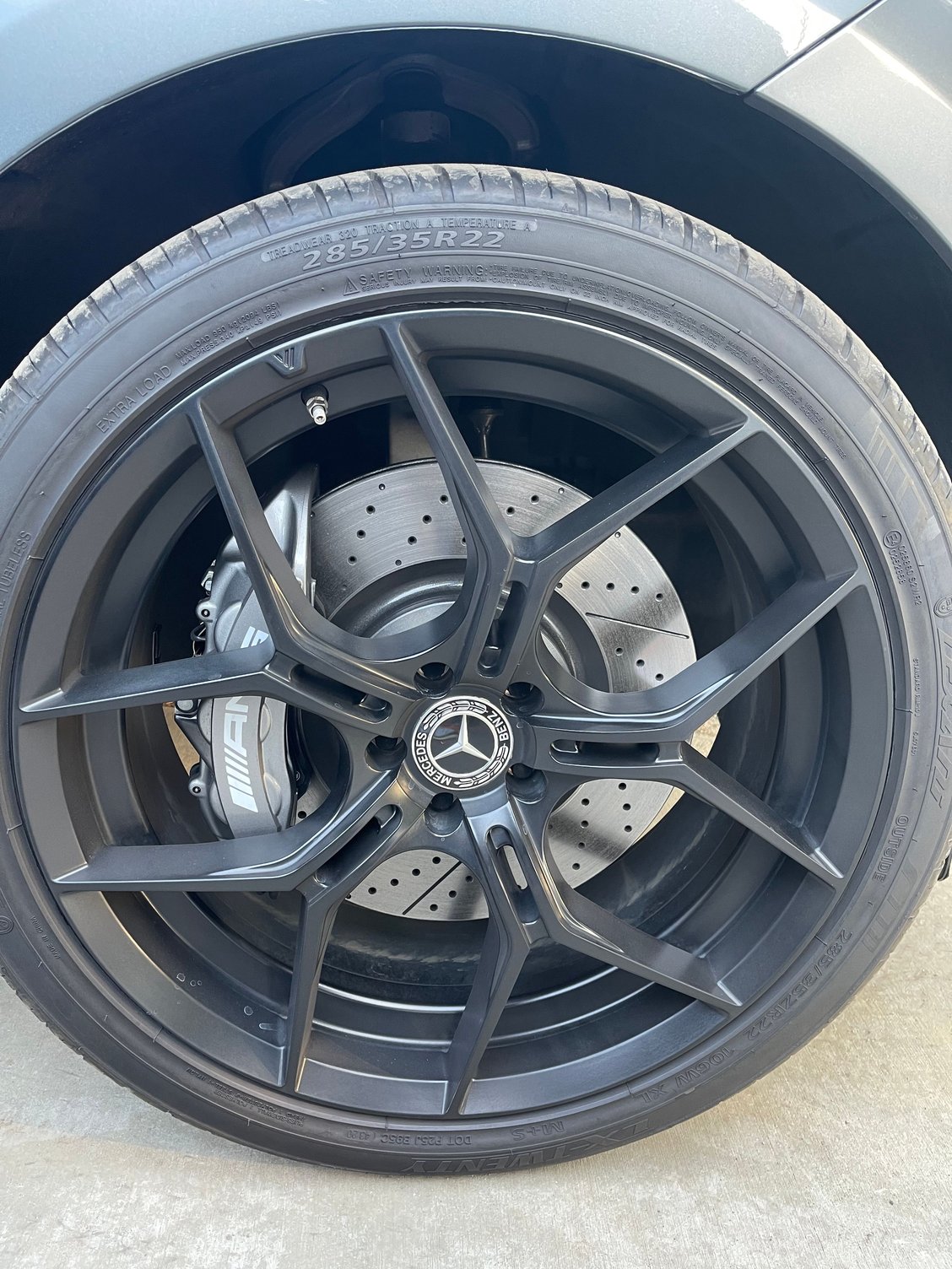

What is the size including width of your wheels and the offset?[/QUOTE]
yes the size of my wheels are 22X9 running with 285/35 R22 front and rear… think I will have clearance

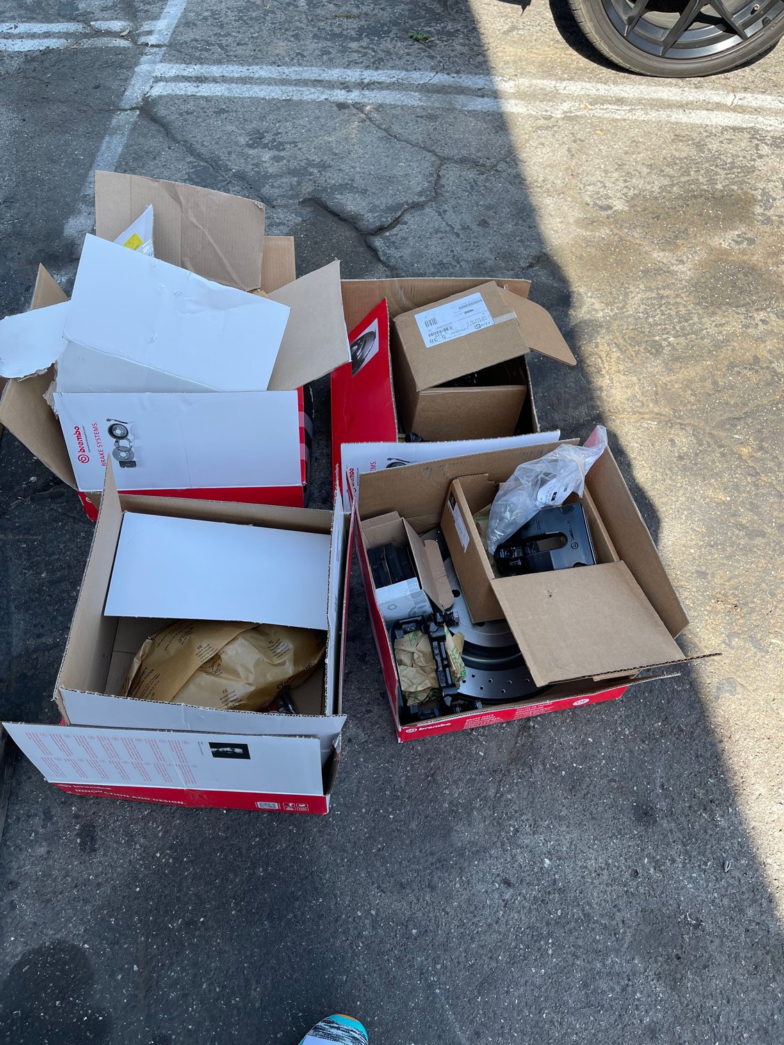

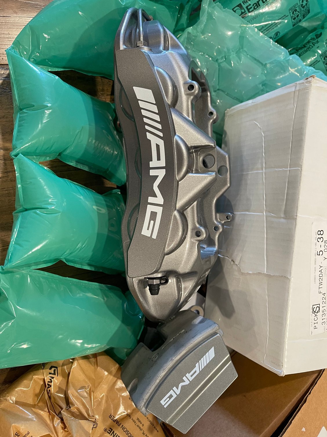

Delivered

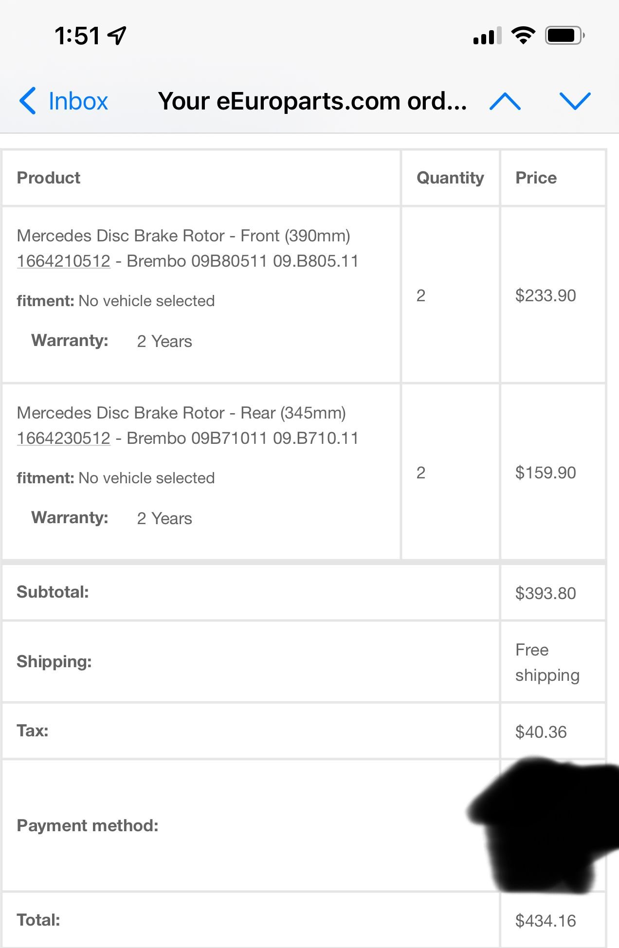

Just an update I was able to get all order from MB only thing missing are the rotors from eeuro.. ill keep posting upadates thanks once again threeMBs…

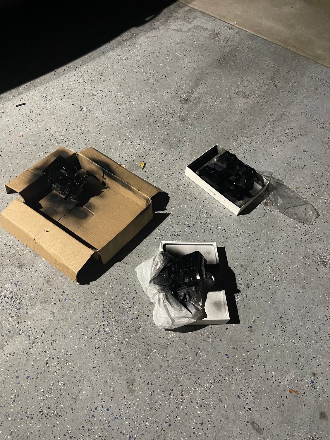

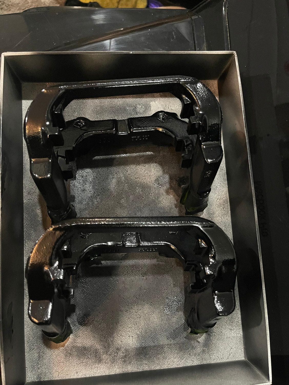

Painting it Black
so I have decided to paint it and used duplicolor gloss black for rear calipers..

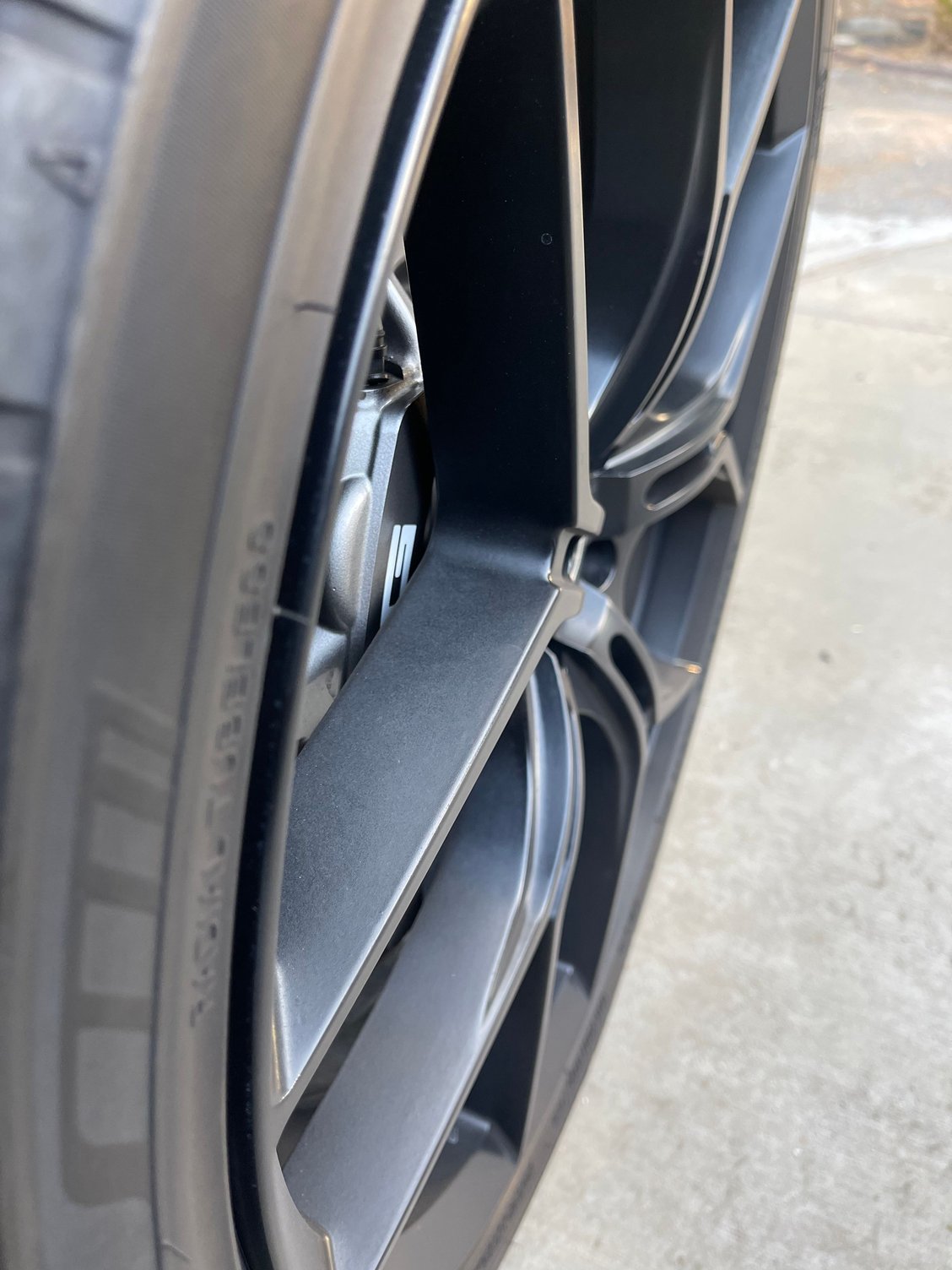

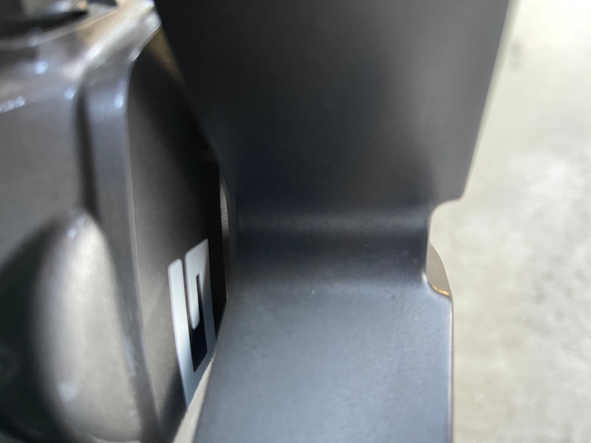

Fresh look
Here is the finish product

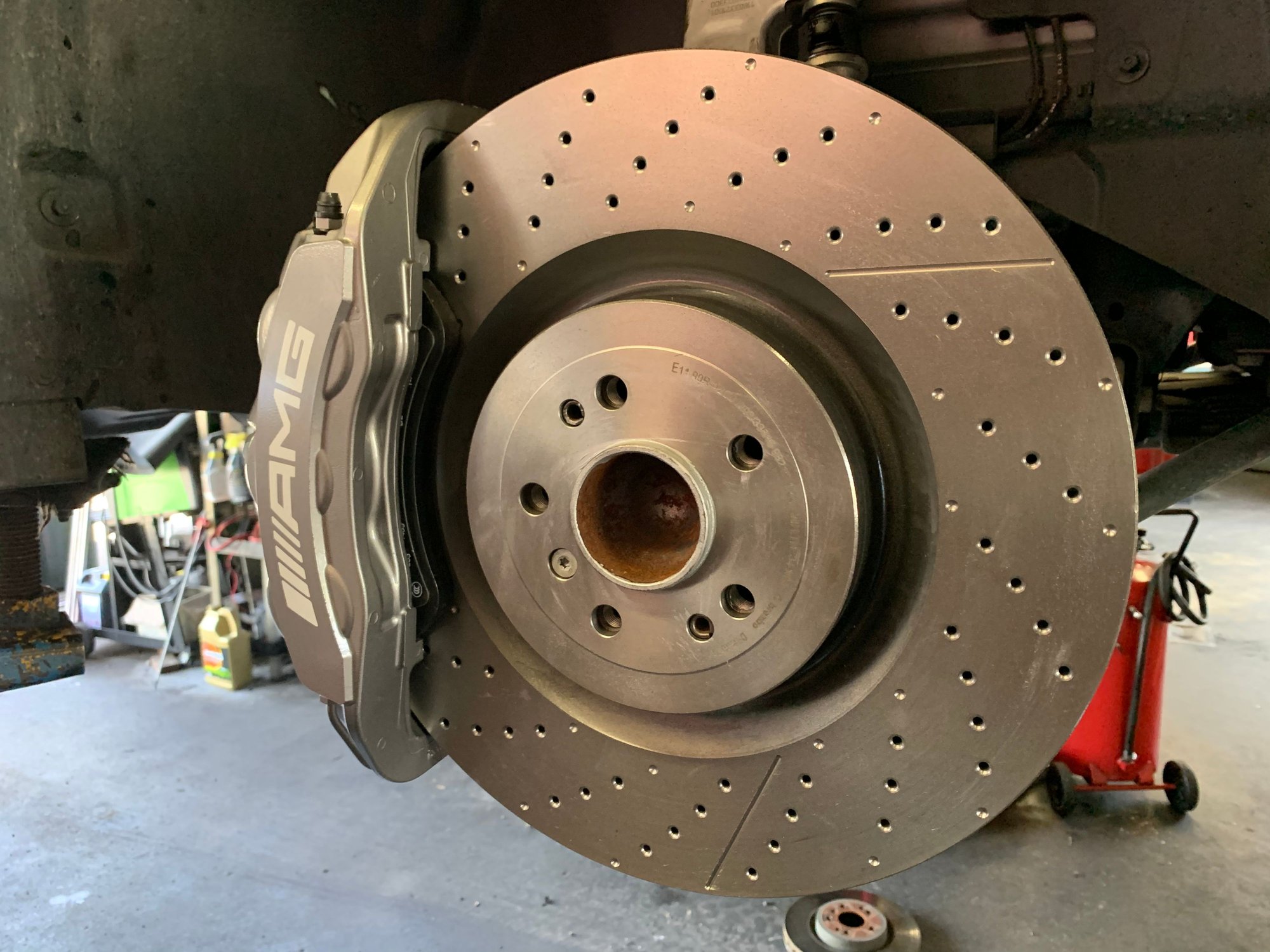

Old May 25, 2022 | 03:10 PM
  #41
markrym's Avatar
Joined: Nov 2019
Posts: 22
Likes: 11
From: CA
2018 GLE350

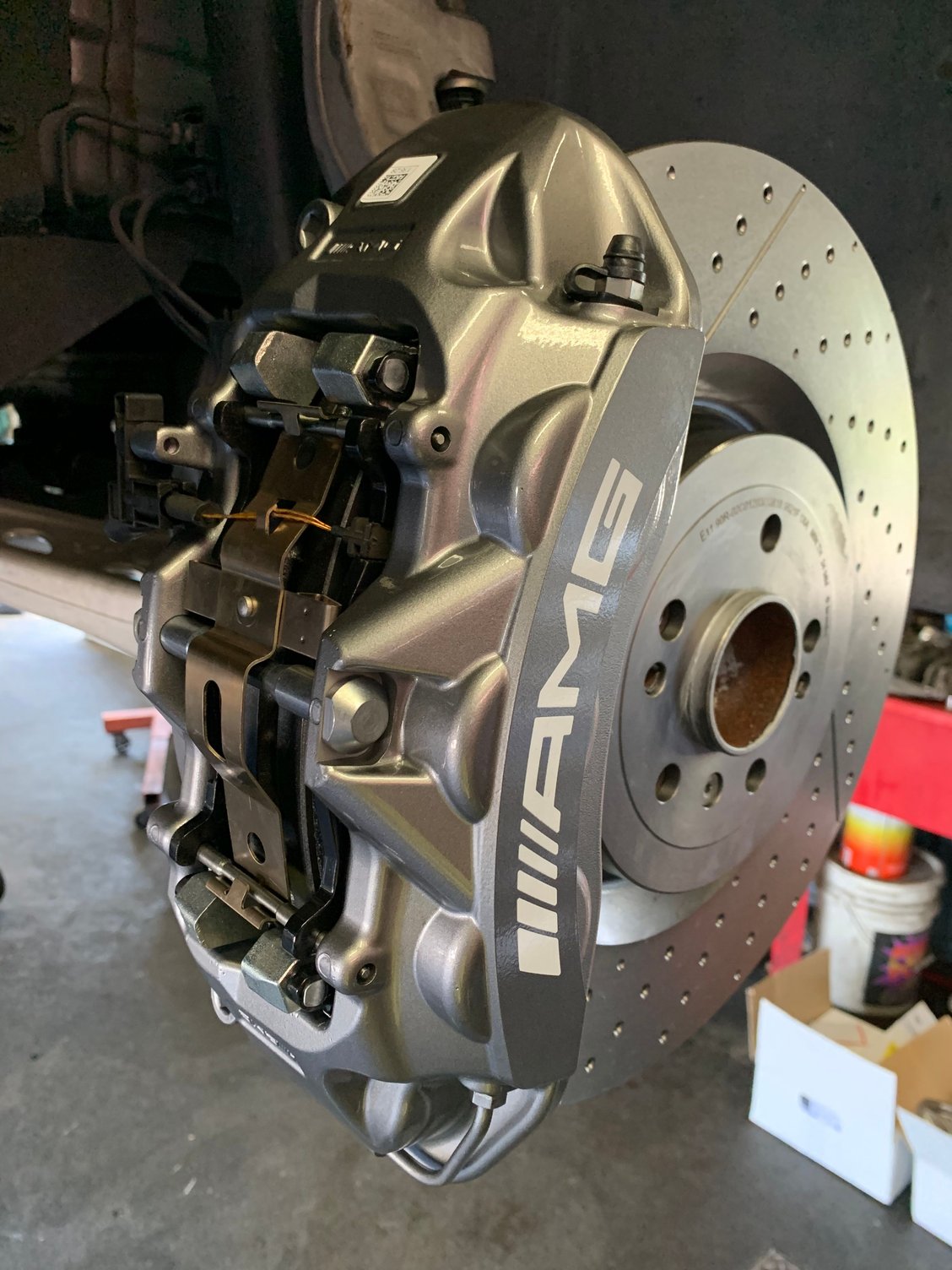

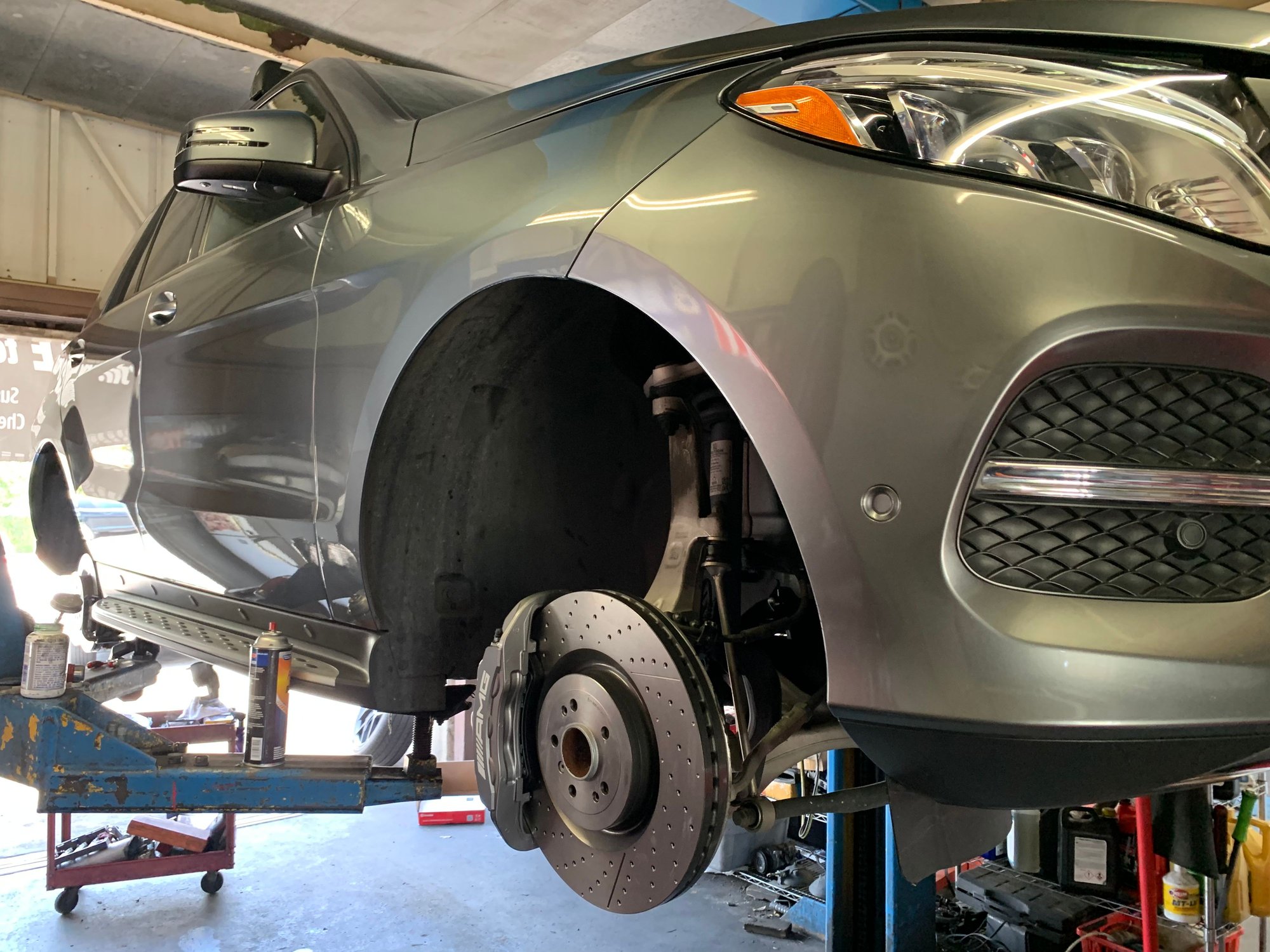

Installation appointment with Independent shop
Old May 25, 2022 | 03:15 PM
  #42
markrym's Avatar
Joined: Nov 2019
Posts: 22
Likes: 11
From: CA

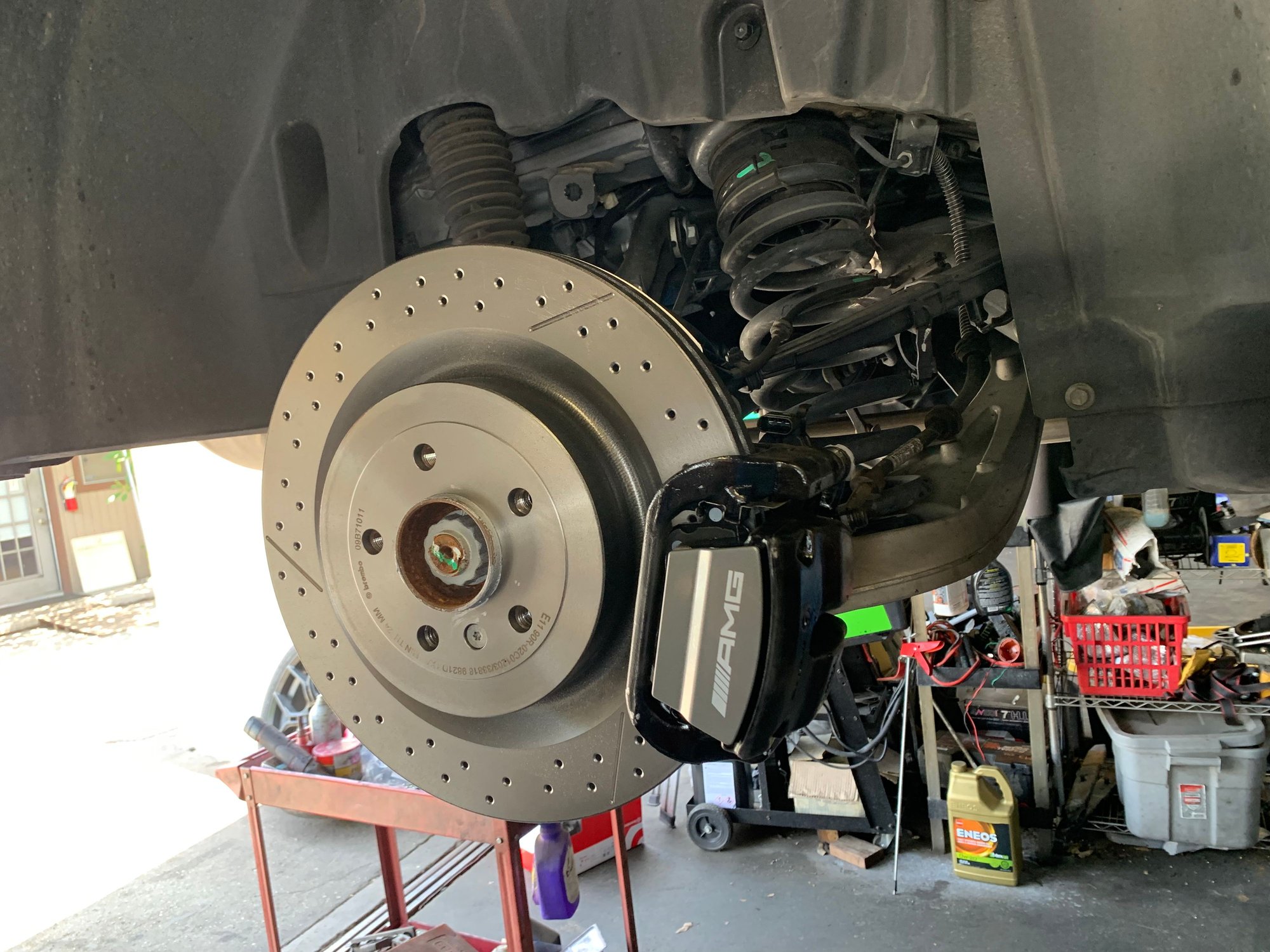

2018 GLE350
Rear Calipers.. No Problem with fitment as well

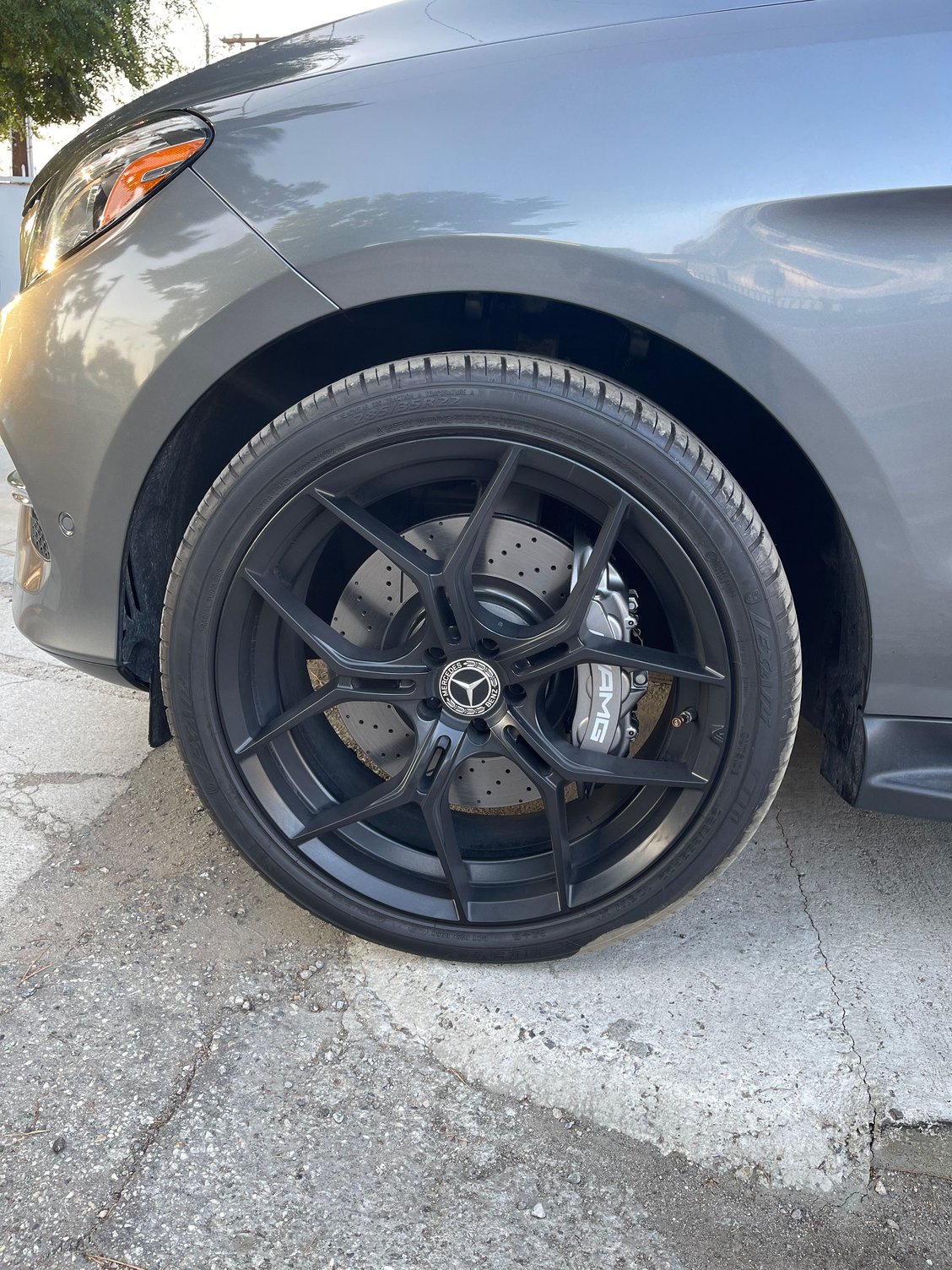

All Clear!!
threeMBS thank you so much and full credit to you on the regular GLE350 because you have helped me so much.. god bless sir

Let me share a little bit of story in this project, I knew from the very beggining that I need to make two changes on this vehicle.. Wheels and Brakes.. I live in CA southside so there is really no need for me to get 4Matic however all the bells and whistle for add on to this vehicle are here, just to name a few, illuminated star, LED head lights, hot and cold cup holder, running boards led, etc.. now fast forward after replacing stock 19 inches wheels was able to focus and search in the internet for thread like this on brakes, however no luck at that point.. but when threeMBs posted this thread that made my day and everyday I keep on reading doing my search comparing part numbers for regular GLE350 to AMG43 and AMG63 just to make sure I will not miss anything.. biggest concern for me are the mount for calipers would it be different from a vehicle with strut, shox and springs vs airmaric etc. so upon calling the MB dealership where I purchased this at www.mbpartsource.com, i spoke to a gentleman and he told me it will fit however they do not want to be liable for the info, and i told them i wont take it againts them and by the way the items are non returnable so i gamble.. told myself if this will not work i will just sell it at ebay or something, now pull the trigger for install and as what threeMBs mentioned it is really a nice upgrade, you get that more stopping power and to be honest the way it drives now it feels more lighter than having the OEM rotors for some reason..
night and day difference on this plus bigger wheels and bigger brake kit is really an eye catcher or neck turner, lastly here in CA traffic is harsh so it was nice seeing people looking at your wheels and smiling at the same time..
