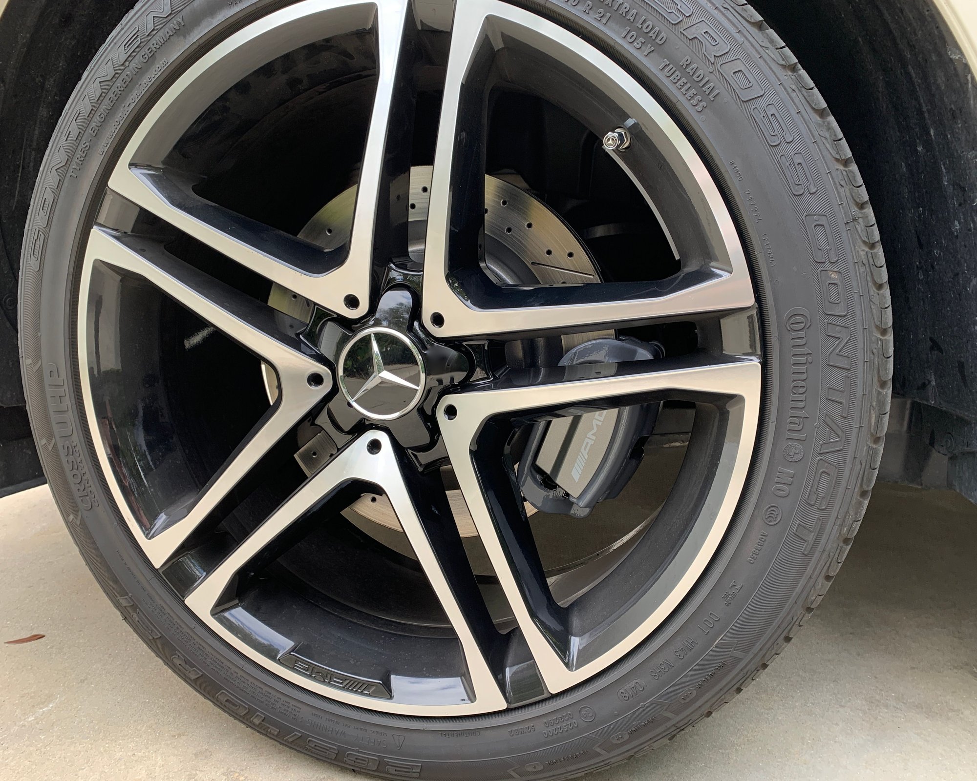

Front and rear after the conversion:

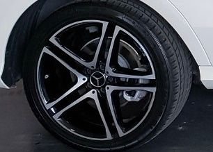

Stock GLE43 front and rear:

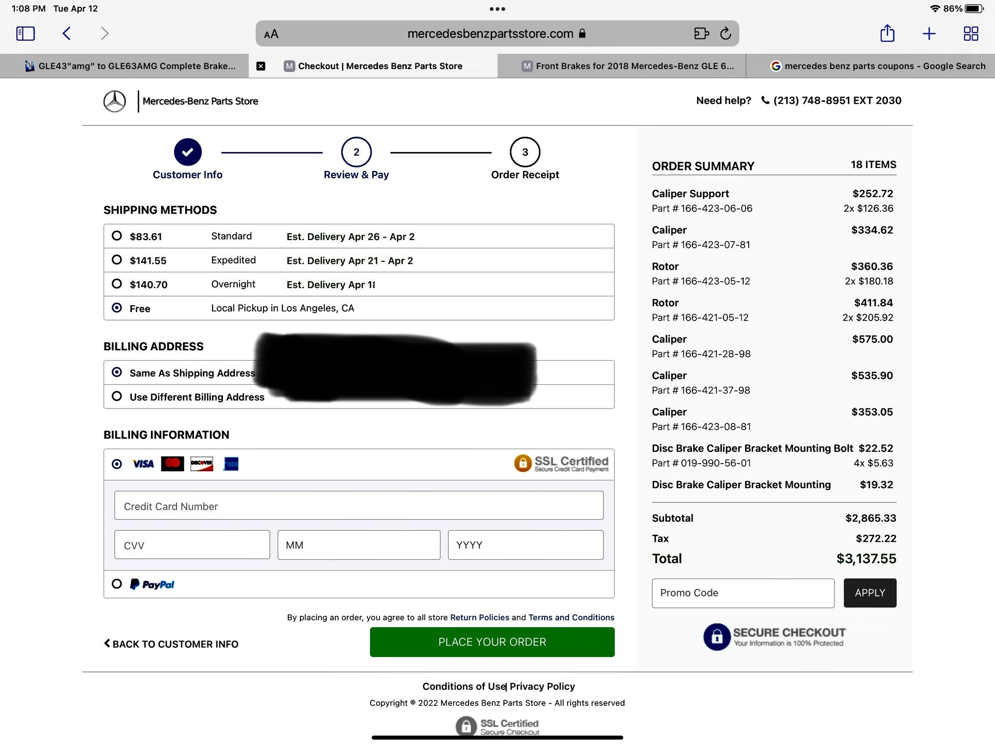

Hi threeMBs.. Thank you for sharing the entire recipe for the break upgrade, just a question here do you know if this upgrade will work on a basic W166 2018 GLE 350? will it fit and get hooked up on the brackets?
also do you know if there is a difference in brakes and rotor mounts if you have a non air-matic suspension vs standard shocks and strut?
Lastly what website do you use in purchasing the Calipers? and rotors? (brembo directly?)
I appreciate this thread and I hope it will work in my case..
Again not sure on 350s, but my understanding that for W166/X166 chassis all those points should be the same regardless of the model.
OEM pars (calipers, brackets, flexible brake lines, bolts, pads, etc) - https://www.mbpartsource.com, https://parts.mbobr.com or similar.
Brembo rotors: amazon, newparts.com,
eeuroparts.com or eBay(partscontainer or something along those lines), whichever is less expansive today, since it had to change significantly from last November when I was buying everything.
