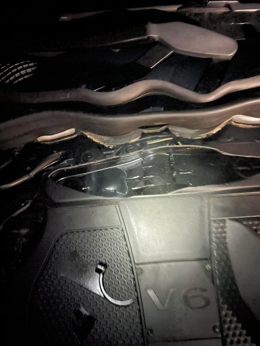

Talking about leaking injectors, see what happens to an owner of a W212 (reported on another W212 Facebook group yesterday), same M276 NA engine
Due to "faulty coil pre-ignition" with fuel vapors in the engine due to leaky injectors.
