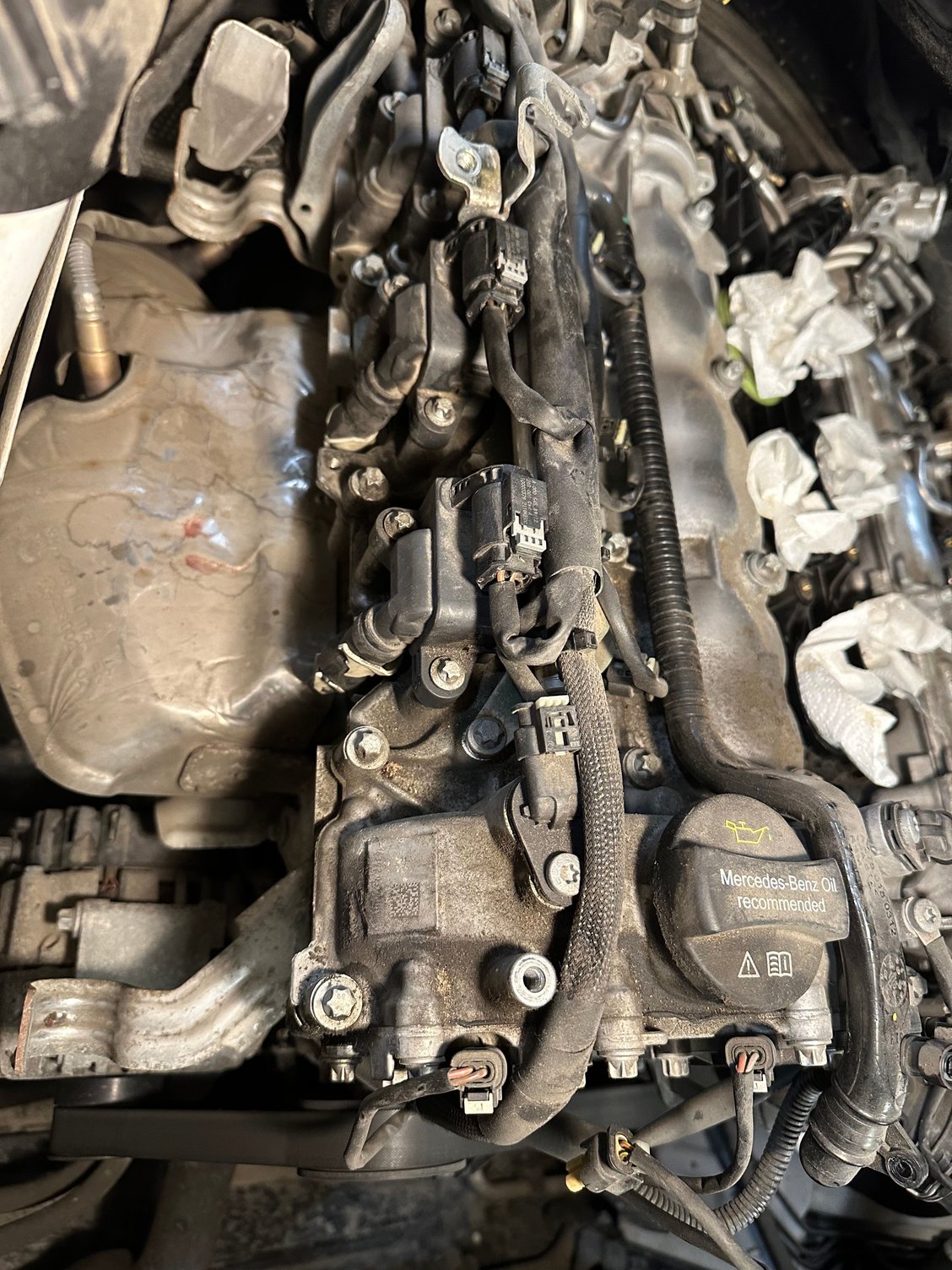

Can you post a photo? Do all 6 coil connectors look identical?
Do you have connectors that look like the ones in these photos: https://mbworld.org/forums/gle-class...ml#post8571680

Old Dec 1, 2022 | 11:06 PM
ccrobin's Avatar
Joined: Feb 2019
Posts: 146
Likes: 43
2013 GL 450, 2020 GLE 350
not a great photo, but the coil sits directly above the plugs and is held in place with 2 bolts.
yes, look like the photo on the link you shared.

It might be the photo, but it looks like the grey latches are not fully latched. This may or may not cause misfire, but to rule out bad coil connection the connector needs to be fully seated and latched.
Are you completely clear on how the connector and latches operate? They are tricky when first learning them.
Old Dec 1, 2022 | 11:11 PM

I see what you mean by latched now. I’ll check that in the AM and report back. Thanks a ton for your comments to assist!

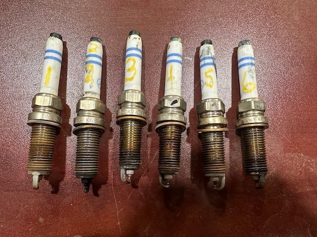

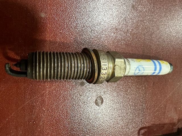

So it's been a few days. I finally was able to get back to it. I replaced all the plugs (#2 was definitely fouled), swapped all coils over 1 cylinder, changed the oil, and put it all back together. Same issue. I also ensured the coil was firmly seated and connector tight and latched.
I did a little more troubleshooting with Xentry, and the only issue the quick test comes back with is a cylinder 2 misfire. I cleared the faults and re-read to ensure. Code came back right away (within 10 seconds of starting the car). Attached here is the freeze frame data, a new compression test, and the fuel injector performance data retrieved from Xentry. Most of the data on there means nothing to me, so hoping someone here may be able to help.
Also looking at the "Actual Values" section of Xentry, the only 2 things I was really finding out of range was "Uniformity of lambda control of right cylinder bank", which had a value of 1.74 (specified value should be less than 0.80). The left bank was fine reading a value of 0.30.
The other issue was the rail pressure, which was was reading 201.0 bar (value is specified as 200.0 bar).
I'm at a loss to know what to check next. I suppose I could try a valve seat cleaner as garysymons suggested - though I am afraid to really run it long with the misfire. How much do I need to worry about causing damage with this?
Also, in case this helps, when running at idle, when a give it a little gas it sounds like I can hear rushing/sucking air briefly before the RPMs kick in. Could this be a vacuum leak of some kind?
As always, any ideas are very appreciated!

Fouled plug means incomplete combustion which means insufficient spark or too much fuel.
Are the plugs and coils OEM MB parts?

So I performed the upper engine clean and added lucas injector cleaner into the fuel. No change. I took it for a 10-15 minute drive after the cleaning - MIL never went off, and had noticeable vibration in the 1500-2000 RPM range when under load. It also runs rough at idle. I also hear what sounds like little pops after revving a bit (as the rpms decline) - I suspect maybe little backfires?
Sadly the Indys near me are all 2-3 weeks out to even look at it. It will really cause some problems for me if I can't get it resolved sooner - though I'm at a loss for what else to check.
I also can't get over thinking there is some sort of vacuum or seal that may be the issue. The short "Fffffffft" sound I hear when I give it a little gas (the split second before the revs start to build) just doesn't seem right - and when it is running it seems more than just running rough - it seems louder.
No other codes are showing in Xentry though, and checking all actual values within Xentry also seem fine (with the exception of the "Uniformity of lambda control of right cylinder bank" and "Rail Pressure" which I mentioned earlier).
In case it gives any better insight, I have attached photos of the old spark plugs. You can see #2 is noticeably fouled compared to the others.
I read the data files, they don't help except to say there is a misfire. Compression test is OK, strangely cylinder 2 has the highest value.
