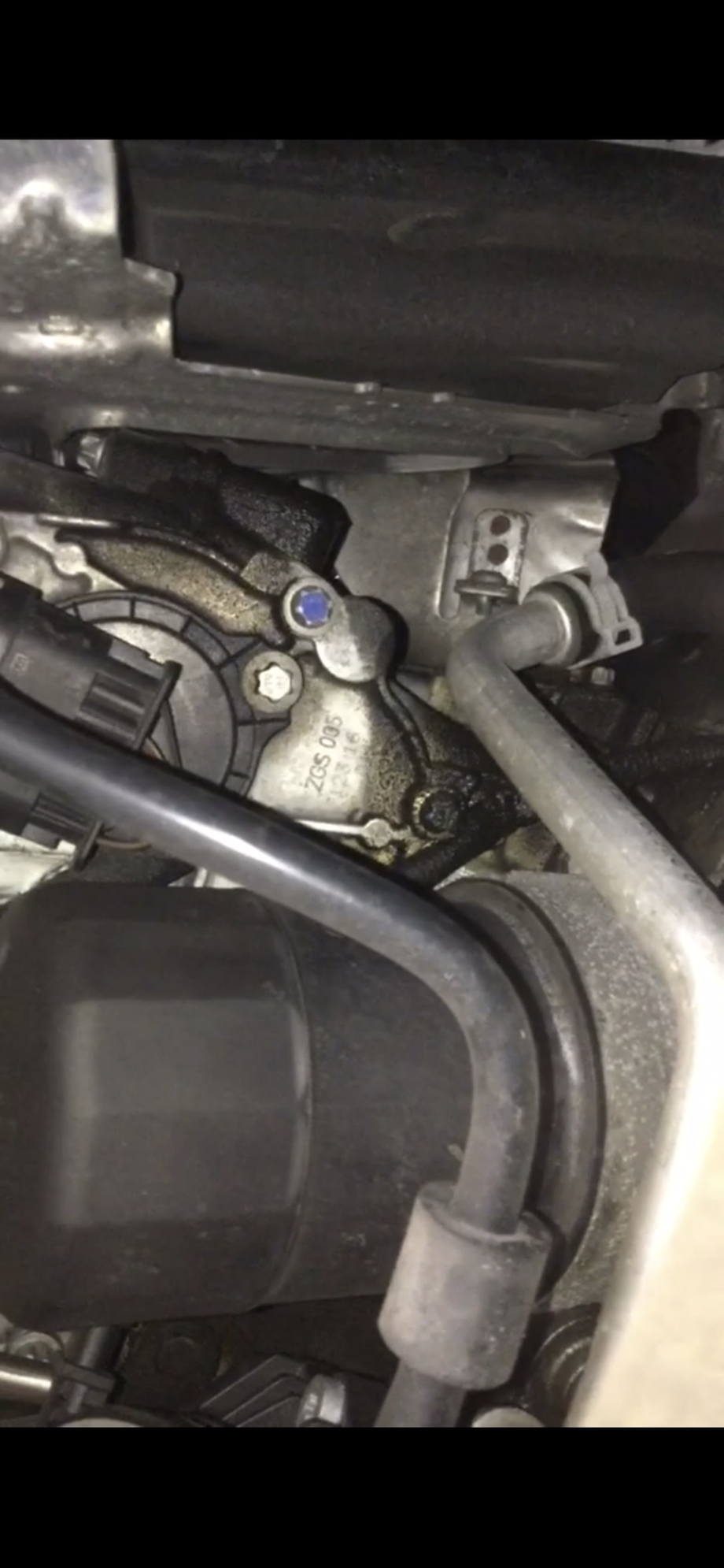

anyone has any idea where is leaking coming from? any cost and fix ? thanks

Normal and widespread leak. Factory defect in the sealing of the front cylinder head covers. Fixable by the dealer. Tricky project to DIY.

HI, FROM THE INSPECTION VIDEO, TIRES/BRAKES ARE GOOD, FRONT COVERS OIL LEAK - RESEAL/REPLACE $1650+tax. Do you think independent shop can replace front cover at less cost ? Or anyone one has wis ?thanks

Indy = less cost, yes
Not sure if WIS for this job is posted on this site.
It’s tricky because of low torque aluminum screws, careful cleaning of the magnesium parts without damaging them, and special MB adhesive (no gasket).

Before spending $$$$, wash the area and wrap with paper towels to pinpoint the leak.

Like Chassis said this was a defect form the factory on the left and right bank. When you take it off, clean it before applying the new sealer. I'm waiting to do my serpentine belt. I think this is the best time to do it. I'm not sure if you can reuse the same bolts are you need to get new bolts.
If you can't do the work. I would take it to indy shop that specialize in Mercedes

Screws are single use aluminum. Must be replaced. Very low torque spec.
