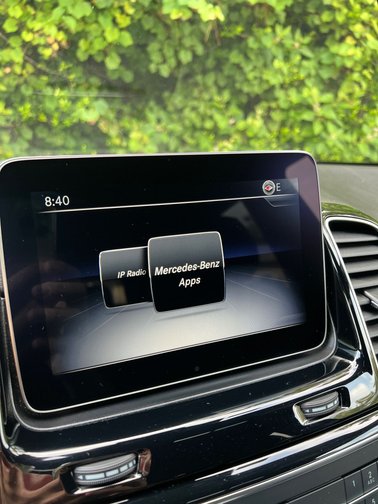

Cannot set up internet
I went through to all settings related to internet but didn't get it.
Could you give me advice? (Wi-Fi in the car is enabled)
