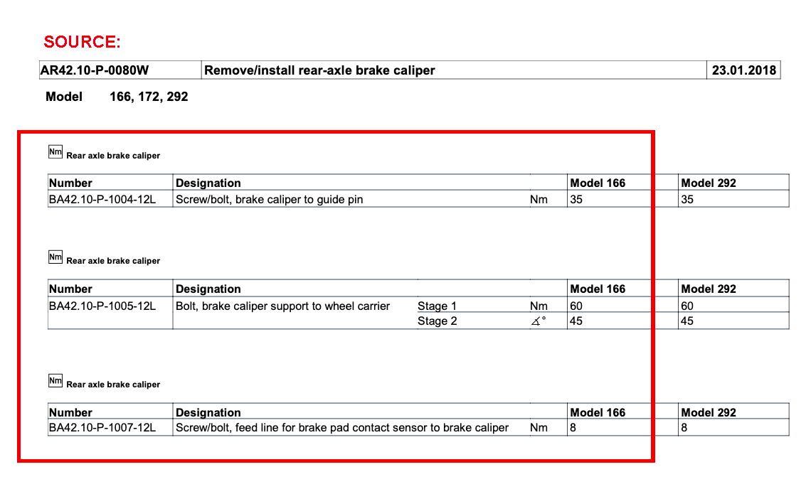

Nov 19, 2023 | 12:22 PM
Quote: A kind soul that can help me lease . Please list the Mercedes torque specs for my 2016 GLE 350 w166. I have tried to find them and my result was filled with contradictions.
Front Brake Caliper Guide Pin:
Rear Brake Caliper Guide Pin:
Front Brake Caliper Bracket:
Rear Brake Caliper Bracket:
Thanks much!
I have the rears (BA42.10-P-1004-12L)
  • Screw/Bolt, Brake Caliper to Guide Pin: 35Nm
  • Bolt, brake caliper support to wheel carrier: Stage 1, tighten to 60Nm. Stage 2, rotate an additional 45°
  • Screw/bolt, feed line for brake pad contact sensor to brake caliper: 8Nm
Reply 0

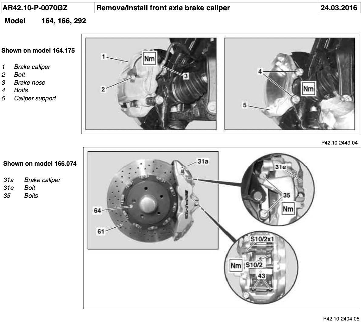

Nov 21, 2023 | 11:28 AM
Found the fronts.
