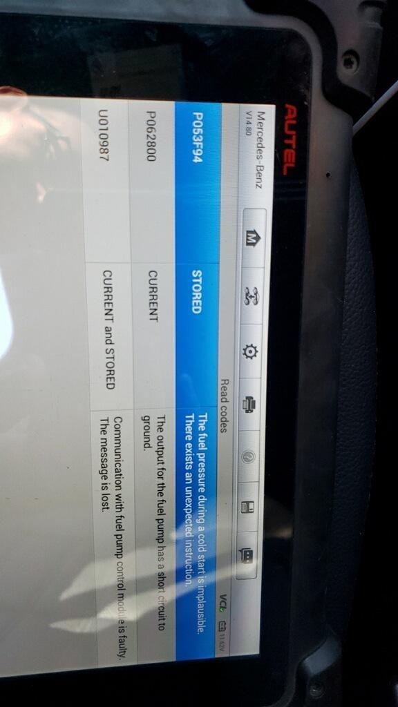

Had this issue with my 2016 Mecerdes GLE 350. It was raining for a few days. I started up the truck fine. Drove to the gas station. Pumped gas drove 20 ft and the truck stalled. I had to tow it home. My mechanic checked it out.
Informed me that water gets in through the trunk and shorted out a fuel pump module. Now Mercedez doesn’t have a recall on this vehicle but it does have a Technical Service Bulletin on how to repair the issue. So they are aware in occurs.
At this point they want me to pay out of pocket for repairs but shouldn’t this be a manufacturer defect? Shouldn’t they cover the cost. Vehicle is at 63,000 miles out of the 50k warranty.

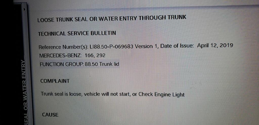

Mercedes Benz is aware of the defect of these vehicles 🚗. They have a a service bulletin out on how to repair the issue. BUT !!! It is not a recall yet so your out of luck. You have to pay out of pocket for the repair. You can file a complaint with consumer protection government offices.. if the number of cases increase it could help the recall become reality.
what I did to remedy the situation I took the plastic cover out opposite of the button where one closes the trunk. The same size and dimensions as the trunk lock button... and after any car wash or rainfall.. I will open the trunk door and drain the water out from the door.
surprisingly the trunk door acts like a water tank and fills up pretty nicely... Till it’s starts pouring into the spare tire compartment.
by taking the plastic out and draining the water out I think 90% of the chances of it occurring again.

This is interesting. The X/W164 platform has well documented taillamp gasket leaks, leading to water damaging the rear SAM. Is the water entering through the taillamps?
How does water enter the liftgate? What is the leak path?
@pmercury @konigstiger @Maj. Dundee Are there any sources for TSB documents? LI88.50-P-069683 Version 1

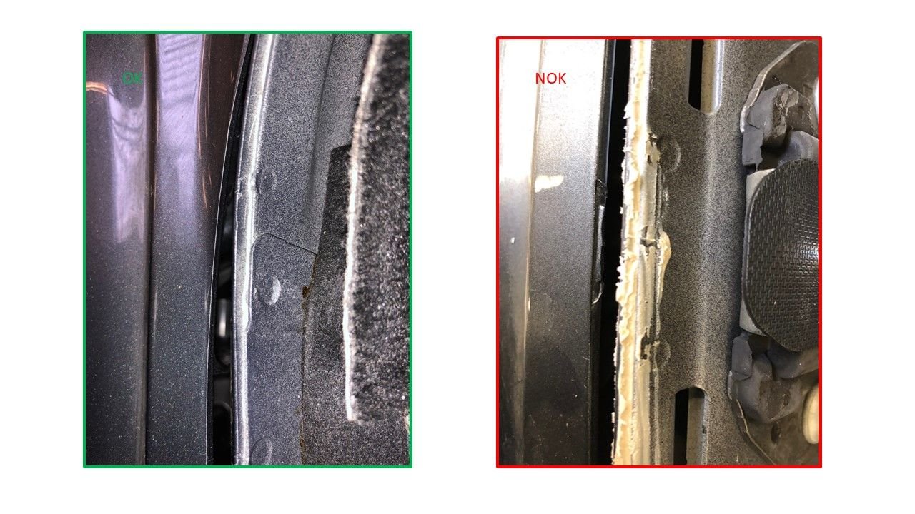

Hey guys, I have just experienced the same issue you all are writing about. I have a 2016 GLE 350. Vehicle stalled in traffic and could not restart. Towed to the dealer. Found it was the fuel pump control unit. This had gotten wet due to leakage from the rear trunk seal. They replaced this after allowing everything inside the wheel well where the spare tire is kept to dry out. Also replaced the fuel pump controller. Cost $1106.00 but after complaining to MB Corp. they brought the price down to $300.00. Unfortunately I believe the repair is poor. The seal where it connects to itself on the bottom is glued together and I am uncertain how long this will last. Not happy. Am bringing it back to them for another look at this seal because it looks like it would easily open up again if I dragged by grocery bags across it. Do I need to check my wheel well for water before every drive? Please let me know if you all have further insight to this issue. Thank you.
@myc52k sorry to hear about the situation. Do you have a photo of the seal before it was replaced? I am still not clear on how this fails. Is the original 2016 seal not joined together, but rather butted or overlapped? The 2017 seal is butt-welded rubber. It isn't the best design, but so far after 62k miles and 4 years it is holding up.
Looking at EPC, liftgate seal part number A1667400178 appears to have no revision history, therefore no part changes have been made for the GLE model, or possibly for W166. The seal is one continuous piece surrounding the liftgate opening. It looks like it was two sealing bulbs.
Where/how exactly does it fail? Can someone please post a clear photo showing the seal failure? The photos in post #6 don't fully give the idea of root cause. I'm not envisioning the root cause here. It seems like the seal is slipping off of its mounting flange, and not tearing or coming apart. Is this correct?

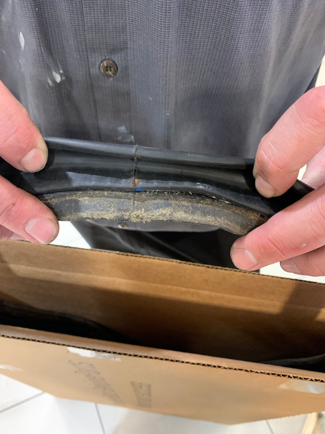

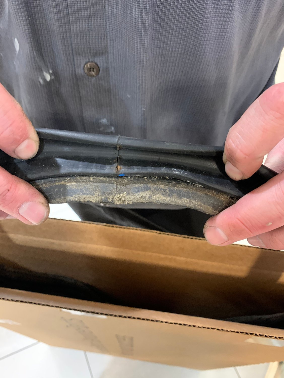

Old Mar 24, 2021 | 09:48 PM
myc52k's Avatar
Joined: Mar 2021
Posts: 8
GLE 350
Pictures
This is the seal that failed.
Another picture of seal that failed.
This is the new seal, with the joint at the lower part of the rear door.
Let me know what you think?
Thanks @myc52k Did the seal split at the joint? Something to keep an eye on.

GLE 350
Yes that is what I am showing in the first two pics. The new seal unfortunately is joined in the same fashion at the lowest point on the door. I tried to get them to do it differently but they claim that was against policy. The loaner vehicle, which was a GLC 300, had the joint on the upper portion of the right side of the door opening. This location would likely have less chance of trauma from grocery bags, suitcases, dogs and bikes. You can’t expect to do the same thing and have a different result!
Agree with you or idea to turn the seal in a different orientation. Is it molded into shape, or is it easily moved into a different position?
Having the weak link (the seal joint) at the top may be risky as the water exposure would be highest at the top. Mechanical damage/abrasion is worst at the bottom. Not a good design and the fixes seem limited.

GLE 350
It looks very flexible to me but I could be wrong. Agree that the best place would be at the side. I looked at my friend’s Toyota SUV and his seal is one piece with no joint at all that we could see. Seems like a better solution.
