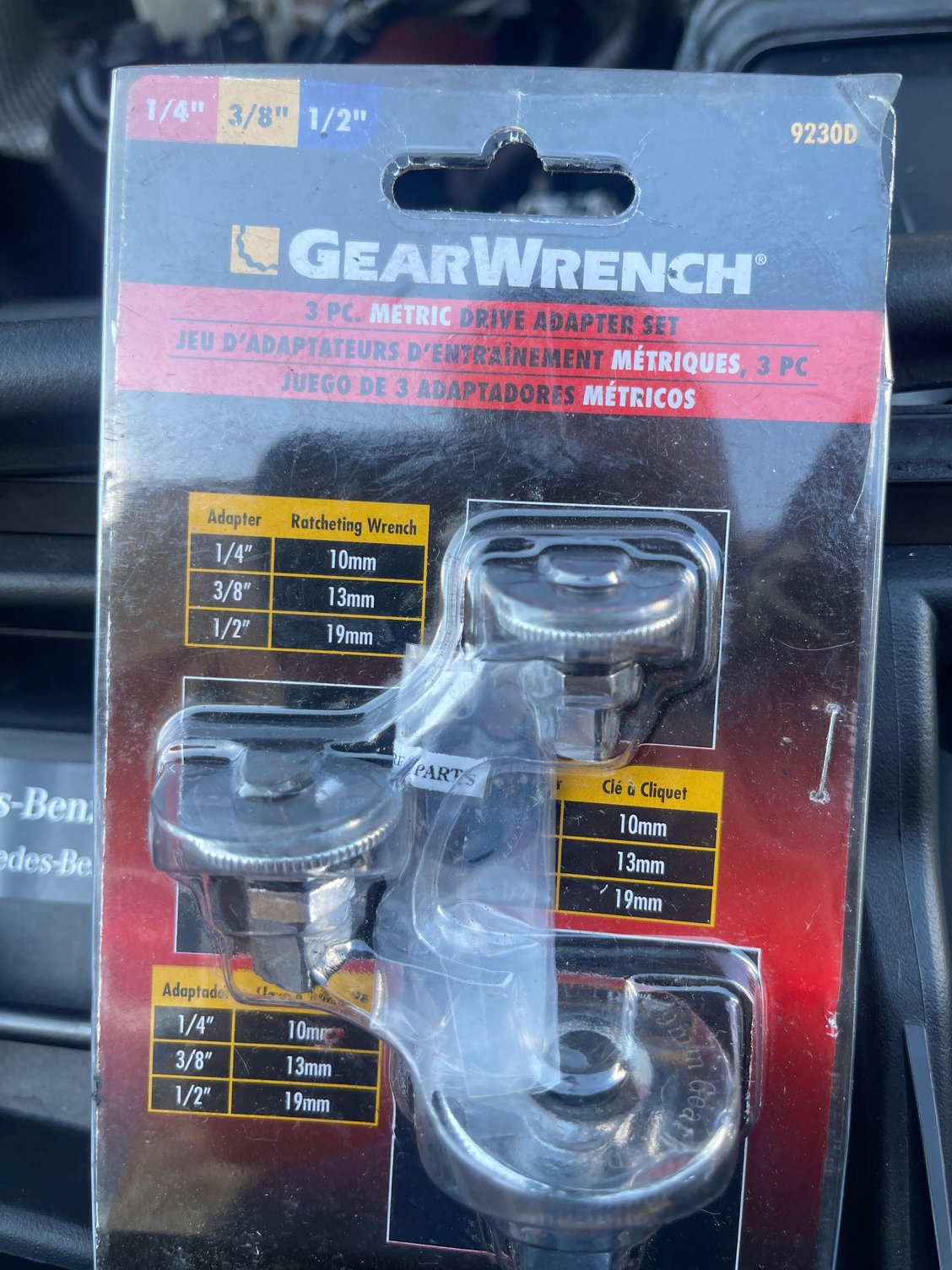

I got it on without touching the intercooler. I had to cut the old belt because it snag on behind the crank pulley and could not free it. Took me hour and half. My friend tool saved me to get clearance I need between the intercooler and tensioner bolt.

The only tip I can give you is you need two people for one person to feed the belt behind the intercooler and the other person to fish it out. I recommend putting the belt onto the crank pulley first because this is the hardest one and the tensioner pulley is the last one but when we got it on all the pulley my friend was releasing the tension pulley while I had the belt on the edge on the alternator pulley once he slip the belt onto the tensioner pulley I slept the belt onto the alternator pulley and before he release the tension we made sure it was lined up on all the pulley.
I did use a interior panel plastic car trim pry tool to push the belt through and a pick and hook tool to grab the belt from the other side of the intercooler to pull the belt through. You will need a 17mm socket to release the tension
I used the 13mm adaptor on a 13mm wrench and a 17mm socket. Do not attempt to put a 17mm on a ratchet you can release the tension but I had to fight it to remove the ratchet/socket after I release the belt due to the clearance issue with the intercooler. This is why recommend using the wrench, adapter and the 17mm socket.
