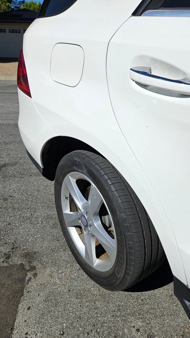

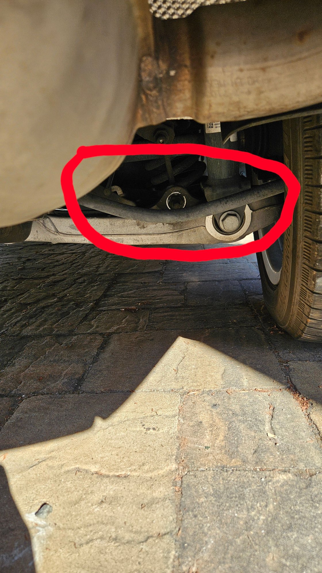

I got rear ended;someone hit rear passenger wheel under 15 mph
I see wheel is tilted outward and notice this component is bent compared to left side rear wheel.
What does it call and is it going to be easy fix?

Maybe Lateral Arm, Rear Tie rod. I can't tell where the other ends are mounted to to be 100% sure while looking at that photo. It can also be rear sway bar or it's other component.

I can't see your photo for some reason but here's a link to the EPC rear suspension that should help you out.

It was tie rod.
Hope this will fix alignment.
