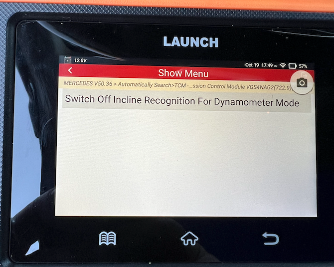

I need to check mine. I suspect not all menu items are available on all cars.
Apparently, I am correct. I have a 722.9 7G+ transmission and it does not give me those options. The only one under Actuation is the picture below:

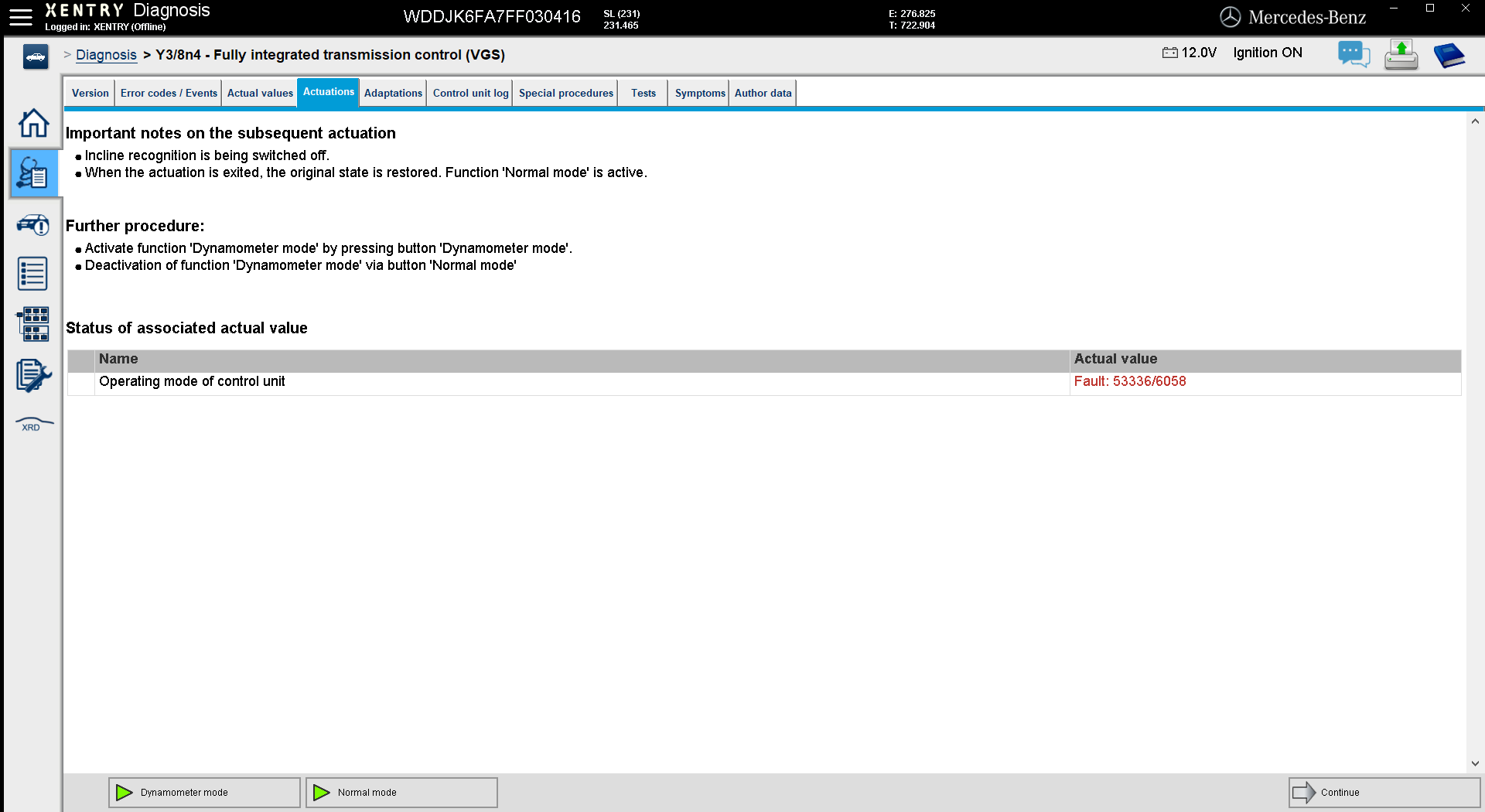

Same thing in XENTRY. (Same Dyno related message, just a different translation.)

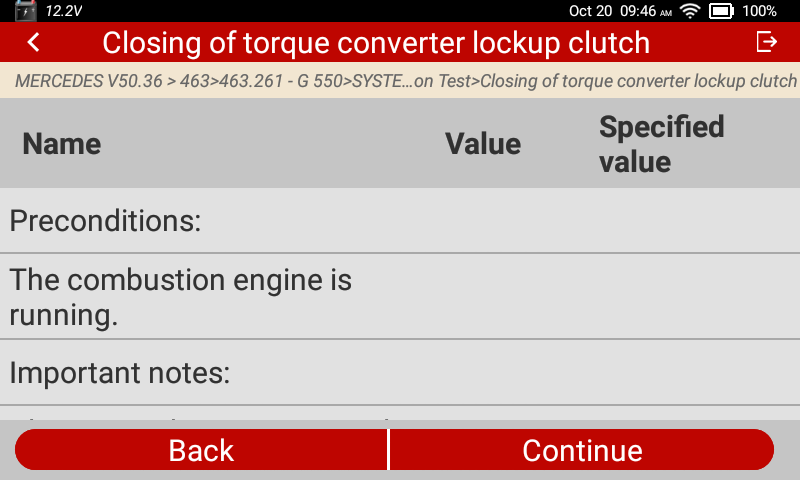

FWIW, here are the Launch screen shots from the menu I reference in #3 above. (BTW, one of the advantages of the battery powered version of the Launch scanner is the ability to capture screen shots and email them to yourself later.)
The first screen appears after "Activation", and the following 3 screens appear after selection of "Oil level check", "Valve flushing", and "Torque converter lockup clutch". These last 3 screens extend beyond what is shown by scrolling up on the scanner, where subsequent actions are presented.
Sprutz12 -- will you post your experiences with this and let us know if all goes correctly with the Launch scanner? Hope all goes well!

Originally Posted by streborx
FWIW, here are the Launch screen shots from the menu I reference in #3 above. ...
Thanks for the screen shots. Clearly, they are for the 9G and not available on the 7G trannies.
