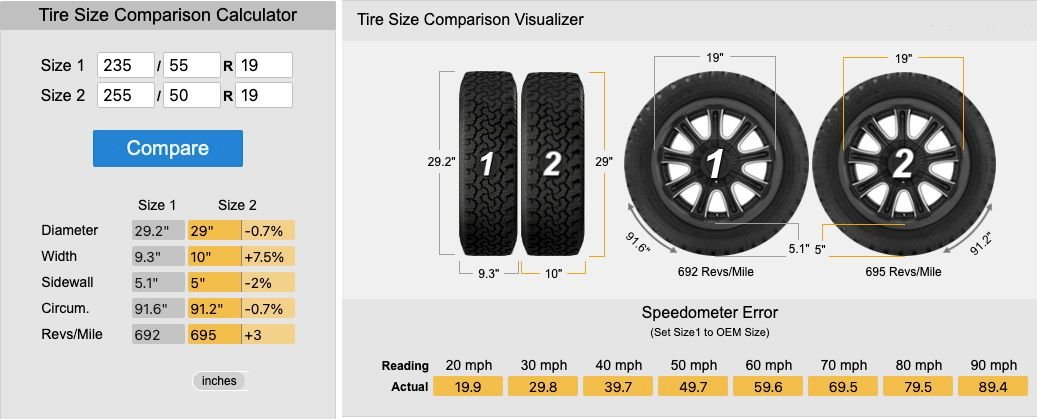

Generally speaking, if the lug bolt pattern is the same, and the rim width, offset and backspacing are the same, it's no problem at all. You'll also have to consider overall tire/rim diameter to ensure an accurate speedometer and odometer.
I grabbed this screenshot from a tire comparison website
so based on your ss, you think its gonna be suitable yeahh?

You have to check offset of that rims...
ET number compare
