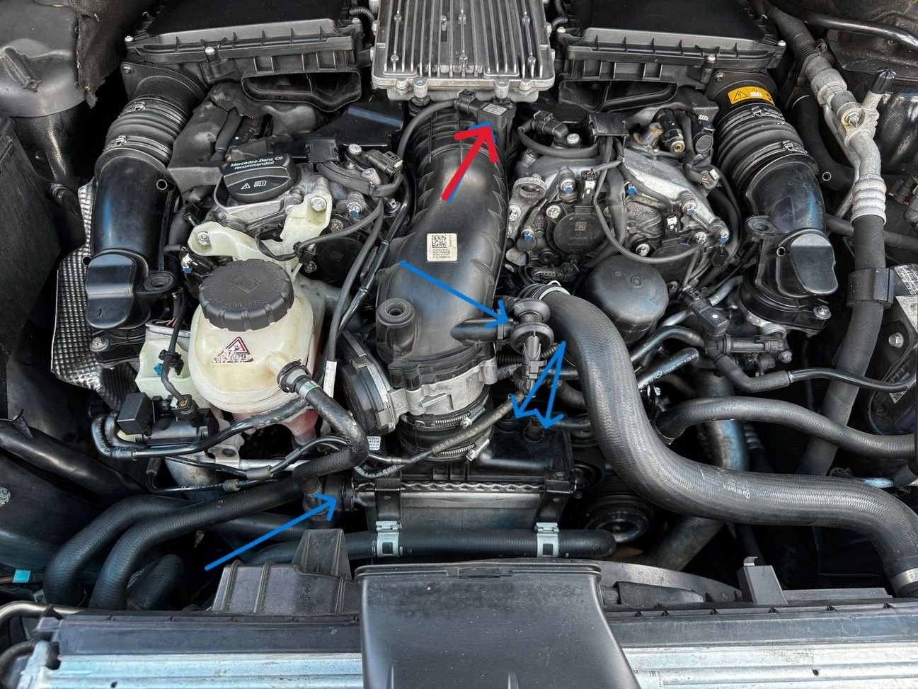

I have almost the same issue with 2018 GLE 400 -- while stepping on brake to slow down in city drive, the RPM jump to over 2.5K (idle rpm=0.5K). I have not pin point to the defective part(s) yet. Usually, it's up or down a bit is okay and should be less than +/-0.5K rpm. Correct me if I am wrong, anyone.

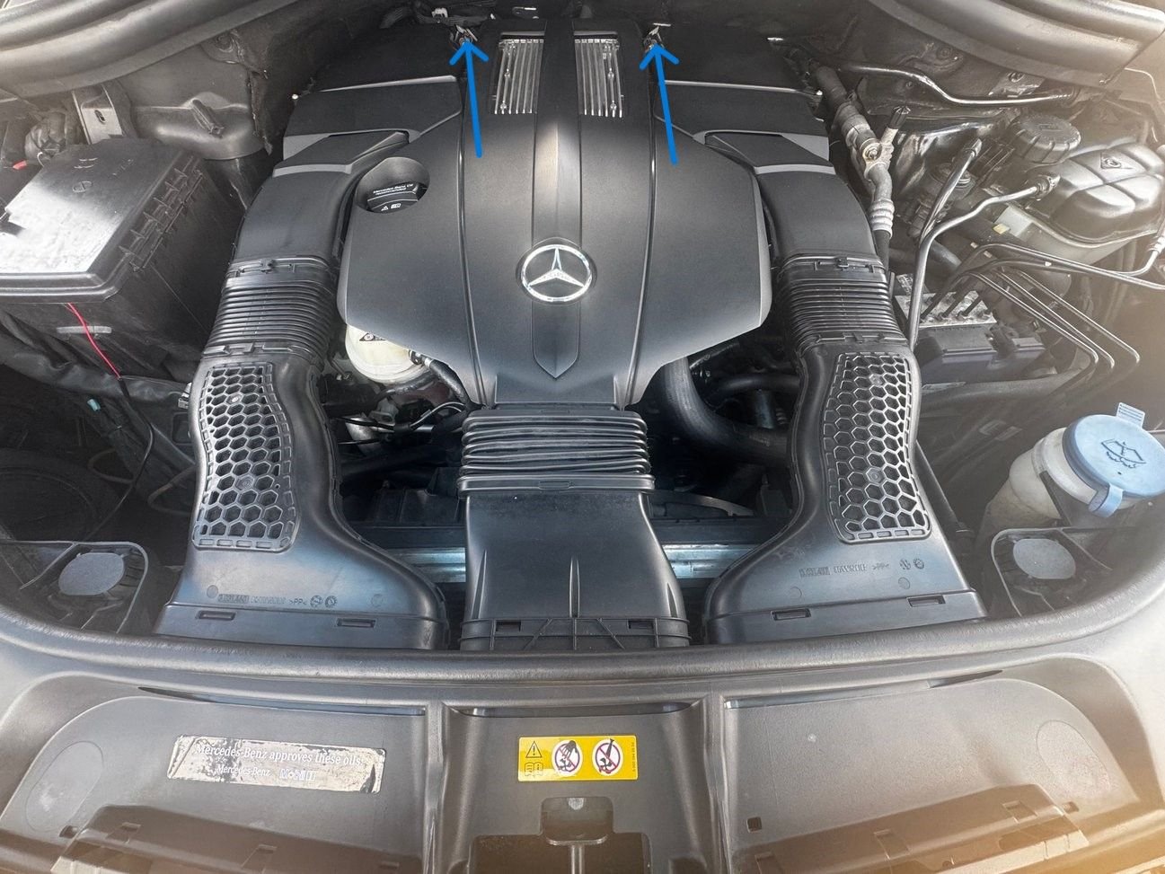

I belief this car doesn't have MAF (mass air flow) sensor. It has MAP (manifold absolute pressure) sensor instead of MAF. I just checked and inspected all the usual suspects -- engine air filters and its sensors (image1), MAP sensor (red arrow), and the two turbo air intake pressure sensors. I did not see any unusual. I have not cleaned the sensors yet, since I ran out of the MAF sensor cleaner. I just replaced engine and cabin filters in the Summer. I will diagnose in the Spring. Right now it is too cold for any indoor/outdoor garage work in Toronto.
Anyone has any ideas or direction would be appreciated.
