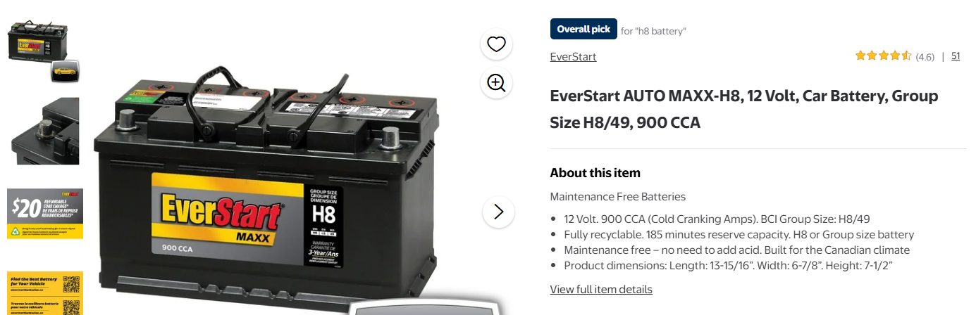

It's true -- easier to deal with SA than unhappy wife.
1 even put to sleep, it may still drawing some currents and battery drops/degrades charges over times
2 may consider battery switch for long term park/under use car. Connect to negative pole at the battery -- under passenger's seat and easy to access to switch on/off.
3 new/2023 battery is not by default is good/healthy battery
A few weeks ago, I removed and returned Energizer battery made in German from Costco ($430) that I installed in April 2025. Replaced with EverStart made in Austria from Walmart ($230).
Reason: ECO stopped working a few months after installing the new battery -- (Aux battery replaced in 2023 by MB dealer under CPO warranty). It's hard to start when outside temp drop below -25C/-13F. It requires 39A to charge/high resistance. EverStart needs only 9A. ECO is working again for now. The time will tell.
