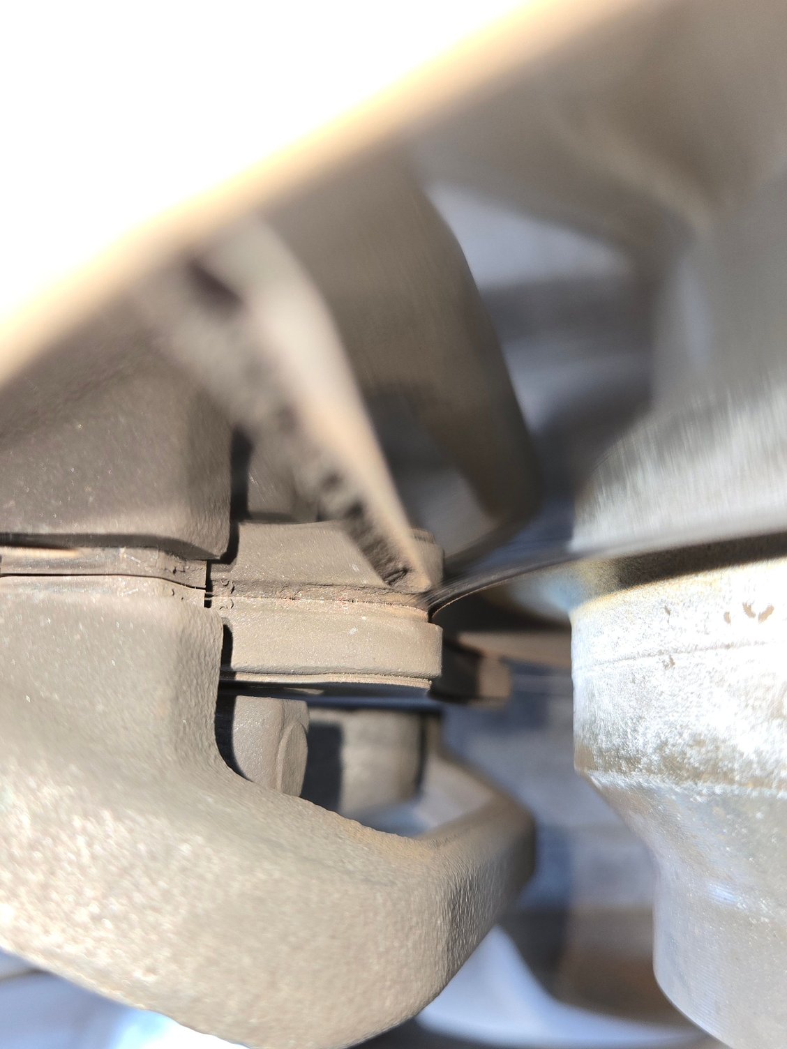

Wheel off. Insane amount of wear. Inside pad looks the same. Both sides have equal amounts of premature wear.

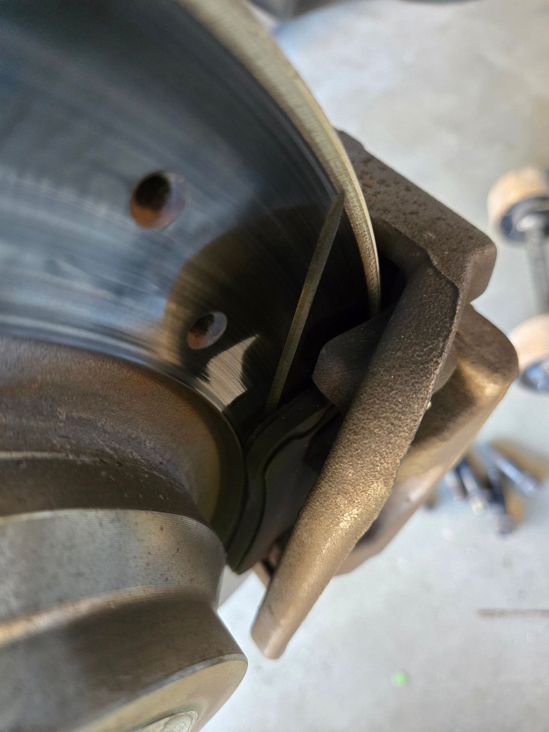

Uranium238's Avatar
Joined: Feb 2008
Posts: 224
Likes: 24
1987 Porsche 928 S4, 2009 Mercedes E350, 2011 Mercedes GL450, 2003 Mercedes ML350
Driver side rear. As mentioned same amount of abnormal wear.
Old Mar 2, 2026 | 12:32 PM

They definitely are the new ones. The backing plates look brand new still compared to the older pads which had surface corrosion.

CONFIRMED. Pads are on the wrong sides. I even see the damned sensor plugged in on the outer after washing the rear brake dust off!
