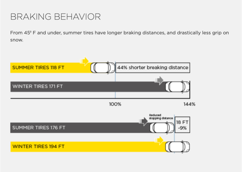

Check out this Pirelli Chart for a visual understanding of the differences.
From the above chart, It's very important to understand the Winter Tires is NOT going to make your braking distance any shorter from 62-0mph (100-0km) in cold and dry. Just braking in the opposite temperatures your tire is made for will damage your tires. Winter tires will usually stop much later on dry pavement than summer tires in the Winter as seen in Engineering Explained videos. When you start driving in wet, ice, or snow, everything changes.... hence the need for Winter Tires in cold climates.
