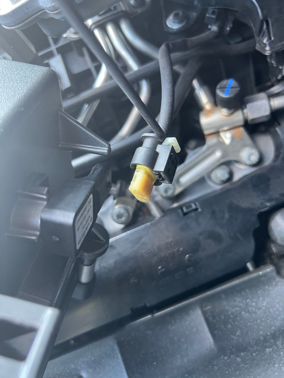

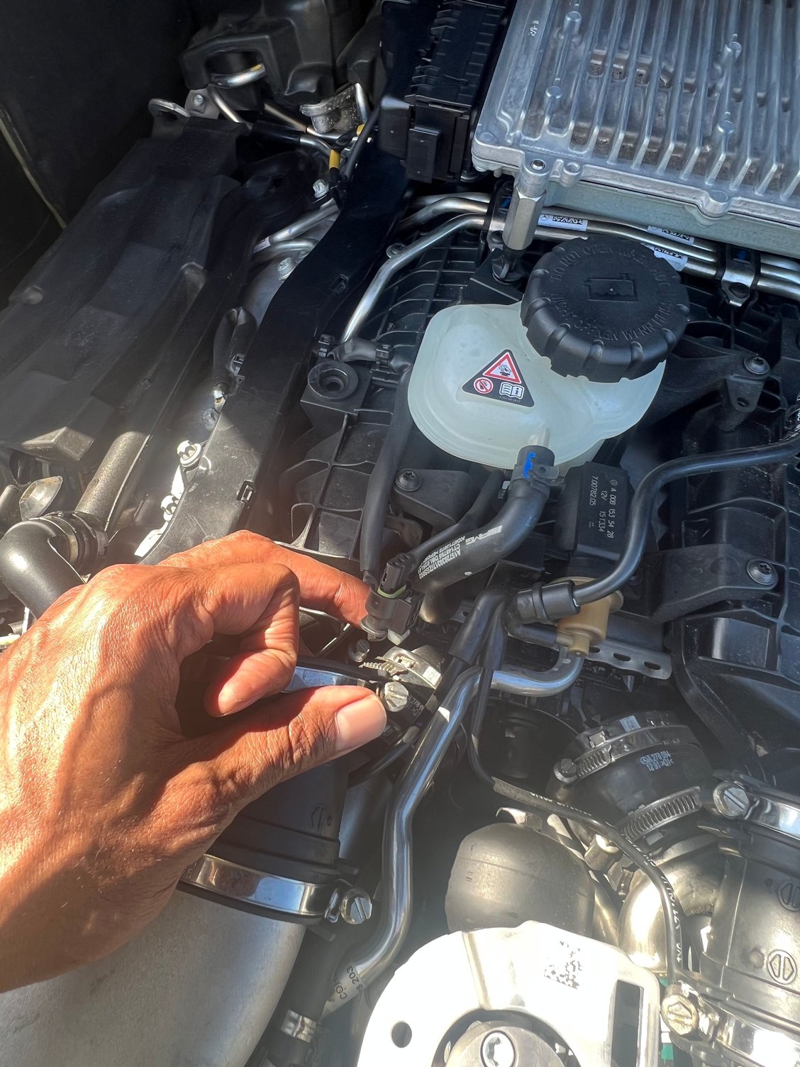

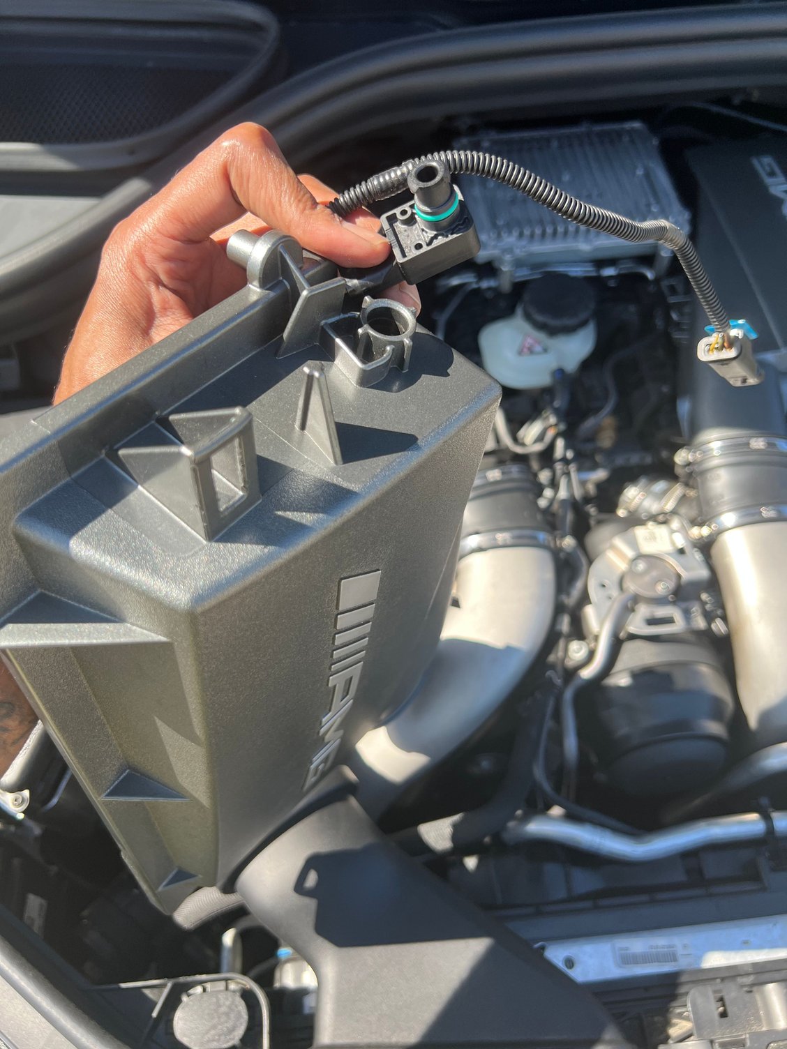

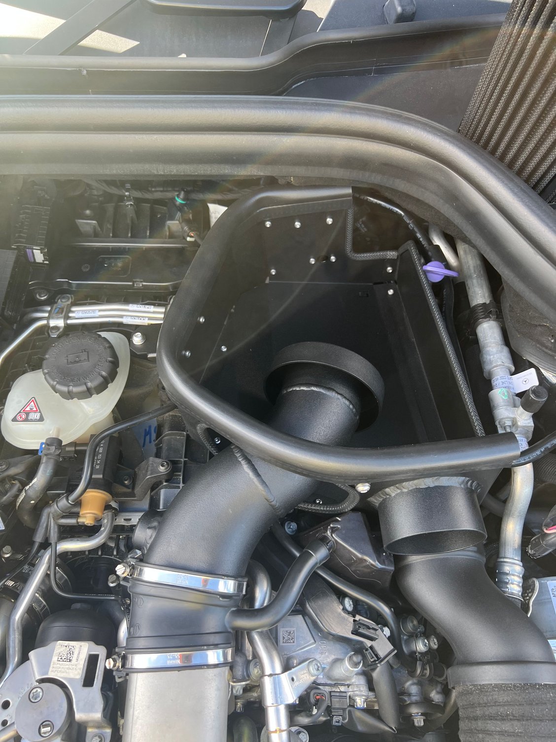

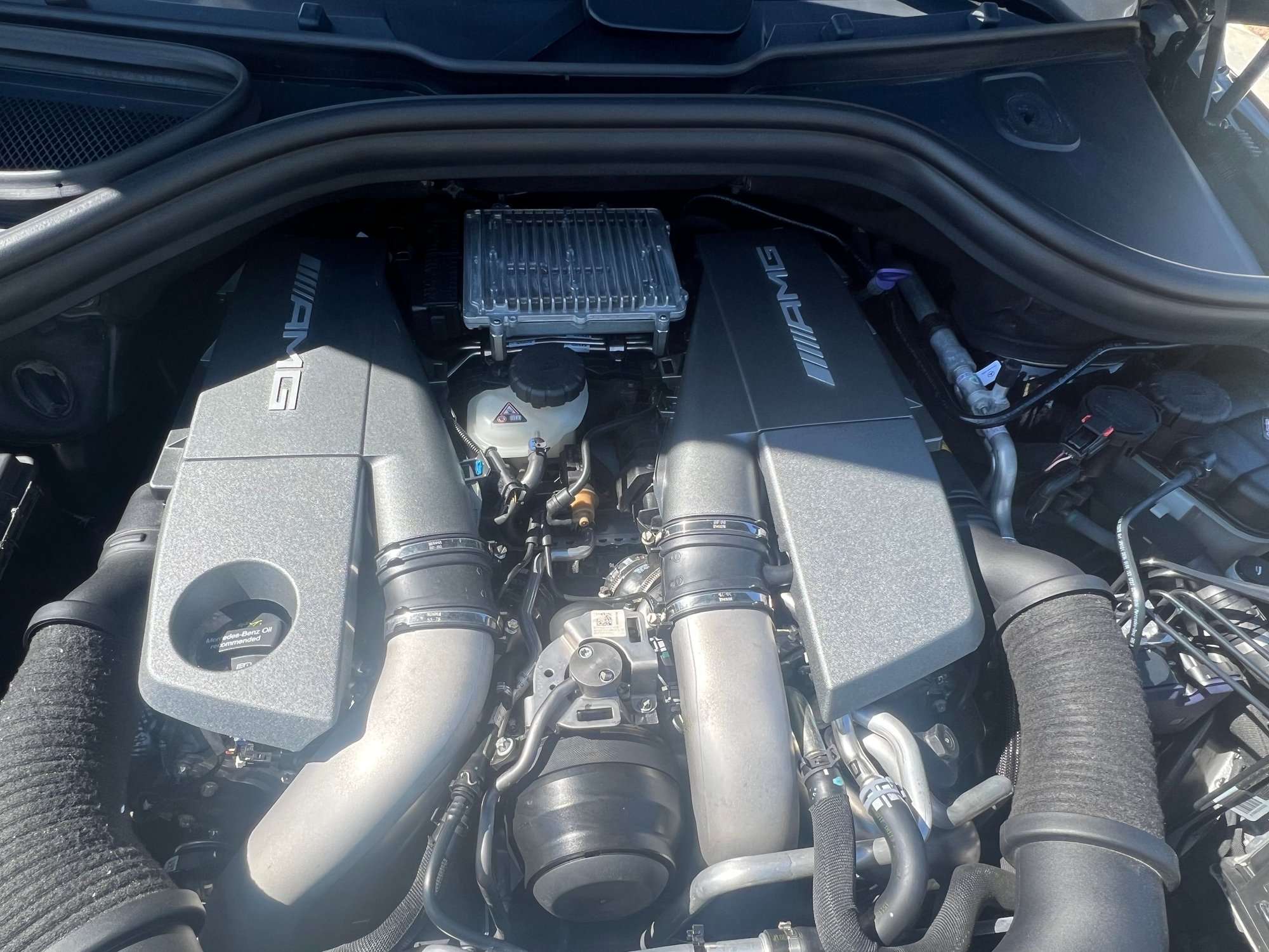

I received my Black Boost CAI did a test fit. Not complete instructions but will help get you started. Very straight forward. Haven’t tried putting on the engine cover yet. Will report back soon
How it started
Removed engine cover

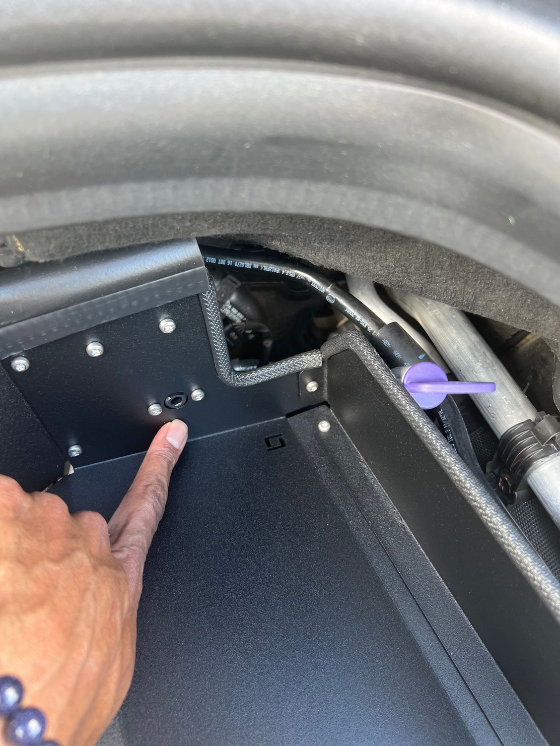

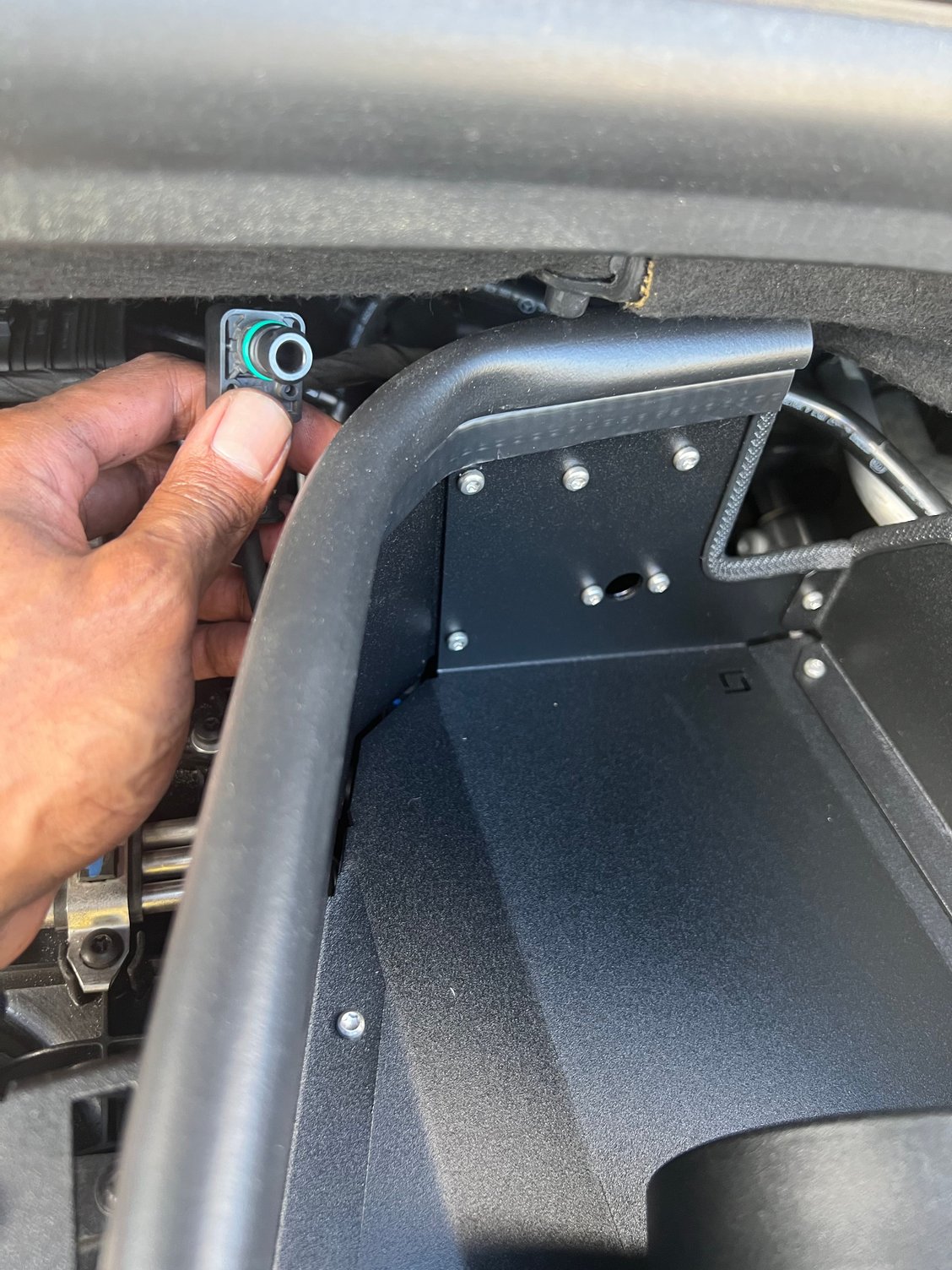

Removed MAP sensor
Sensor unplugged passenger side
Sensor unplugged driver side
Factory air boxes out
Use extension provided here
Put charge pipe and filter together
I did this one backwards and had to remove to put filter on

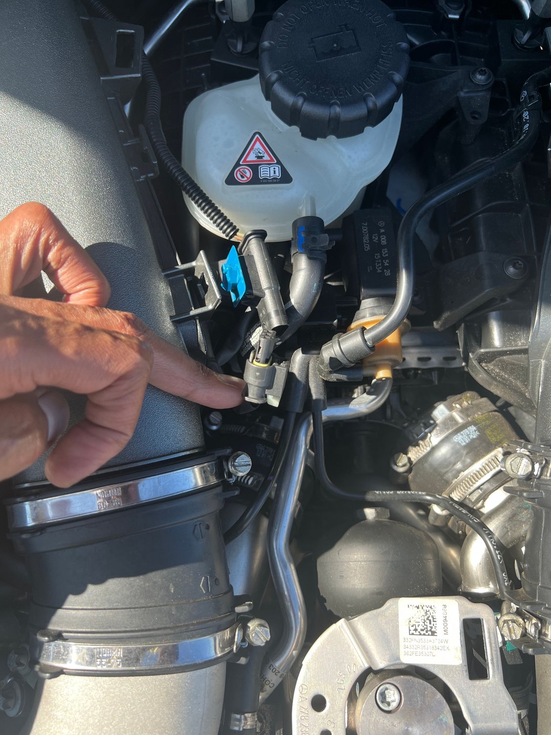

Driver side sensor in air box
Sensor plugged in

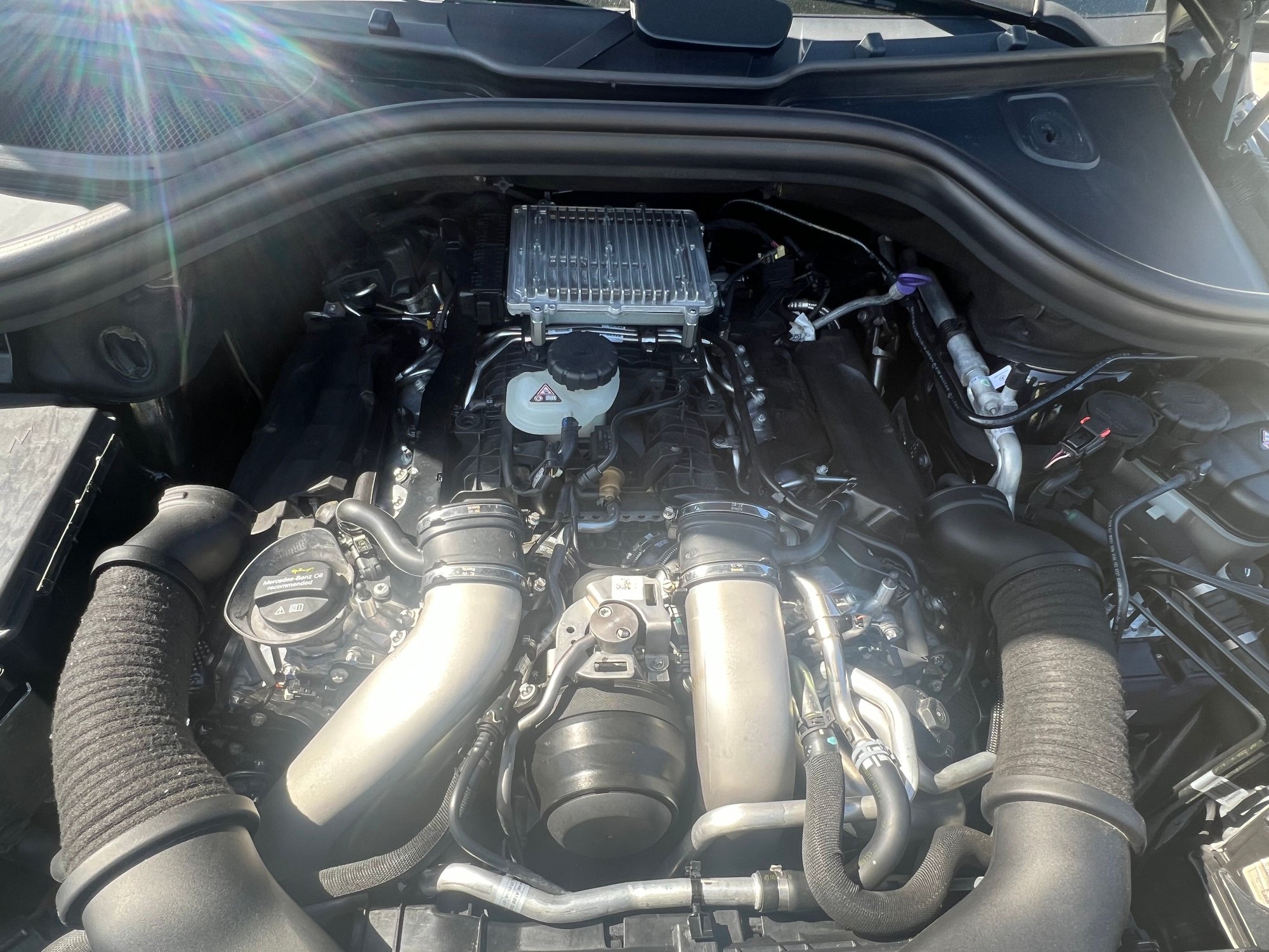

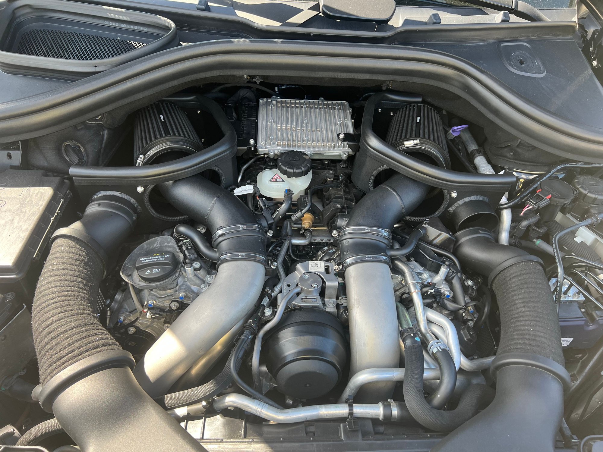

How it looks currently
No engine cover
Test fitting… praying for no CEL

Also put the sensors in the air boxes and use the supplied plugs for the charge pipes

Update

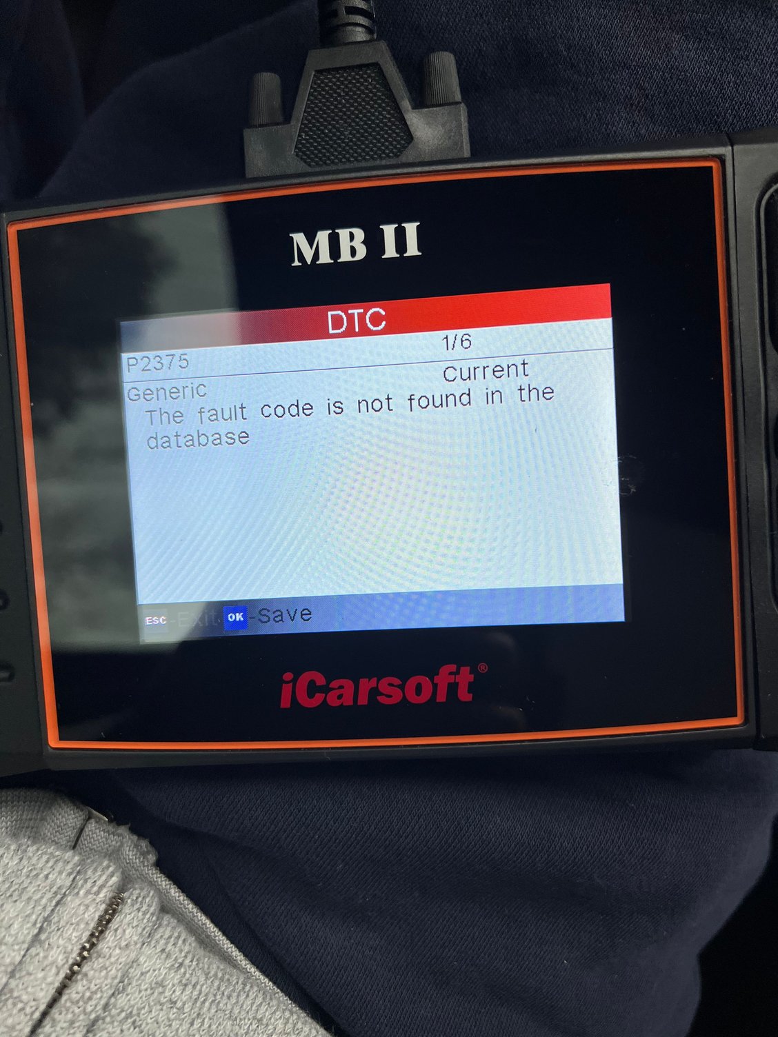

I originally placed the passenger side (PS) MAP sensor in the charge pipe. Driver side (DS) MAP sensor was placed in the air box. Drove a few miles (really just let it run for a few minutes) CEL came on.
I moved the PS MAP sensor to the air box and plugged the charge pipe with supplied part. Cleared the code with iCarsoft MBII (code doesn’t come back to anything). No CEL. Did a 0-60 pull and a 60-110 using the trusty butt Dyno. 0-60 felt stock, but I’m not tuned. 60-110 felt like having the air box spacers and racechip rs (I removed the racechip). 80-110 felt a lot stronger.
320 miles running 93 octane with 1 bottle of octane booster. I ran it non stop for 5 hours; no CEL.
Reached the city put it in sports mode and played with it. All good.
Just for kicks and giggles, I swapped the DS MAP sensor from the air box to the charge pipe. Ran a few minutes, then CEL.
An interesting thing I noticed with one MAP sensor in charge pipe readings for the IAT = 57°c. With both in the air boxes IAT = 62°c. I’ll be testing with both MAP sensors in the charge pipe and take some readings.

Code given

moved both MAP sensors to the air boxes, no CEL after 50 miles for stop and go traffic
Fitted the engine cover
