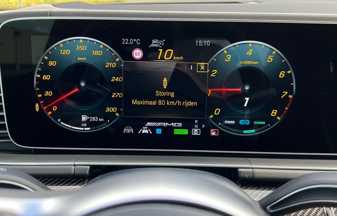

Hope someone here can help.
I performed a stage 4 tuning (turbo upgrade, transmission reinforcement etc) and its putting 967 HP on the wheels which is perfect.
However the GLE roadtrain is having issues with the weight / acceleration. Its on airmatic with AMG Active Ride Control bydeway.
What happens (mostly in 1/4mile kind of situations) is that during acceleration its giving a malfunction with spring icon as attached.

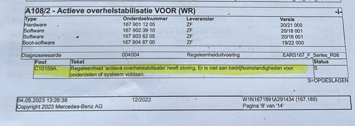

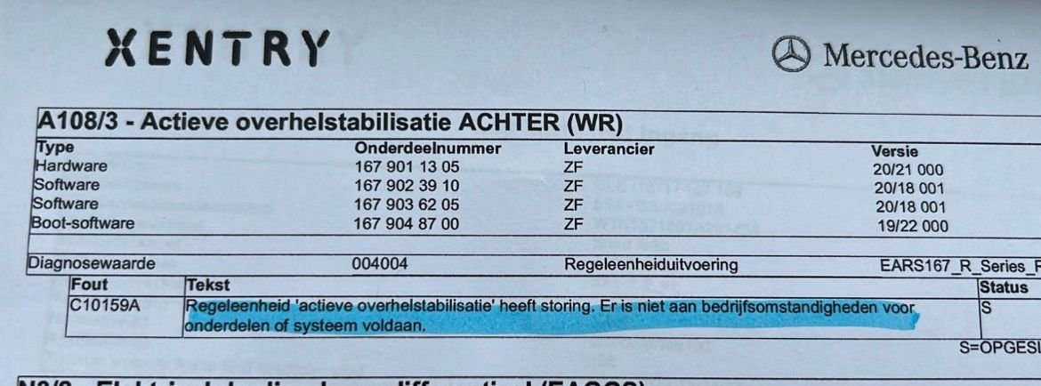

I figured out thats its an issue with the active roll stabilization. Seems no way it can be turned off. After a readout it gives the same error code on the front and rear axle but no hardware defect, its basically says its gone out of acceptable range for whatever some sensor is watching.
The problem is that i contacted several tuners but they don’t seem to be familiar with the issue or the codes..
Error code: C10159A
its giving part numbers for hardware which i would assume to be the sensors:
Front axle it says: 1679011205
Back axle it says: 1679011305

The error during acceleration in straight line
Back axle error
Front axle error

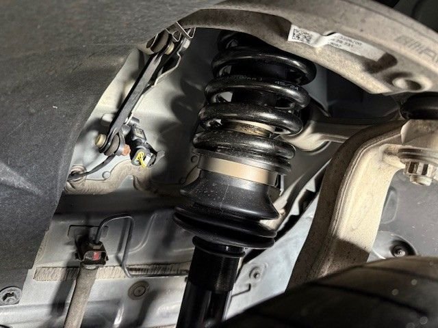

After a lot of testing with BenzNinja we came to the conclusion the issue was the Airmatic suspension, not the active roll stabilization.
The acceleration forces the suspension fully out of parameters.
Solution: Eliminate the problem
I went to INTRAX for a conversion from Airmatic to racing springs, custom-made to my setup. They specialize in custom springs and racing / F1.
As expected, the car now thinks there is no suspension at all.
