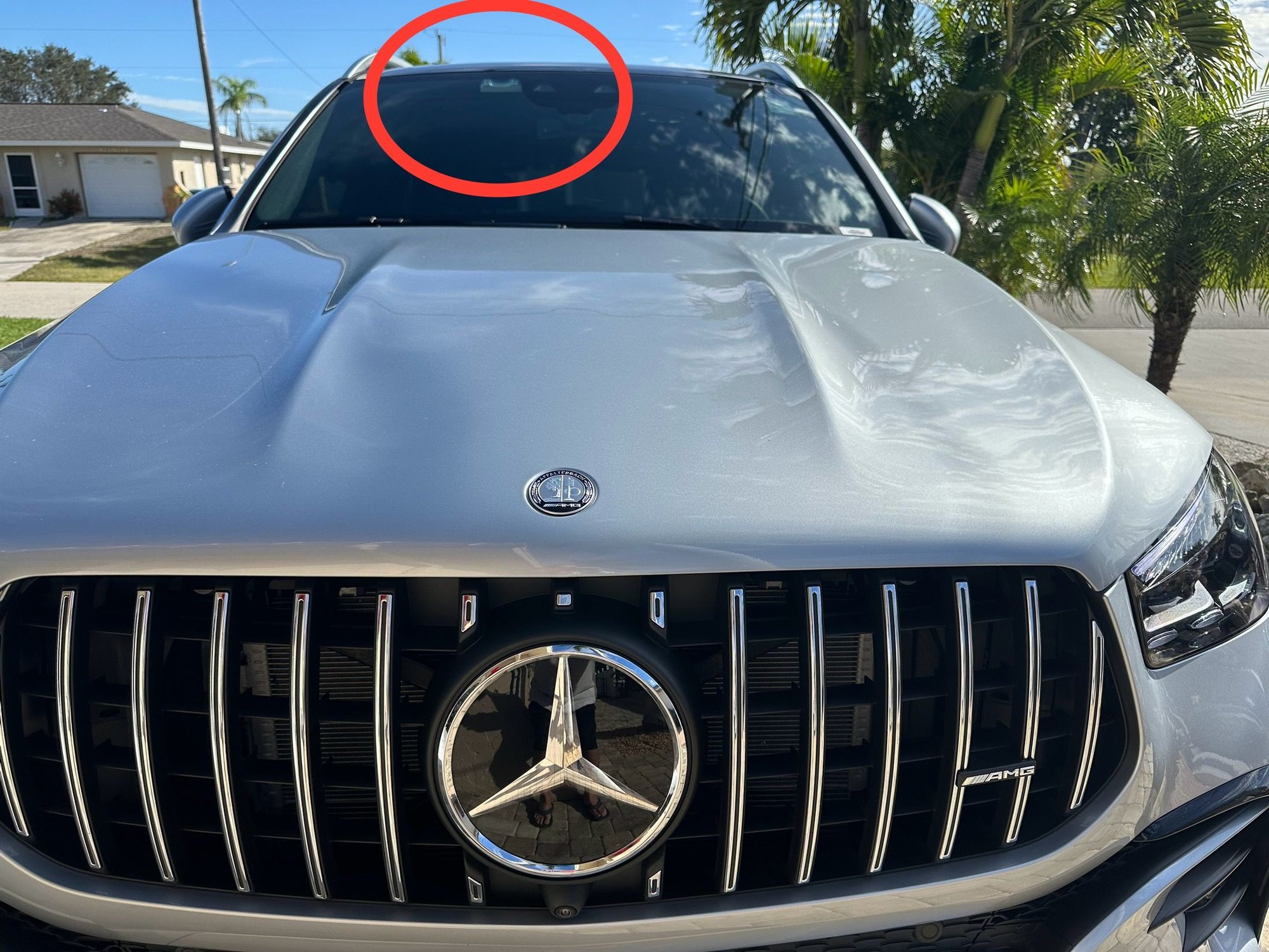

Here you go...2024 AMG GLE 53 from SWFL and daily SunPass user.
Just to the right of the rear view mirror - zero issues.

Dec 23, 2023 | 10:58 AM
Quote: I took delivery of my GLE 53 AMG Coupe and I am trying to figure out where to place the sunpass on the windshield. It has the winter package so it has the heated windshield, but it does not have the acoustic package. I was not able to find anywhere in the manual if the windshield has certain spots where it can go.
Does anyone know where the sunpass can go on the windshield or if it can go anywhere and still work?
Heated windshield? Or heated squirters?
The only windshield that I know of that restricts toll pass placement is the Acoustic glass. Use the instructions from Sunpass.

Dec 23, 2023 | 12:31 PM
@suby01 A sunpass is the toll transponder for the tolls on Florida roads (and I think some out of state too).
@TF_CC Thank you! That is where I put mine. I was not sure if this windshield was different and the manual was not helpful.
@mikapen My GLE 53 AMG Coupe has the "winter package" which has a heated windshield and a heated steering wheel. I was not sure if the heated windshield would affect the Sunpass.

Dec 23, 2023 | 01:07 PM
@makris0000 your Winter Package has a "Heated windshield washer system."
Not a "heated windshield."
You can put your pass anywhere in the glass you choose.
Just follow the sunpass instructions.
My toll pass provider suggested using the leading edge of the sunroof. I have put it there but I haven't run through any tolls to see if it's a good suggestion.
Reply 1

Dec 23, 2023 | 05:05 PM
Put a Motorcycle Transponder on Your Headlight
Quote: @makris0000 your Winter Package has a "Heated windshield washer system."
I have the Acoustic Comfort Package "DC5" on my '22 GLE53. This includes "infrared glass Code 596." The windshield has a coating on the inside of the windshield which blocks transponder function and radar detector detections except in certain spots as shown in the Owner's Manual. My Valentine 1 radar detector occupies the open spot to the right of the rear view mirror. Initially I mounted my toll transponder in the open spot at the base of the windshield shown in the Owner's Manual which supposedly is an OK spot but that apparently obscured electromagnetic signals (not just infrared.) For whatever reason, the transponder was not being picked up by the highway sensors so I planned to relocate it elsewhere. Unfortunately, the film can be easily scratched or damaged as I did when removing the transponder. I cleaned up the film and painted a black square on the inside of the windshield to improve appearance.
When I explained the situation to the DMV clerk, she offered a Motorcycle Sticker for placement on the left-side headlight. That seems to work well. No further issues.

Dec 24, 2023 | 02:51 PM
Just to restate, your winter package does not have a "heated windshield." It has a "Heated windshield washer system." (Squirters.)
Placement is only critical on Acoustic Glass (with IR block). It's an $1100 option. It's not part of the winter package.
Put your Sunpass where the pass providers instruct.
Enjoy!
