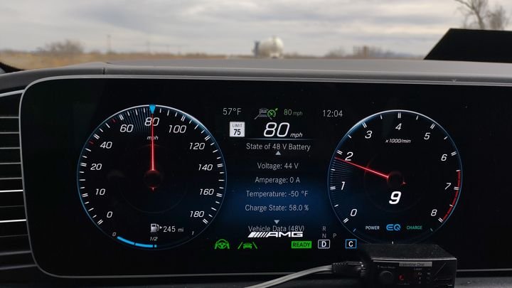

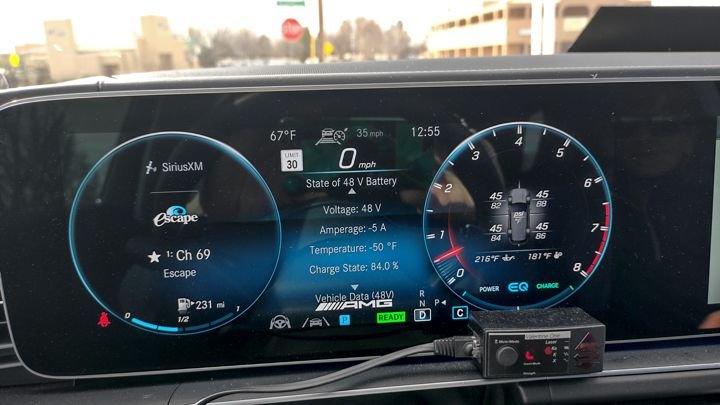

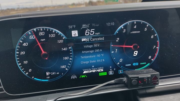

Various Workshop Displays
Here are three photos of my Workshop Display:
1) Cruising at 80mph with a steady 58% charge and zero amps
2) Braking from 80mph with 285 Amps charging
3) Stopped with 84% charge and a slight discharge of 5 Amps
