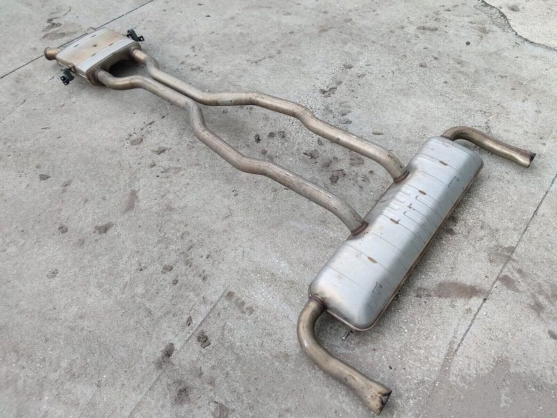

Pops and Burbles only come in Sport+ mode.
W166 GLE63 Non Performance Exhaust:
W166 GLE63 Performance Exhaust:
oh wow I didn't realize the differences. I just checked mine and I have the performance exhaust! So I guess I don't have resonators then?
