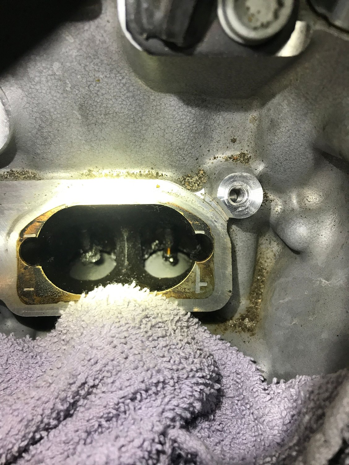

Meanwhile I was able to get the intake manifold removed and got a few photos.
Bought the entire kit but really just needed to replace the rubber gaskets/seals.  Could have saved some $$$.
These gaskets look okay but replacing just the same- I noticed a bit of oil in the intake manifold but nothing too significant.
Intake Manifold Removed and to the side..
with intake manifold removed
I honestly was hoping to see worse but this is one of the cleaner sides/ports.

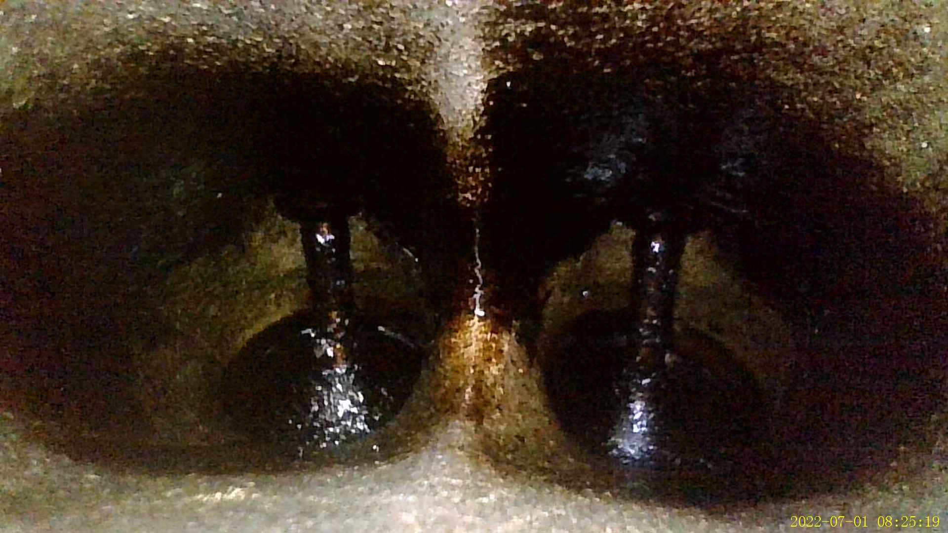

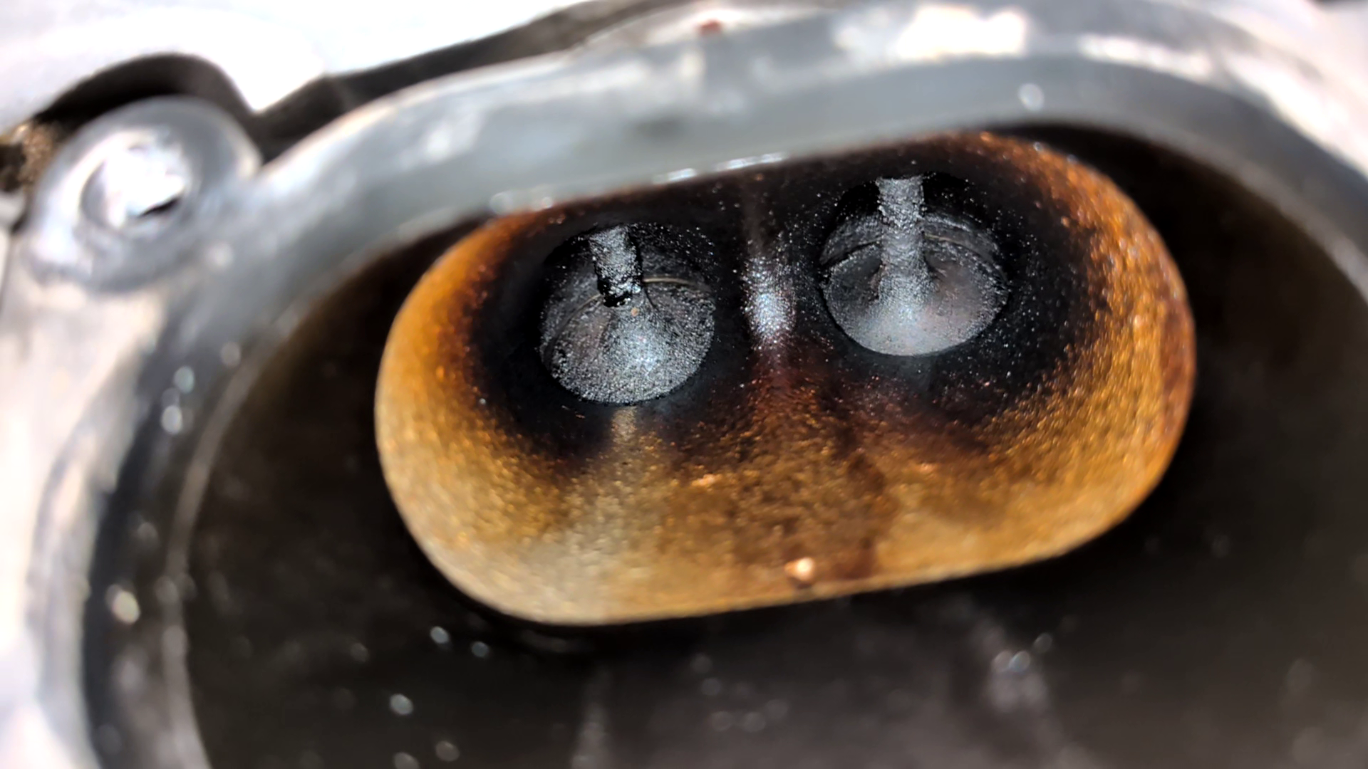

Having been through a carbon clean with my previous Audi RS5 at around 60k miles, your valves don't look bad at all at 143k miles. I wouldn't have too high hopes of seeing a lot of performance improvements. I definitely noticed it in the RS5, but this is how the valves looked after 60k. The shop I brought it to used the solvent and scraping out the buildup approach. Walnut blasting is messy.

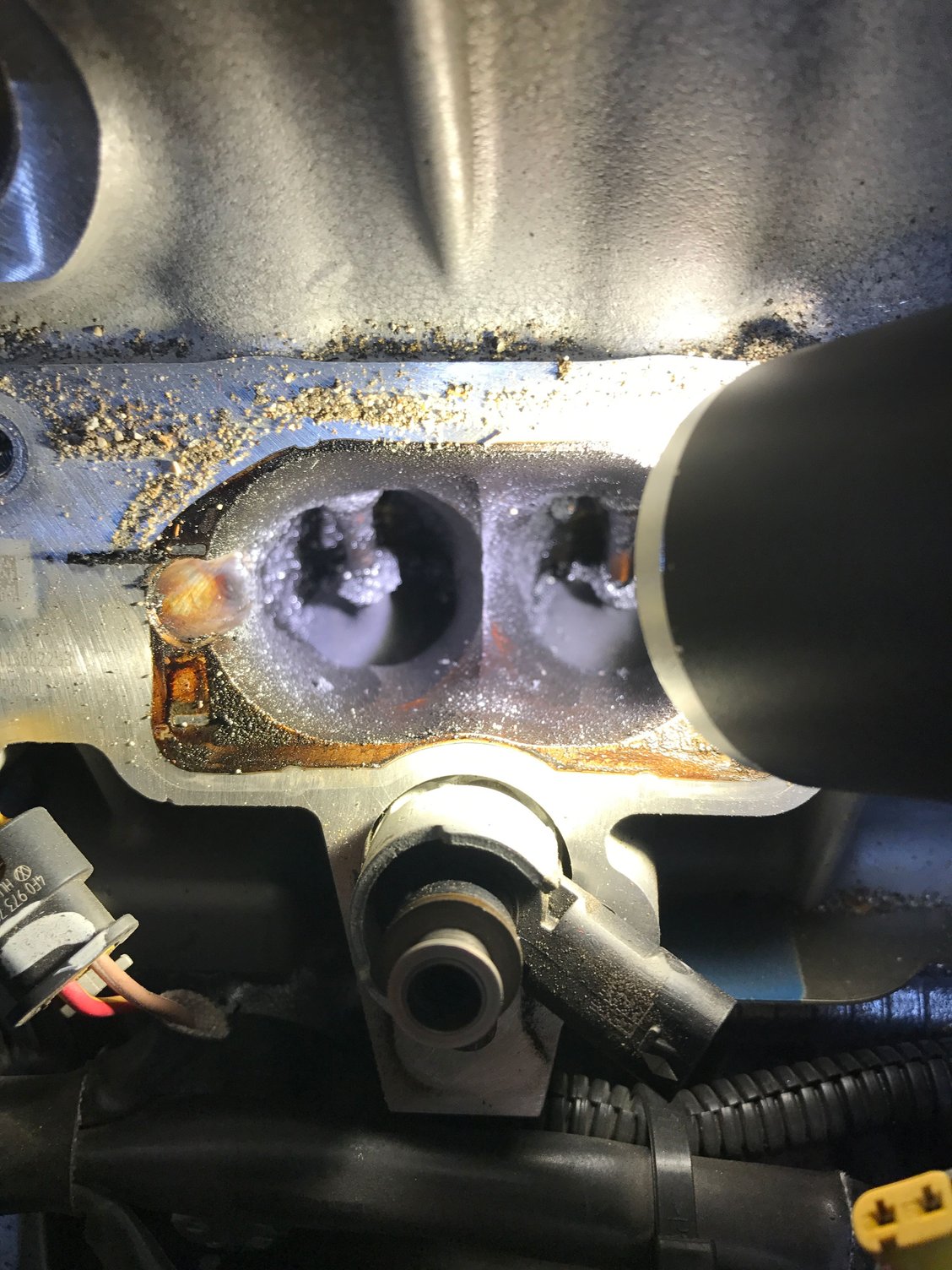

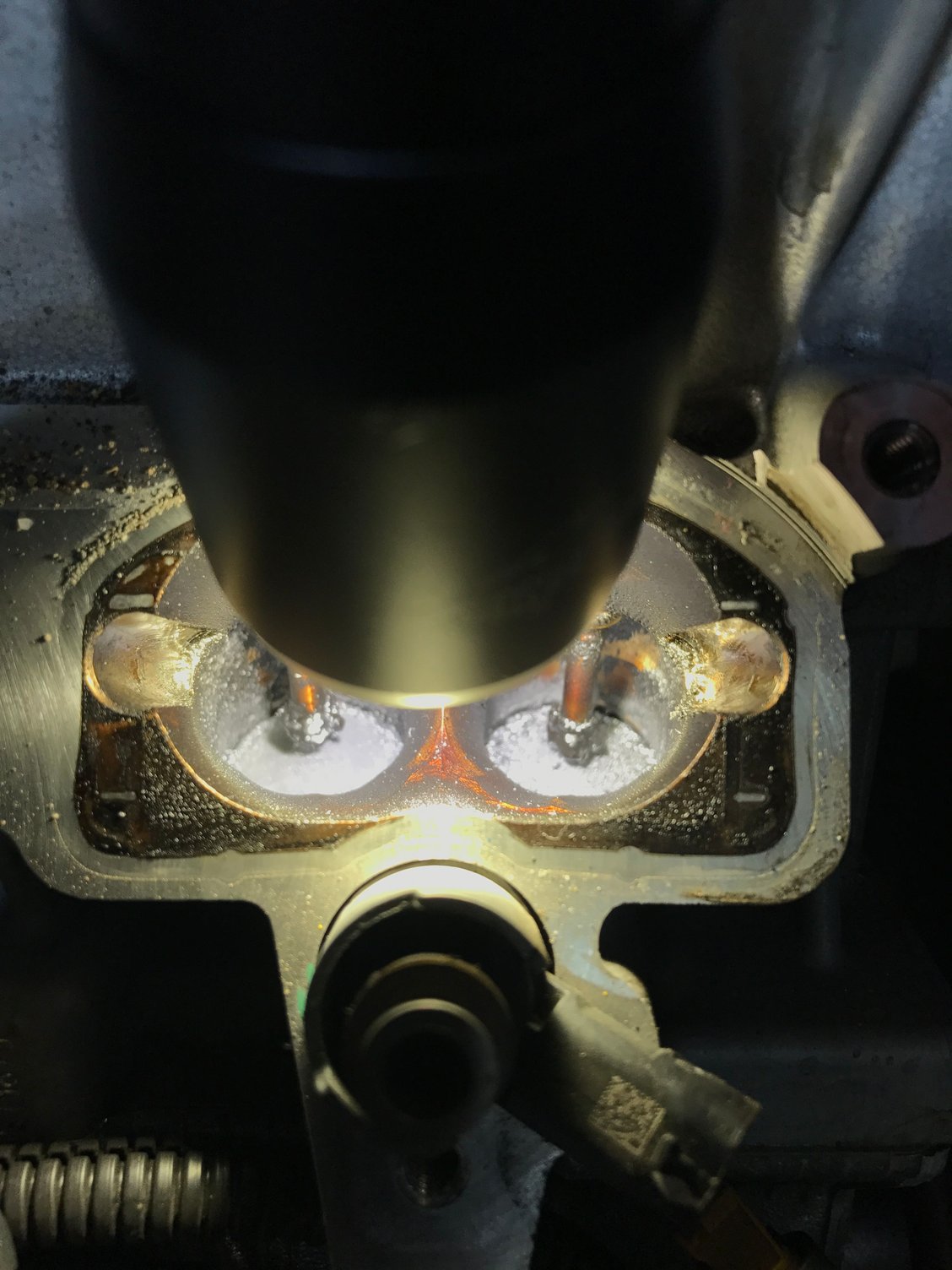

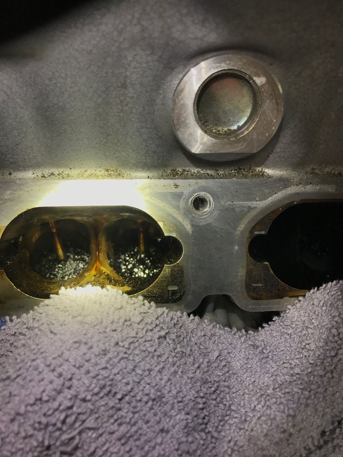

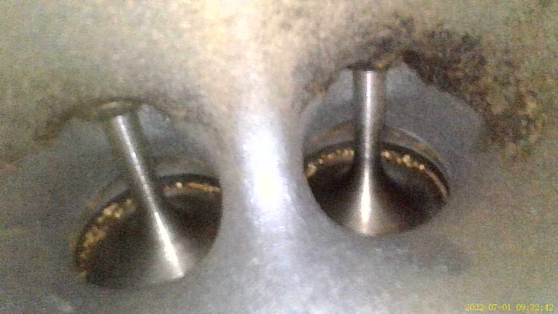

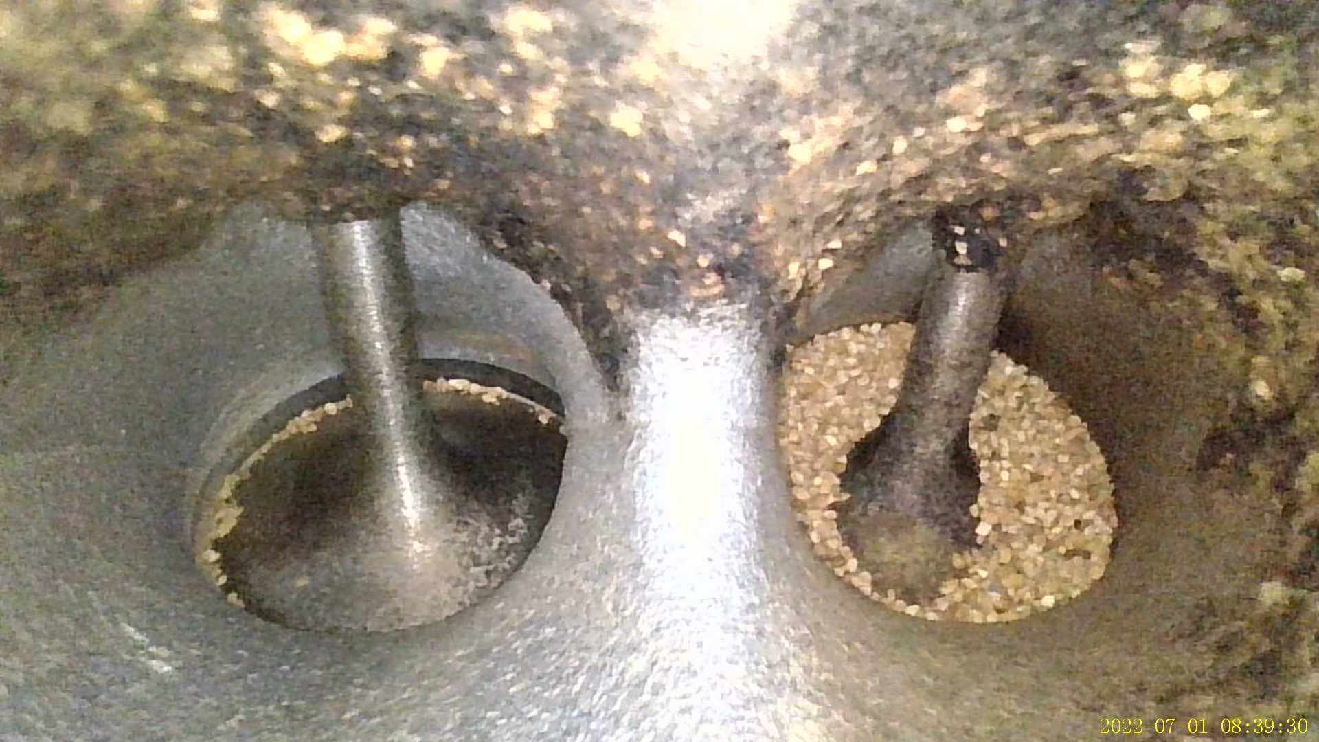

Well some quick progress to note - but not finished yet!
The walnut blaster apparatus is basically a shop vacuum cleaner with an attachment for the high pressure air line - so it vacuums the walnut shells while it blasts them - recycling them around and around. Not bad, but my pancake compressor can't really keep up well so it's taking more time than it should! Nice thing is - it isn't messy in this case. I thought I was going to need to 3D print an attachment... and honestly I kinda hoped I did as any excuse to use my 3d printers in function is welcomed. Alas - the machine comes with an array of silicone attachments that fit snugly within the port - allowing the vacuum and walnut blasting simultaneously and within a closed circuit... well at least for the walnut shells. I actually could see chunks of black carbon that it had vacuumed up while blasting them free.
I finally got the breather hose loose from the plastic housing... in pieces. I used a 90 degree angled flat head screwdriver to help pry the bottom parts where it snaps in place - then used spark plug wire pullers to finagle it free. Surgery...
I have some nice photos of the valves before and after that I will post soon... I need to finish the 5 ports that are available.. then turn the engine for the last... while the car is in neutral (but its in park and battery is detached... so that's something I will shortly figure out)....
I ensured the front covers were in place before I started shooting walnut shells everywhere.
TBH - the machine works great imo. There were maybe 5 little bits of walnut shells that got out... the rest just gets sucked up... cycled around... There is some dust that remains and needs to be wiped out and blasted with pressurized air alone. The machine has a valve so you can dial the walnut shells on or off and a varying level.
I did spray them down with intake cleaner anyway. I'm also going to dial up the psi to 90-100... at 60-80 it has been okay but I think it needs more.

Used a plastic razor to clean the old gasket material.
Installed.  The procedure for the gasket maker is to hand tighten the screws - wait an hour - then come back and tighten to spec.  Which in this case is not a lot - okay I can look it up but I hand tightened them gently.  As they are magnesium covers I believe.   Tighten like you would a tire - always tightening bit by bit and going over and across...  not all at once on any one bolt.
I call this - winning.  I got it off but it wasn't pretty.

So I will share a few more photos from the final clean here soon but this is on its way!
needle nose pliers are also a hose guide/holder
needle nose pliers are also a hose guide/holder while an old lamp holder is keeping the vacuum line tidy
I couldn't reach certain bits and started thinking ... what can brush in hard to reach spaces... TOOTHBRUSH!  but it was still too wide so I cut it in half.  BUT - it wasn't strong enough to get some carbon baked on near the top of the valves.. so I thought  ... what would a dental hygienist do?  And I found my dental pick from Ace Hardware and was able to get the last little bit of carbon buildup that sits near the top of the valves.  I did this while using the camera and screen to aim perfect.
I couldn't reach certain bits and started thinking ... what can brush in hard to reach spaces... TOOTHBRUSH! but it was still too wide so I cut it in half. BUT - it wasn't strong enough to get some carbon baked on near the top of the valves.. so I thought ... what would a dental hygienist do? And I found my dental pick from Ace Hardware and was able to get the last little bit of carbon buildup that sits near the top of the valves. I did this while using the camera and screen to aim perfect. I kept thinking about a dental cleaning.
used a shop rag to wipe up until here after spraying with intake cleaner - and soaking up what I could with a paper towel.....
first blast of walnut shells... barely starts to clean the left valve.... leaving shells embedded in the oil.
another 30 seconds  later - this is the last port on the right and not as easy to access. getting closer.
much better but not complete.
much better but not complete. Meanwhile the camera date/time is fixed/removed moving forward.

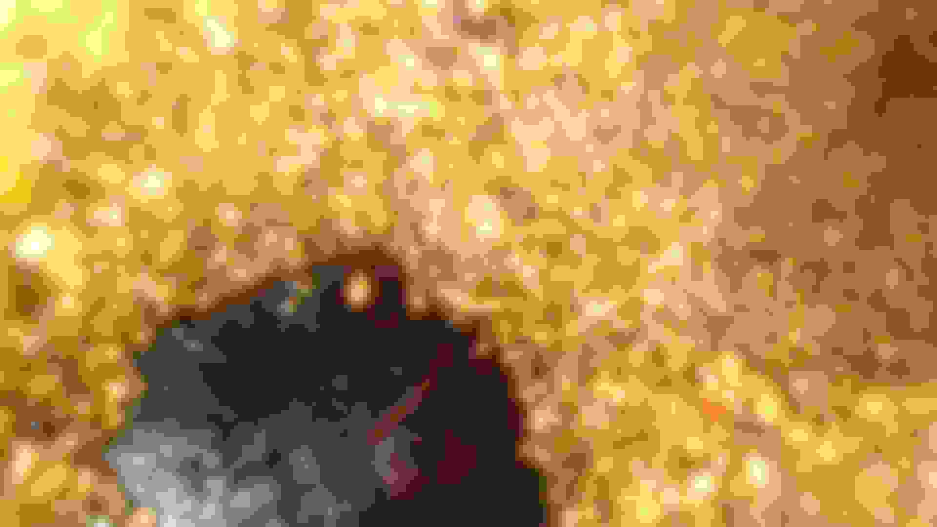

Two steps forward ... and one giant leap back...
aww nuts.
aww nuts - the intake valves on this port were just barely open - despite appearing closed - I knew better but thought I was getting lucky. Now I have a piston full of nuts... I bought a small tube and vacuum hose accessories... the nuts were too oily and sticky and wouldn't budge with the vacuum alone... and now I am pouring fuel into the intake port while vacuuming it out the spark plug hole... basically just port injection at this point right? I put a bunch of walnut shells in the vacuum first so it soaks up the fuel. Then quickly emptied the vacuum and got away from the fumes..
<img src=" class="post_inline_image" data-size="1920x1080" data-src="https://cimg5.ibsrv.net/gimg/www.mbworld.org-vbulletin/1920x1080/img_175_f64656df9cda3618455fa2008804e77bb0fa0b0f.jpg" loading="lazy" />

Now that you've added extra texture to the head and valve stems how long before massive carbon buildup do ya think ?
Old Jun 13, 2025 | 08:12 PM
MrStoner's Avatar
Joined: Apr 2024
Posts: 39
Likes: 13
From: Austin, TX
2009 ML63 AMG (W164) and 2017 GLE43 AMG (W166)
Oh it's mostly out of there at this point. I left my sd card in the computer so no good photos yet but I was able to vacuum while blasting air and knock loose most all the walnut shells. I read a reddit post where someone did the same and they were told it's nothing to worry about but to change the oil as likely some shells made it around but otherwise..."send it". The shells should burn off and soft enough not to scratch the metal. Meanwhile lifted the car and unscrewed three bolts to loosen the air cooler so that I could access the 27mm bolt on the crankshaft pulley . The cylinder looks good. One more to go after turning the engine just a bit more. Already did a bit to further open the intake valves to vacuum the rest of those shells out of the last cylinder on the right.
