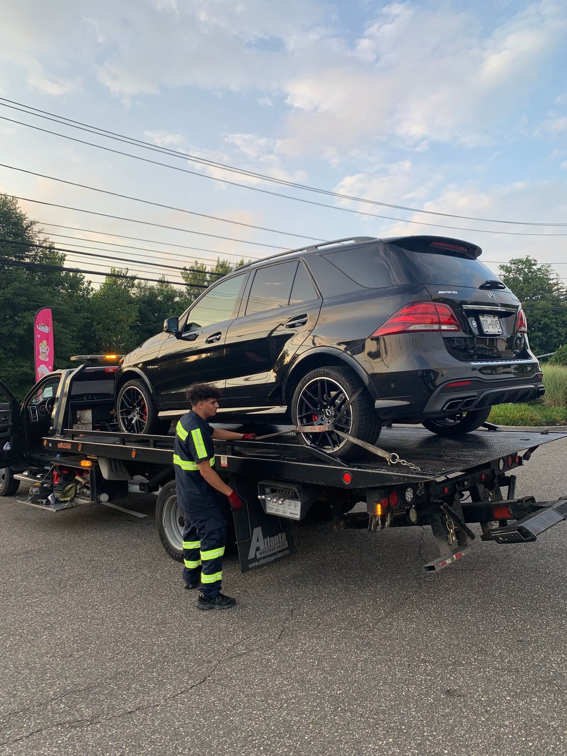

Is use of wheel spokes for vehicle tie-down now SOP, or was this driver just stupid/lazy?

The spokes are not used for vehicle tie-down. The strap goes goes all the way around the outside of the wheel/tire and then the strap is ratcheted snug independently on all four corners.

That tow truck driver used the proper straps. He's not going through the spokes. Looks like he's using a carrier tiedown, though very sloppily installed over the tire. This is how those should look if installed properly.
