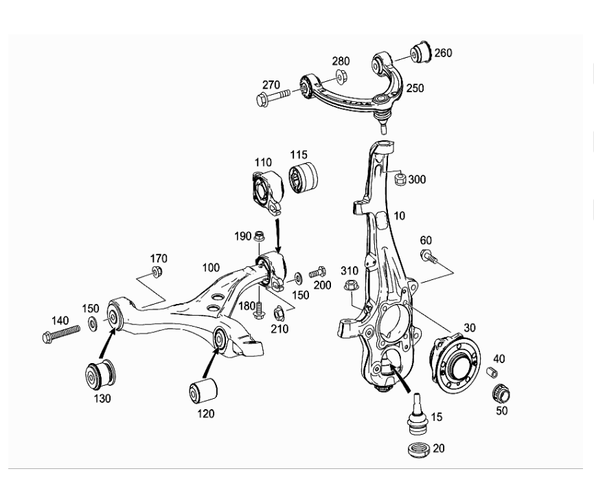

Im not familiar with the W166 though looking at the diagrams the bearing/hub assembly look very similar to a W204 rear assembly. just the 4 bolts and the bearing comes off with the hub. I worked on mine and it was stuck on pretty good. I had the entire wheel carrier on a bench out of the car and gave it a few wacks.
I came across the instructions for the 4 matic and even that just shows pulling out the cv axle to be able to unscrew the 4 bolts, then says to remove. No additional steps.

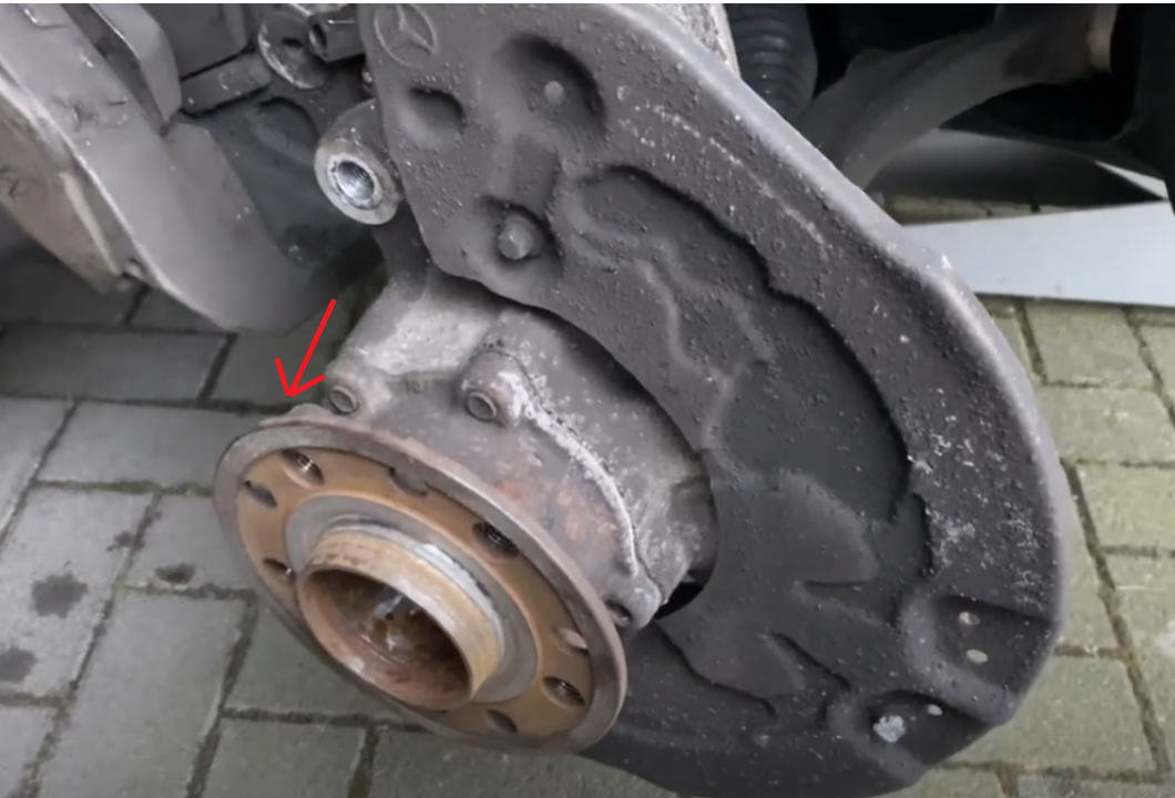

Are you hitting the hub out/off? I'd be hammering it off where the brake caliper brackets were since theres no dust shield in the way there.
I found a video with a hub like yours. Seems he just unbolts it, doesnt show actually getting it off but theres no mention of special procedures. I think its just stuck on really good, just like how sometimes its difficult to get the wheel off its rusted to the hub.
