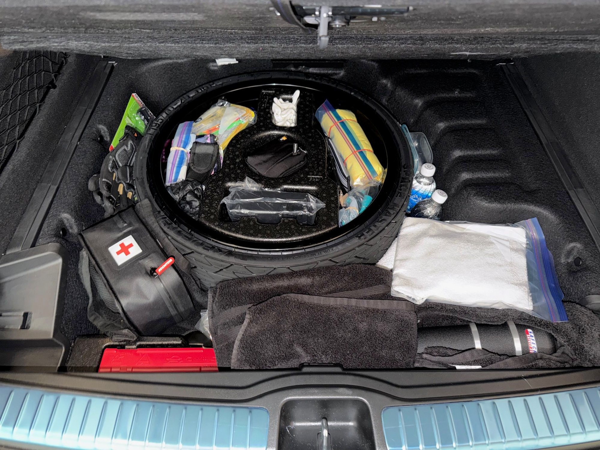

Yes, I use the pressures on the gas door. I have the Continental Cross Contact LX sport tires that came with the car. I have a lot of things in the back and removed everything even the styrofoam with the factory tools/spare. All gone. No difference. I guess the best way to describe it now after driving it some more is on a lightly rippled surface. It feels bouncy and a little clunky like it clomps over the ripples and man hole cover dips.

I had the shop foreman who I've known for ten years go out on a drive with me. I drove and he looked over and noticed I had a "check engine" light on. Didn't see that on the way over to the dealer. He said the CEL was a miscommunication error between the key and ignition module and needed a software update. That was a head scratcher for me. Car was built in Feb. 2026 and it's the sixth year of production for the GLE. Why would a one month old car throw a CEL and need a software update for an ignition module? Just strange to me.
Back to the clunking noise. He heard the sounds I was talking about on the drive we did. It's definitely on the right side. To me it sounds like the rear but he thinks it's coming from the front and said it could be where we're sitting but it's on the right side. Should have some news tomorrow so I will update. So I left the car there and got a loaner. Not too thrilled about this right now. My 2022 GLE 63 had several issues and my 2023 C63 was a lemon buyback and now this. Really no excuse or it's just bad luck on my part. If something happens again sooner rather than later I'm saying good bye to the car.
