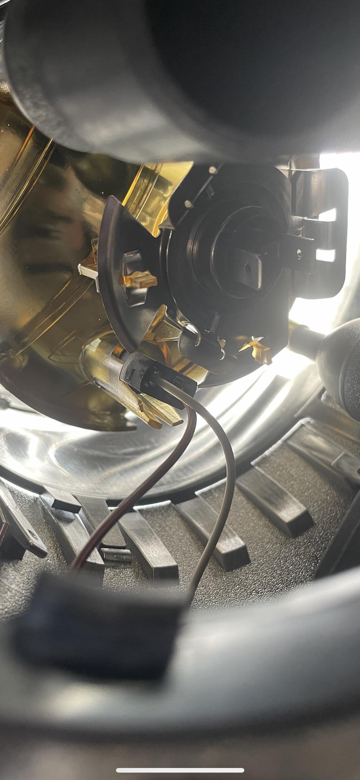

There's some excellent advice in this thread. What a terrible design by Mercedes - how could they make it this difficult? I'm thinking about switching over to white bulbs, but playing around outside with it makes me want to forget the idea altogether. Anyways, I thought I'd contribute by posting the dreaded three prong parking light.
